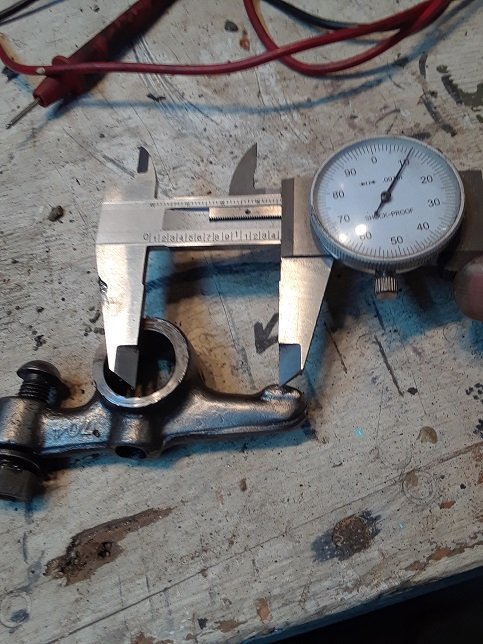

here are a few pictures of questioned head, as you can see the valve cover says Frontenac, which fits the head perfect, the exhaust manifold says Roof 8, and fits the head perfect, but the head is supposedly a Rajo, so what is the correct item manufacture. I really need a rocker arm for this engine and am having a bit of a issue determining what it really is.

Your overhead is not a Rajo. I believe it is a two port 8 valve Roof head , but I don’t know what model name Roof used for it. The valve rockers you show may or may not be Roof rockers, but if they are Roof it will be very hard to find replacements. You may have to replace all 8 rockers and make new rocker stands. I looks like it is a nice running head.

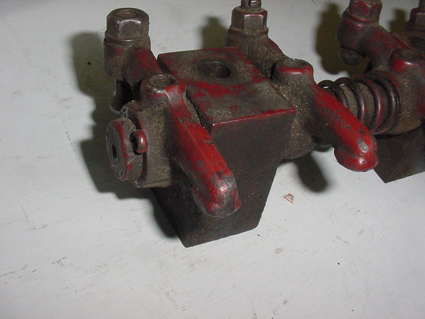

Yes, definitely a Roof head with a Fronty cover. Good running head with a little added compression. Unfortunately as Kevin mentions above the port / chamber roof design is not very robust and really the only way to salvage a head with bad seats is welding.
Here is a picture of the correct rocker arm cover and the Roof rocker assembly.

Is that a 1:1 rocker ratio Dan?

good to find out what this thing really is. as for the rocker arms they seem to be not 1:1 but, maybe these are not the right ones.

1.2 isn’t much rocker arm ratio. Makes choosing a cam easier, you don’t have to account for much extra at the valve.
