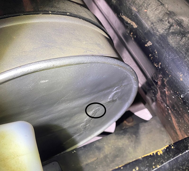

If it's not one thing it's another..... the reality of Model T ownership :D Today I was crawling under my Model T to string some electrical wire. I noticed a slight smell of gasoline and when I got up by the fuel tank, I noticed a tiny drip on the lower left side of the tank. There was no puddle on the floor... just a really slow seep.
The end of the tank had been brazed at some point in the past and the seeping is occurring in a section of the old crack near the center of the tank. I originally cleaned the tank and coated the interior with a POR15 kit so I'm surprised anything can get thru. I used a siphon (gas came out clean) to lower the gas level below the crack and I plan to try to repair it with some JBWeld "Tank Weld". Hopefully it does the job.

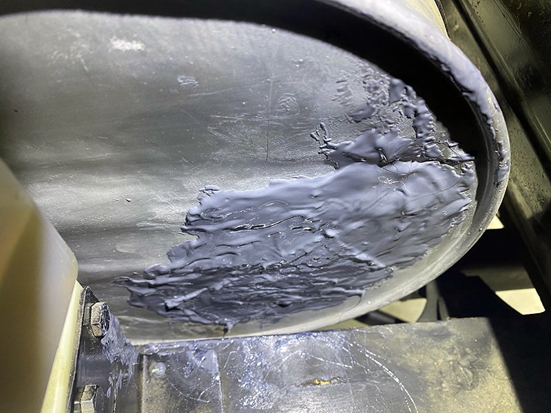

Attached are two photos. The first shows the long crack in the left end of the tank, with a circle around the area that is seeping. The second shows the sloppy results of my attempt to repair it with "Tank Weld". After roughing up the area along the crack with sandpaper, I cleaned it of any grease or oil. I then smeared on a layer of resin, lay a piece of fiberglass cloth along the crack and then coated the fiberglass with the remaining resin. The leaking area is covered as well as the repaired crack, both above and below. I didn't do a pretty job but I'm hoping it will stop the leak, at least for now. I'll be watching it and if need be can deal with it more properly later on.
Thanks for all your comments and advice....wish me luck!
