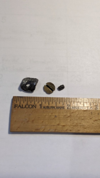

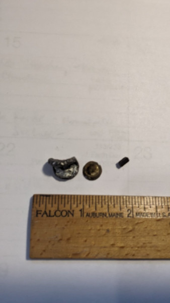

Found washer in bendix.
Found the screw head in the oil drain plug.
Anyone know where they might have come from?
Engine still runs.

YIKES. That screw is what holds the magnet keeper plate. That means an engine/flywheel pull.
Dont run it until fixed.
If you have a starter, you can remove it(bendix first) & rotate the flywheel to view the magnet/keepers/screws & confirm.
Wont be easy to see behind the field coil. Use a dental mirror. Either way a loose magnet keeper will tear hell out a field coil & can jam up & break magnets. This is very serious.
Maybe you get lucky & its errant parts not found during the last rebuild????
