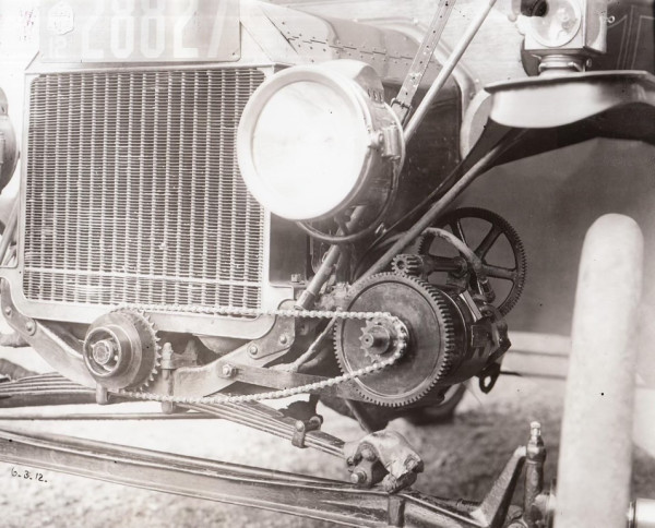

What is this?
Anyone know what this is? Looks like to hoses attached, I doubt for an air conditioner, but people have done stranger things!

So what are the two things that look like hoses for?

Not hoses, wires for the electricity, it's an early accessory electric starter motor.

Photo date marked is '6.3.12" down by the axle to the left so yes, a very early starter I would think.

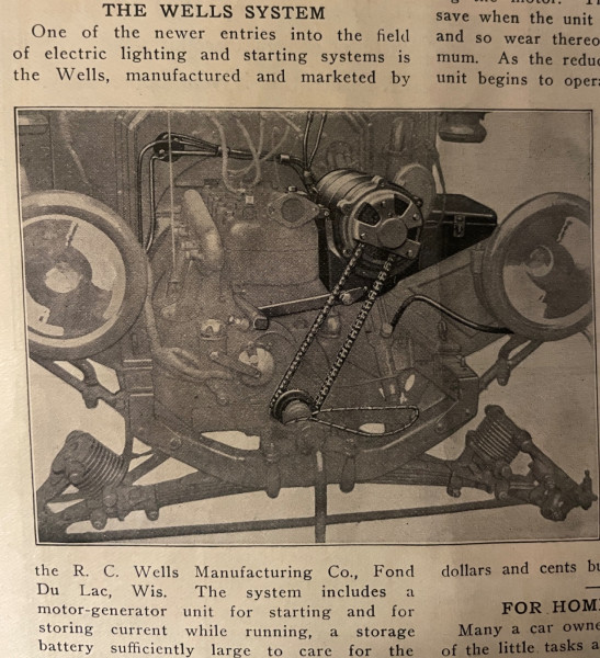

Yes, many early electric starters were being made for the Ford, that one is external and more developed in early teen years to be placed under the hood for better protection and look.A Whiteman wrote: ↑Mon Apr 15, 2024 7:06 amPhoto date marked is '6.3.12" down by the axle to the left so yes, a very early starter I would think.
Here are a few of these in electric, using the newest of storage batteries carried on board.

Have a look in the Gallery section here for a few more starters: app.php/gallery/album/75/page/27?sk=n&sd=a and the next pages.

Re: What is this?
I think it’s a combo starter generator

Re: What is this?
Yes, and with the gas lights, it would not have been an electric-equipped car. It probably IS a starter-generator unit. I wonder where they mounted the battery?

Re: What is this?
I believe I'm seeing a reflector in the headlamp, suggesting that they've been converted to electric.

Re: What is this?
Bud Delong (RIP) would call that a Self-Commencer!
