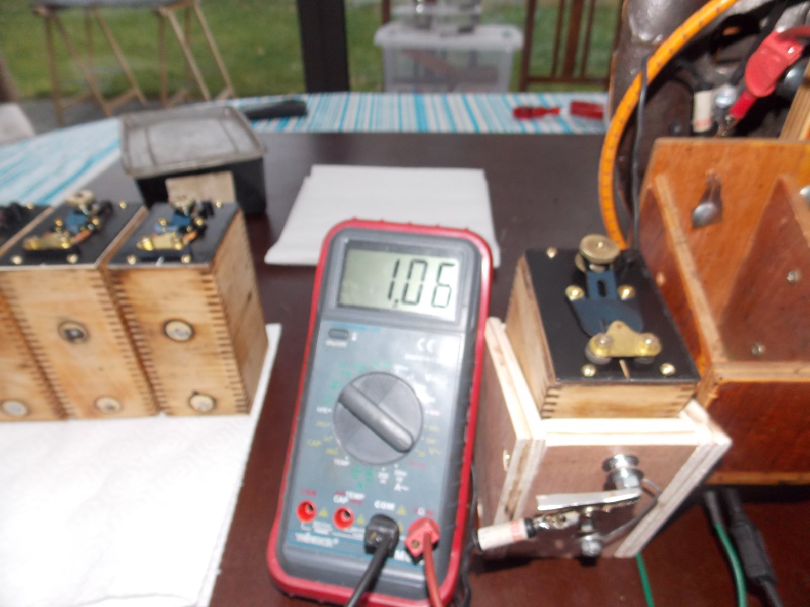

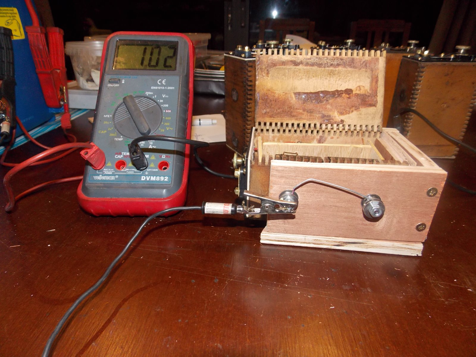

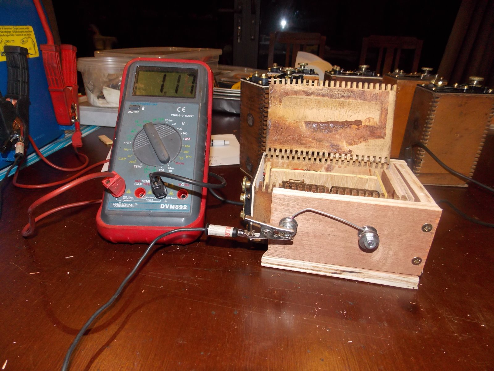

cranking by hand on magneto It will give you between 2 and 3VAC.
The coils are not made for tension but for current.
While testing coils on an HCCT sometimes the coil start to buss and spark at 1.5VAC and there is a gap of about 1/4 inch where the spark is seen.
Photos in the attachment are from a Heinze coil while testing with a HCCT.
Andre
