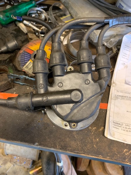

Hi there I’m in Australia and have this distributor and I think macs and the model t ranch sell these but does anyone no what type of points these run mine are no good
Cheers
Cam [image][/image]
Distributor
Autie

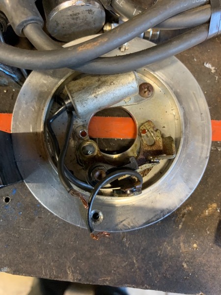

Distributor cap is from a 1988 Honda Civic. Cap part #JH95 and rotor part #JR72. The points are part #JP13P. Set points .020 - .025. Did the distributor come off your T, or are you going to install it?

Looks like a Model T Ranch product.

Your right, George. It is a Model T Ranch product. There phone # use to be 817-613-9233. Don't know if it still is. I've ran this set up for years and never had a problem with it.
