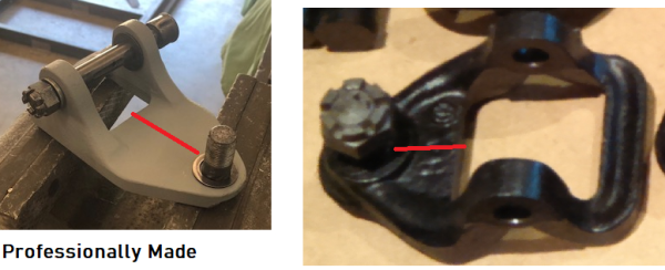

The issue with almost all aftermarket rear shocks have with accessory brakes (AC, RM etc) is that their perch doesn't clear the additional thickness of the drum. Snubbers are a possibility as are friction shocks OR have a rear perch made to clear.
I was fortunate to have some made for Hassler shocks as my project unfolded I wasn't sure if I was going to use them. Someone was looking for them and the "professional" maker wasn't ready to make another set, so I sold mine :evil: but the idea should work for others

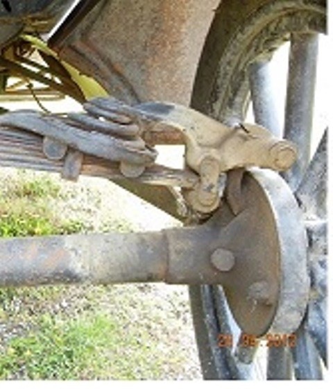

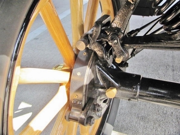

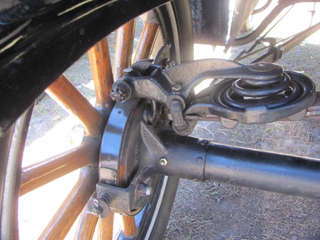

Have seen Hassler Pan Cake rear shocks clear a set of small drum outside brake, as there is some space above the brake drum.
Would think AC brakes over the factory small drums would be ok with Hassler Shocks.
hass size.jpg (97.84 KiB) Viewed 1648 times
Regular Hassler 'Bee Hive"
IMG_0088 (600x450) (595x446) (2).jpg (142.48 KiB) Viewed 1648 times
1924 and later 'Pan Cake' Hassler

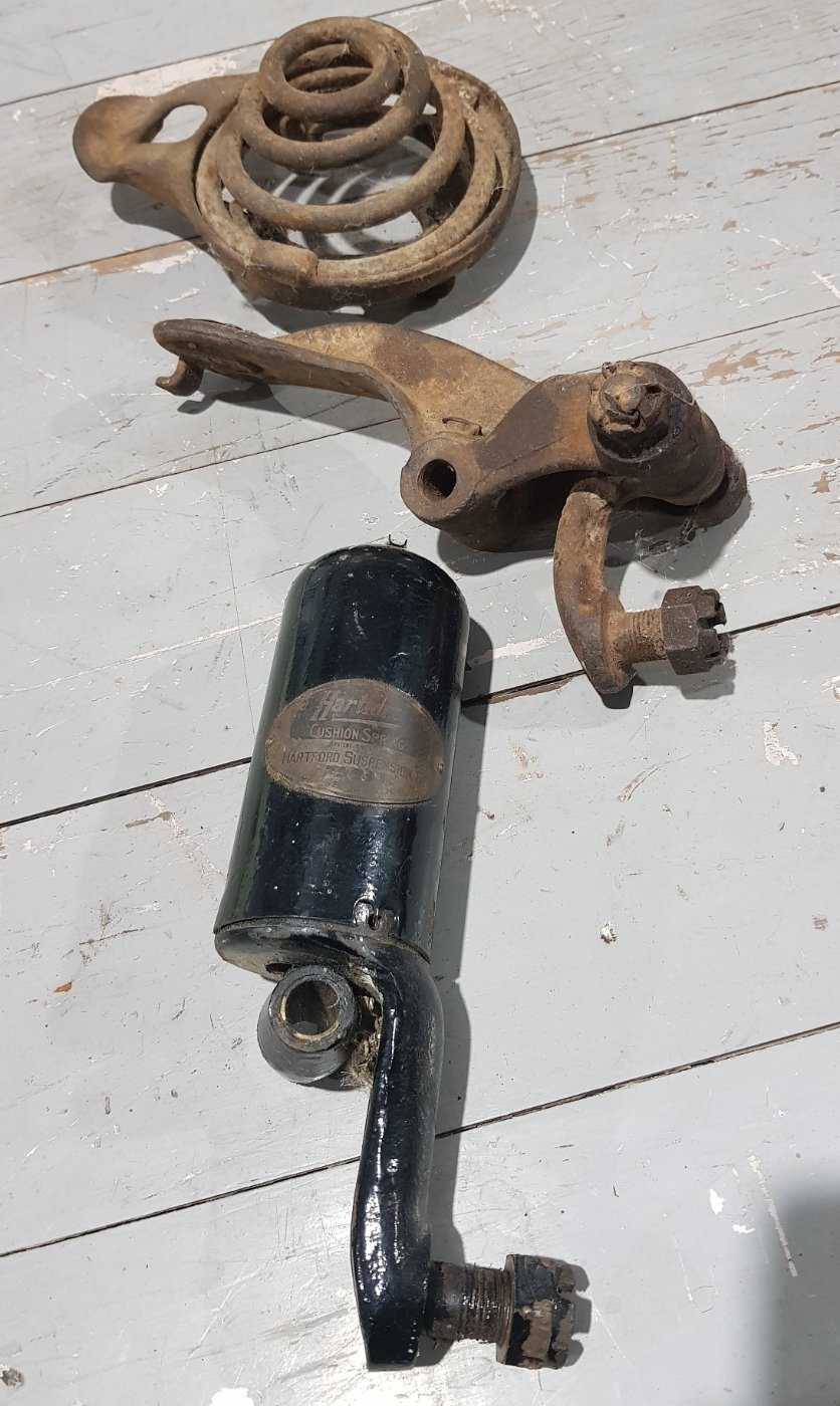

I don't know much about them, but was given these Hartford branded units, and assume they fit a T?
What I thought looked promising was that they don't sit over top of the drum like the Hasslers do in the top of the picture (or as per Dan's pictures) which I always thought would interfere with the AC bands.
