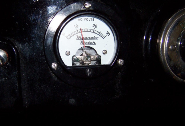

That depends on the type of voltmeter you have. If it's the 'Magneto Meter' by Funprojects that was sold by Lang's and other vendors, it will indeed measure and display the AC voltage output from the Ford Magneto. Lang's still lists it but it's unavailable, https://www.modeltford.com/item/A-MAGM.aspx
( Funprojects also offered a DC voltmeter that fit in the Ammeter panel on the dash, that meter was often installed by those whose cars were equipped with alternators to monitor battery voltage. Those were sold by Lang's with part numbers 5016-6v or 5016-12v for 6v and 12v, respectively. The meter scales were 5.5-7.5 Vdc and 11-15 Vdc for the respective meters)
From the descriptions of the meters you should be able to determine what is being measured on your model T. Best, jb
It is equipped with the Magneto Meter and says that it is to measure AC volts. As indicated it shows 0 volts at all rpm.
That would be either the wire from the Magneto Meter to the mag output on the hogshead isn't connected, or the other lead from the meter isn't on a ground. Or, perhaps the magneto contact is caked with oil/lining/metallic debris and is grounding out the magneto output. Cleaning the contact by removing the magneto post would check that. Finally, the magneto could be dead.
With 12v starter added, your T should have a 12v DC storage battery, perhaps the owner used the AC magneto with an adaptor device, to put 12v DC back to the storage battery, but that juice would be very light amps anyway, about like a trickle charger.

I have a magneto meter the same as Dan above posted with a picture. The Magneto Meter and my Fluke agree on the voltages at both idle , 6 1/2v and at higher RPM, 10 v. The voltage does not exceed 10v.

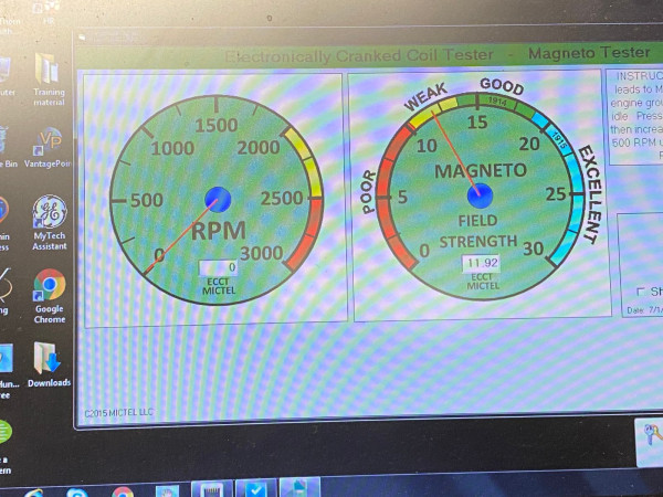

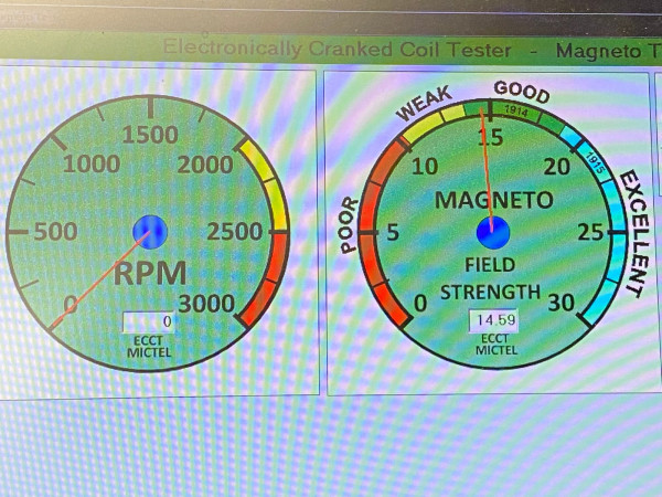

Well, in accordance with the recommended directions provided in the referenced post I attempted an in car magneto refresh with unsuccessful results. I am confident that I did it in accordance with the referenced procedure using 3 12v batteries connected in series. I used stout battery cables and the no load voltage was 38 volts. I very briefly zapped it 8 times and now I have no output on the magneto meter. I did repeat my thrust measurement at .005 inches with a 1' dial mike before and after the procedure with initially the crankshaft pushed back, the wheels chocked and in high gear. Unless someone has another thought, I will run on the 12v battery for this tour season with plans to pull the engine next winter and go after the mag.

Post by 49willard » Fri May 03, 2024 6:16 pm
Mark Nunn wrote:
Fri May 03, 2024 8:20 am
There is one condition related to in-car magnetizing that I have never seen mentioned on this forum. If you use a prybar or shims behind the crank pulley to push the crankshaft forward, you remove whatever crank thrust that may be present. That minimizes the magnet-to-coil ring gap for a stronger charge.
That's my theory, anyway. Let the debunking begin.
I was told that when you charge the magnets it will pull the crankshaft forward. I pushed the crankshaft back against the thrust, put a 1 " travel dial on the end of the crank pulley and observed when I di the first momentary charge, it did pull the crankshaft forward by the same .005 " as I had previous done mechanically.
