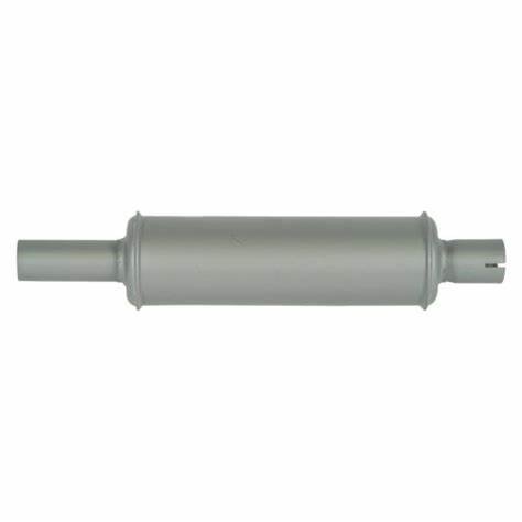

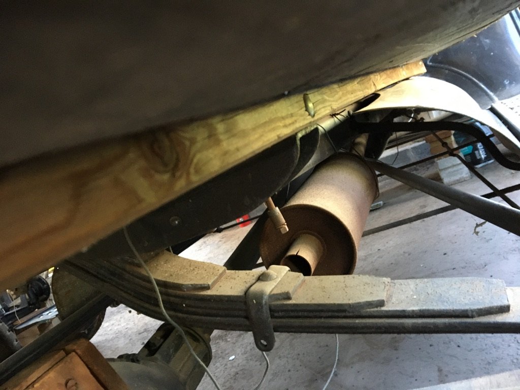

If you want to be “original” for ‘25, the suppliers sell a sheet metal muffler that attaches to the frame with one bolt. I believe the muffler picture Dave posted above is a TSC product. I recommend them and have used them.

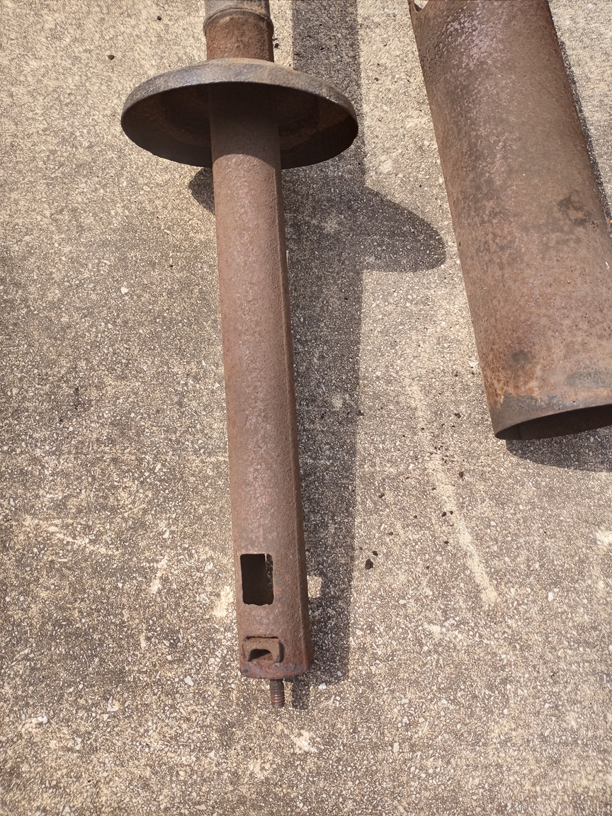

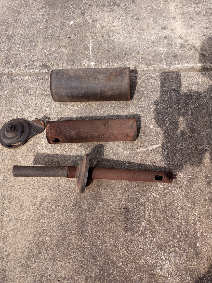

The late Vern Campbell of Michigan, once made an exhaust pipe out of stainless steel that many acclaimed to be the best fitting T pipe ever made, however it was made for T's that did not use the late style muffler with the tail pipe going all the way to the rear end of the muffler. It was made as the 'short' style pipe that stopped just after entering the front end of the muffler. A few years back, I contacted his widow and she still had a limited number of the pipes available and I bought one. I also bought (while they were still being made) one of the stainless steel mufflers that had the curved rear exhaust pipe that exited out the side of the car, so I have a complete stainless steel exhaust system from the manifold to the rear of the car. It will never rust out. Also, recently I bought an original late style T muffler that someone had cut the exhaust pipe off about 12 " before the front end of the muffler. I'll be able to use it by mating the 12" pipe 'stub' to a regular reproduction exhaust pipe. I'll take pictures of it, disassembled and post picture, later.

Here is what the original looks like. Sold this one to someone who was looking into reproducing them.
