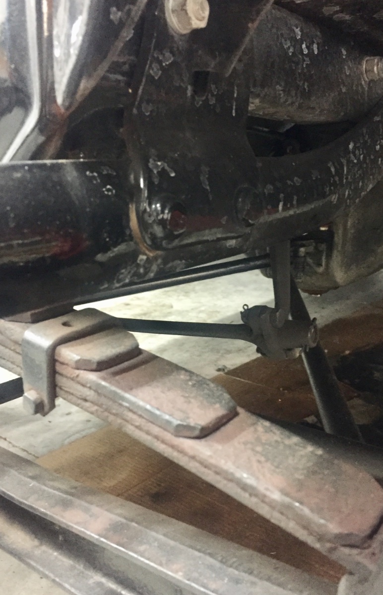

Hello all,
I have some nice Ford optional bumpers I want to install my 26 Touring but an initial fitting of the front bumper brackets showed me that my front Hasslers will interfere with the brackets. What are my options if I want to keep the Hasslers? Is it possible to have both?
Thanks,
Mike

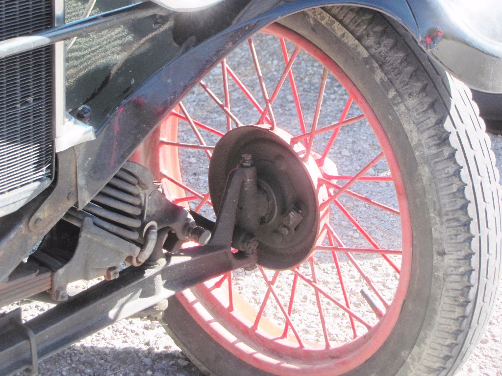

You may need the pancake style if you have the taller beehive style now. google "mtfca; pancake hasslers"
http://www.mtfca.com/discus/messages/82 ... 1522337649
Unfortunately none of the parts are the same as the beehive style. (The base maybe the same but I don't think so)

Yes, I have the taller beehive style. I was hoping to keep them and have bumpers at the same time.

You cannot use both. I tried installing pancake hasslers on my 26 coupe which has Ford bumpers on it and the arms would have hit the bumper brackets. My suggestion would be to leave the hasslers off and use the bumpers. Hasslers don't improve the ride much at all anyway.

Just not enough room for the accessory Ford brackets on the front, they hang down from the frame rail. Would interfere with the Hasslers, either beehive or pancake.
