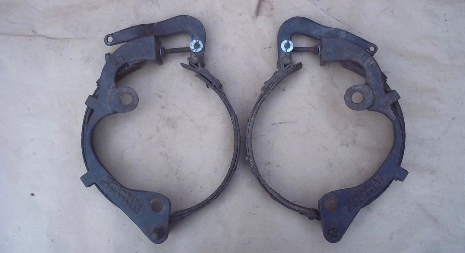

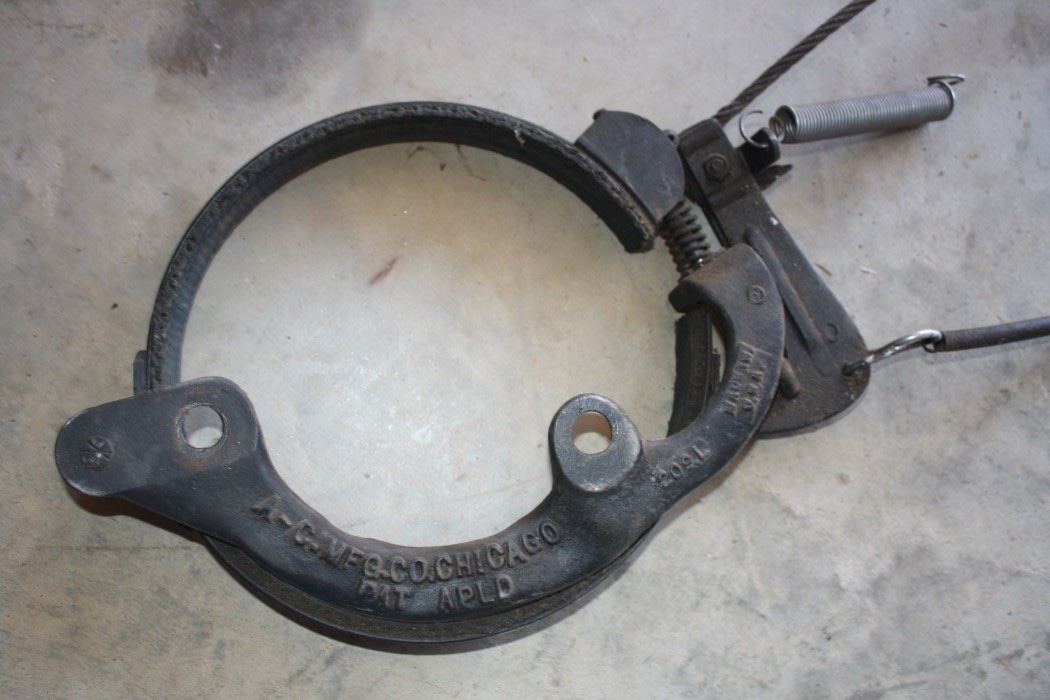

Yep. I noticed that too. Here is how they should mount.

If I remember correctly, they were made by AC under the Stronghold name for sale at Montgomery Wards. The first models were rather fragile or thin in the casting design, and then they redesigned them to be more stout and thicker. The ones on eBay are the final rendition that are heavier stronger castings. Very similar to original AC brakes.

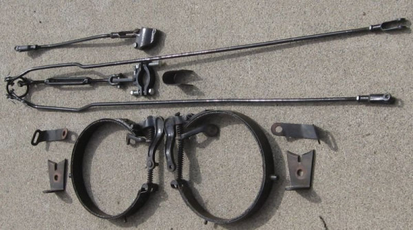

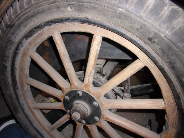

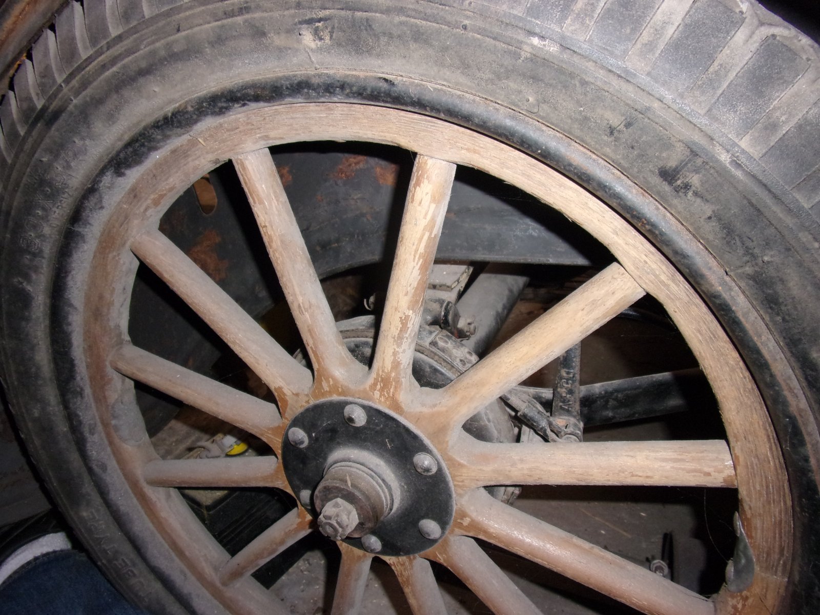

On my 20 roadster project, it has external rear brakes horseshoe type pad that runs off the parking brake handle. They are marked ADCO. Don't know if the pic shows much, but I really don't want to remove the wheel for a better pic. Just another aftermarket type of brake, I presume.
A bunch of old cars
Sometimes they run.
Sometimes, they don't.
A bunch of old cars
Sometimes they run.
- Posts: 5601
Re: Accessory Brakes
Most likely APCO - they manufactured all sorts of aftermarket T parts.

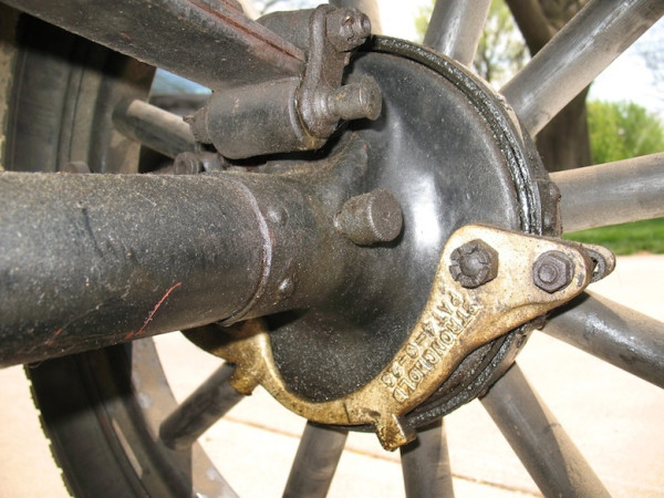

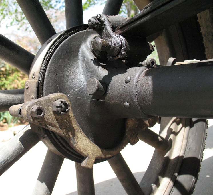

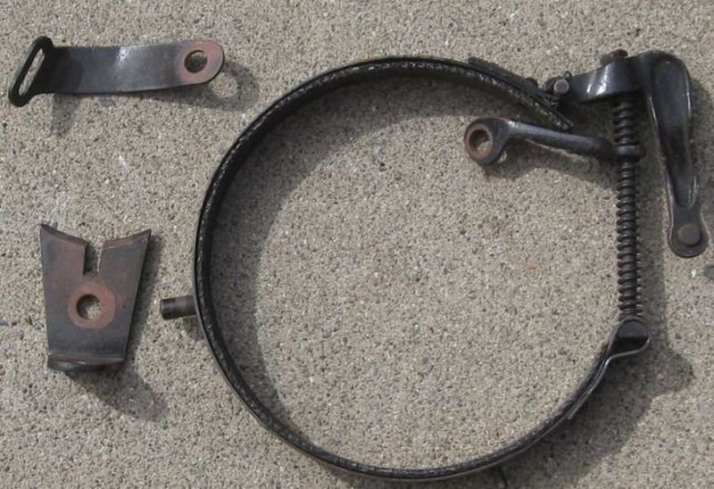

I think Steve is correct that pic has come up before
This is one style of APCO brakes, most I have seen are very similar
Craig.
