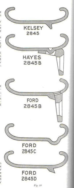

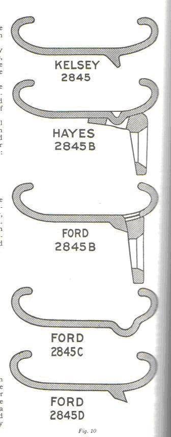

Apis, I don’t have an illustration of the variation of wheels but attached is an illustration of the rims & maker. I think, if memory serves me correctly, 3 of 5 may interchange 2 definitely do not.
