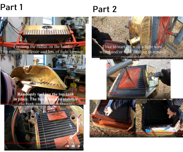

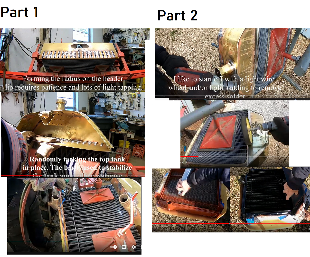

Here is the Master, retired, building a new one lets you know what skills & tools needed
part 1
https://www.youtube.com/watch?v=O4Z58zC-l1Q
part 2
https://www.youtube.com/watch?v=aehHwPlaxhU
part 1
part 2
