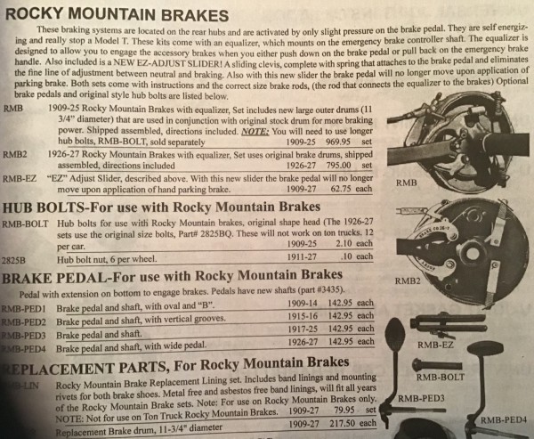

The R-M brakes are the version with the large drum added to the rear wheel, so very good surface area for stops.
For your small drum axle get the set with the large outer drum, your normal small drum is retained but sandwiched inside the new RM drum.
Obtain from suppliers like Lang’s, which may have them in stock, or direct from the mfg. at a savings, while shipping may delay from the mfg, as these are made on order and the mfg. might be slower on international shipment.
