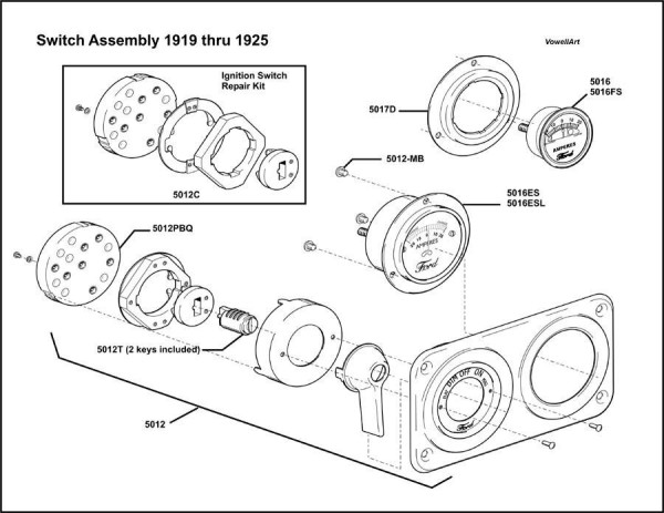

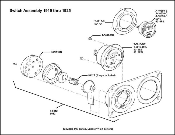

Is your wiring new or old? Does it have a main fuse? Might need to rewire with new harnesses. Since all the wiring goes through the switch, have you checked that out? Switch contacts sometimes get gummed up and lose contact. Might need to be cleaned and contacts re-established. I was not sure what kind of switch you had, so I sent drawings of all the 1922’s. Good luck. Jim Patrick
