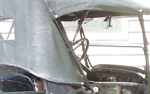

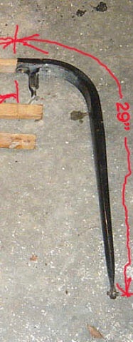

My windshield top irons are homemade, fabricated from other year top irons that I could find and made with the dimension help from this photo…

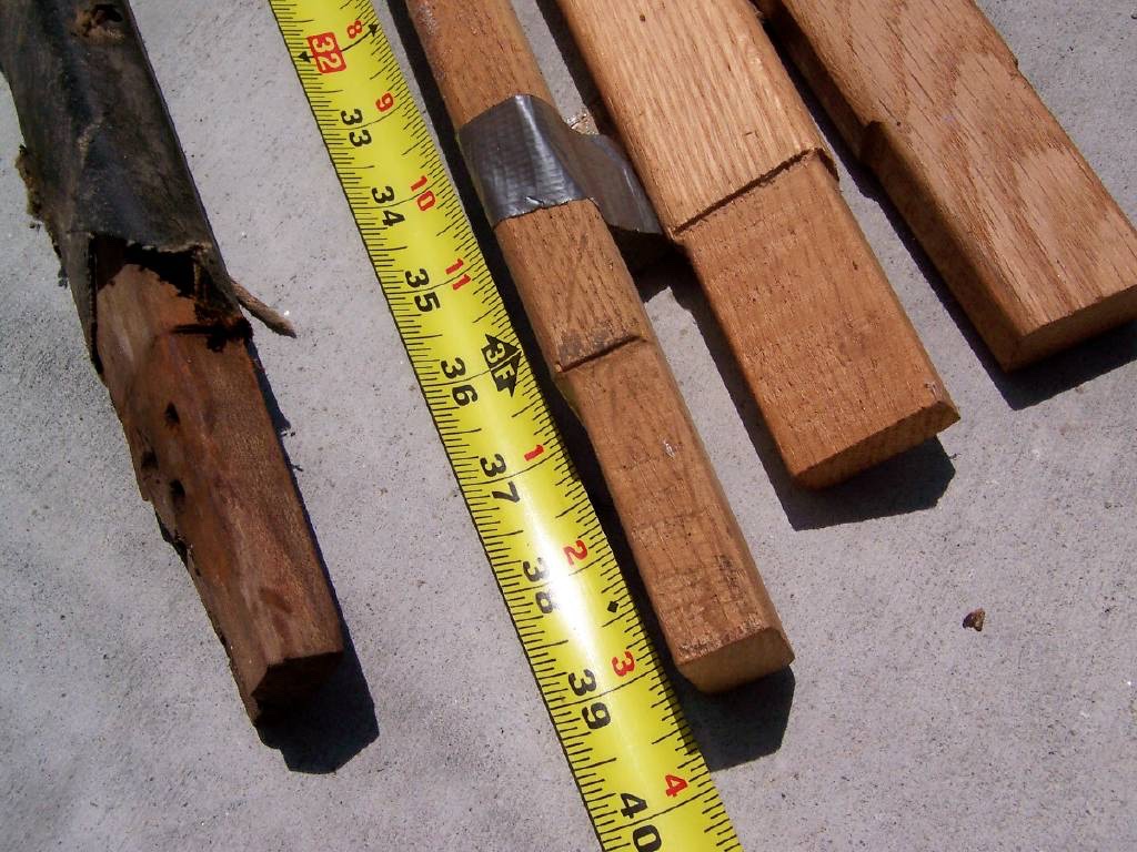

Here's the set of 3 ''26-'27 runabout new wood bows. The front bow is 36.5" long between the ends of the irons.
As your irons are home built, you may best resort to fitting the top clamps temporary to the metal iron and mount each on the windshield stanchions to really be sure of the overall length needed.
