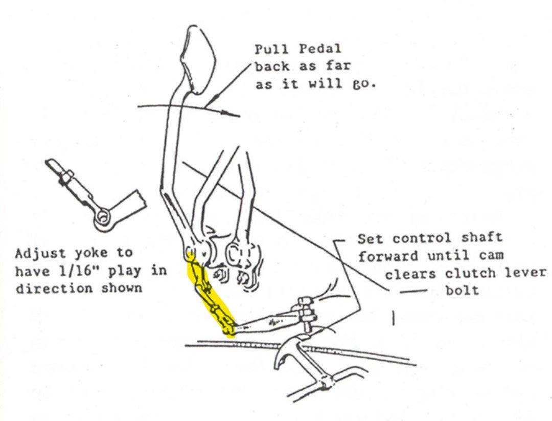

Freshly rebuilt Transmission, when the low speed pedal is depressed it sticks. The "book" says to tighten the band, when I tighten the band just enough to keep it from sticking, then the car creeps. There is 1/16" play on the clevis.
Suggestions?

- Posts: 5273
Re: Low Pedal sticks
"Fresh rebuilt transmission"
Check your linkage's via the above diagram.
So what was done to the HH & pedal shafts?
Were O rings installed - Set up too tight.
New bushed pedal shafts - set too tight.
New band return springs or are you using the old compressed one?
You should feel NO resistance in the pedal movement without the return spring in neutral.
Dave,Dave Loving wrote: ↑Wed May 08, 2024 6:52 pmFreshly rebuilt Transmission, when the low speed pedal is depressed it sticks.
I initially had this issue when I first adjusted the low speed linkage on two engines that I rebuilt. It was because the linkage at that stage was being allowed to go over center and that essentially "locked" the pedal in the low speed position. This can happen when the linkage and arm on the low speed pedal are in a straight line. The two pieces are shown in yellow on the sketch.
I was able to get the linkage properly adjusted so that it would not go over center. You may want to try a combination of adjusting the freeplay a bit more, plus the band adjustment to see if you can chase this issue out. If not you may need to make a longer link as suggested in another post.
Good luck,
Neal
