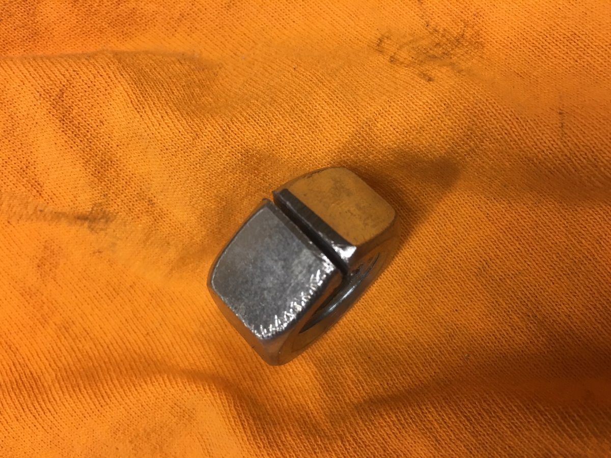

If you have an extra spindle nut you can cut a couple of thin slots about 1/4'' deep across the back of the nut. Clean any dust and debris from the nut and thread her on with a drop of oil. Works just like a die or thread chaser.

Gary has a good idea. I was wondering how to cut grooves across the thread in a hardened old bearing to make a chaser. His nut idea is much more easily achieved.

I assume that the 1910 is the same as the later Ts, if not, excuse my ignorance! It is good that the right side with the left hand threads went on well as a 3/4x16 left hand die might be hard to find. However, the thread file has always worked for me, and will work on either side. Another trick is to take a nut with the same threads and hacksaw a slot all the way through on one side of the nut, perpendicular to the threads. You can use an old bearing as well, just cut it with a die grinder. Thread this onto the spindle and it will expand over the bad threads. Once all the way on, take a vise grip and clamp it tight across the flats and unscrew it, using lots of oil You may have to go looser on the first attempt, but tighten it more each time.
