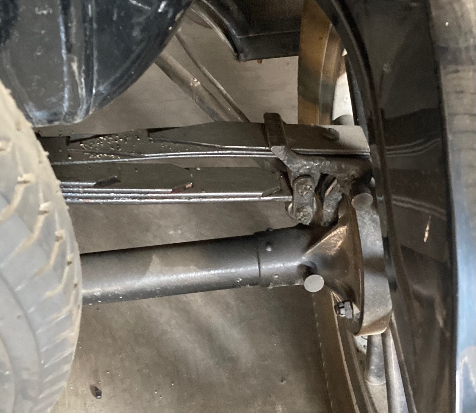

Re: Hasslers: Worth the bother?
Post by Norman Kling » Wed May 08, 2024 11:05 am
They will not work with Rocky Mountain brakes. You can put them on the front, but not on back.

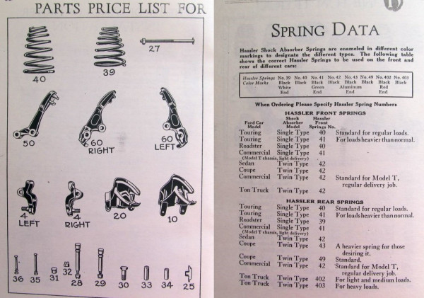

The answer to part of your question about improving handling to install them is - "Not anymore". Today's roads are much smoother then in the day. I would think that anything that would reduce steering jitters would improve handling. For some they look cool as a period accessory, others say ugly.
The second part about blast & paint is "YES". A complete set in good condition usually sell upwards of $500. Repro bolts for the shackles points are scarce & pricey

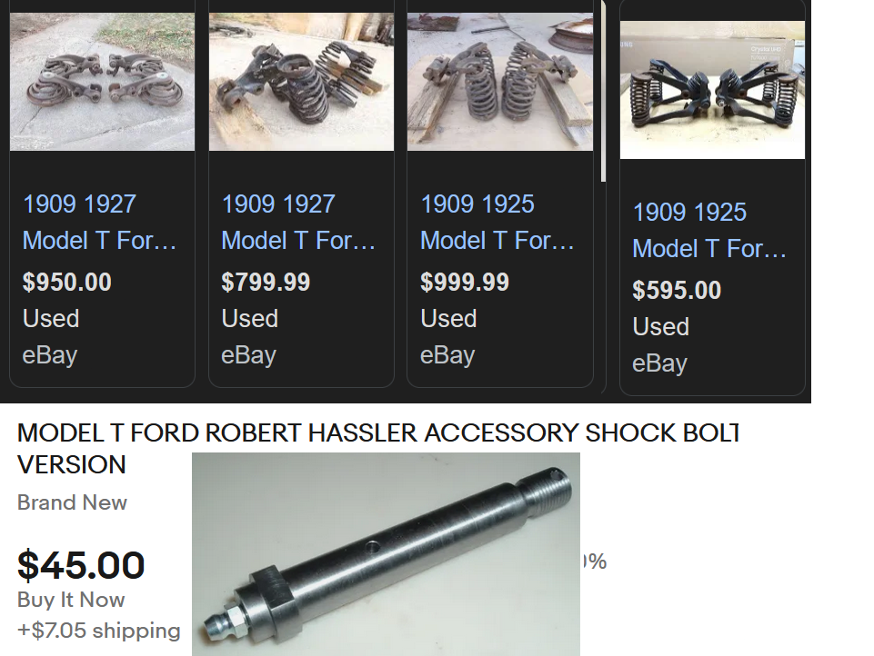

Are they actually selling for $500??????
I see sets @ swap meets for $100 or less. Saw a set for $75 @ Bakersfield & the seller was begging for offers.
I couldnt get $50 dragging them to several swap meets. I gave them away to someone I recognized that showed interest.

I have them on my 19 touring in the front. I love the looks and get a ton of comments on them at shows. They were a bit tricky to install by myself as you have to reverse the front axle. Iv had them on now for over 15 years. As far as ride goes I cant really say. The roads down here in Florida are for the most part smooth as glass. I only have them on the front as I have AC brakes on the back and they can not be installed on the back with my brakes.

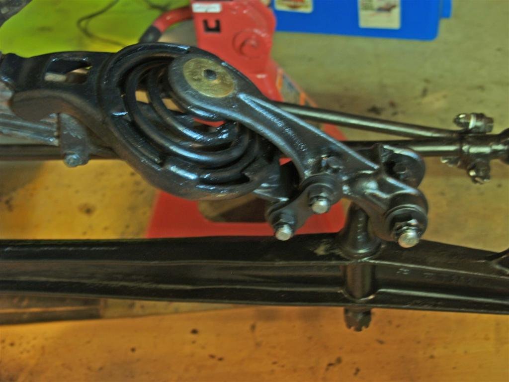

I installed them on the front of my TT and the ride improved alot. I have a set to install on the rear when I get time. I seem to have more body roll but the ride is softened quite alot.
I found the same, I like them. Mine are 'pancake' rather than beehive, I don't have much issue with body roll with them.
My thought is, if it works for you, then it works!
Cheers
Adrian

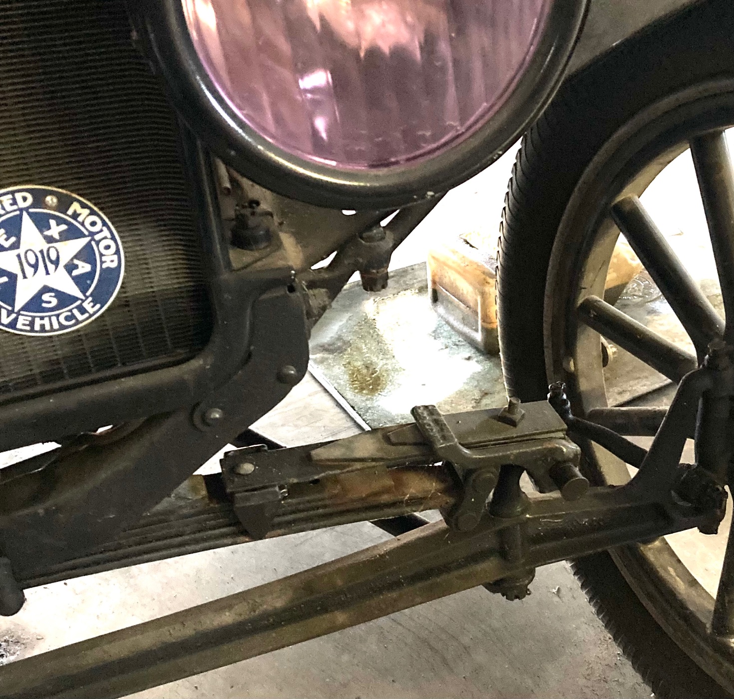

Really improved my ride after I installed Hasslers on front
Resolved bump steer, the front end no longer sways left and right because of the spring shackles not being restrained, now it is
Don’t have perfect back roads here, car now stays straight ahead.
Have a nice set of rears Hassler for rear if anyone interested, I have Rocky’s and can’t use them

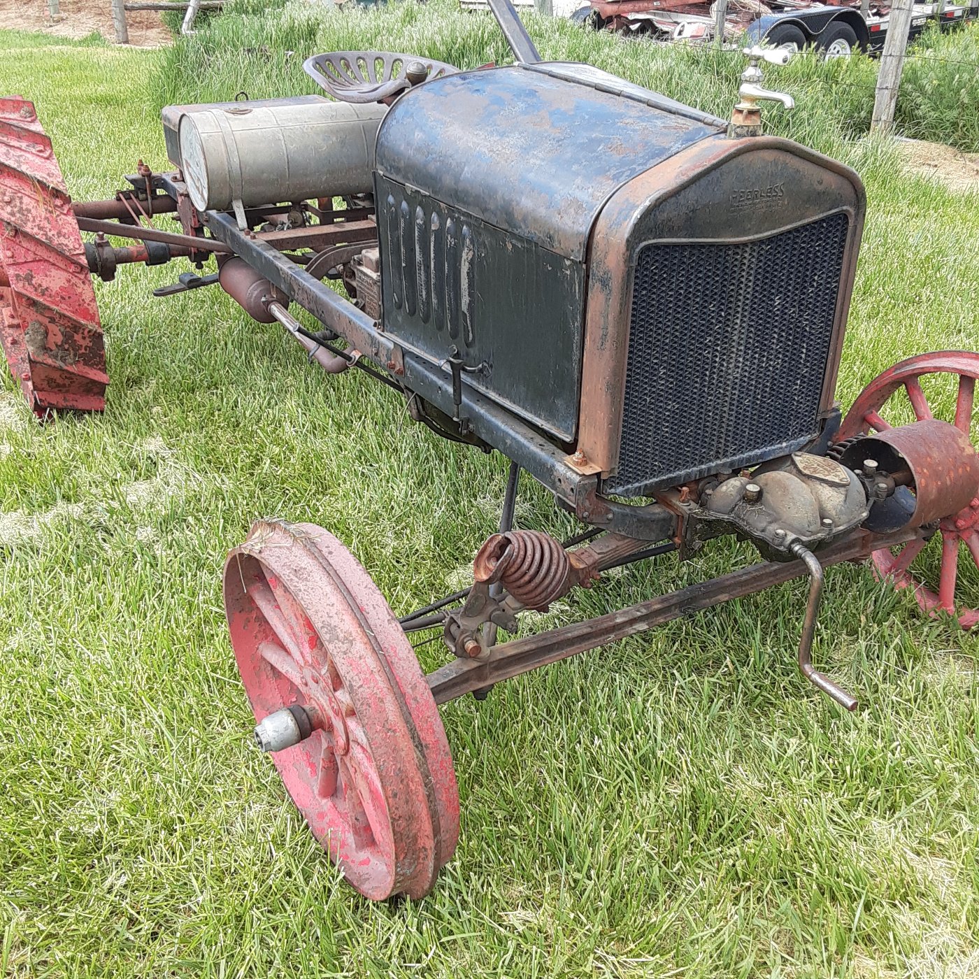

Post by kevinf » Mon May 13, 2024 2:29 pm

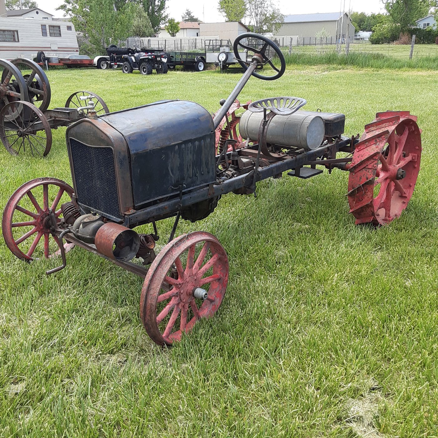

Steve, When I put Hasslers on I noticed no improvement in the ride. Cast iron front wheels and steel cleats on the rear, may have overrode any benefit. :D
Good to see you back,
Kevin in "Ewetah"
Posts: 5610
Post by RajoRacer » Mon May 13, 2024 2:38 pm
I don't imagine those Hasslers helped much on your ride Kevin but that's a nice power take-off - only second one I've seen like that !

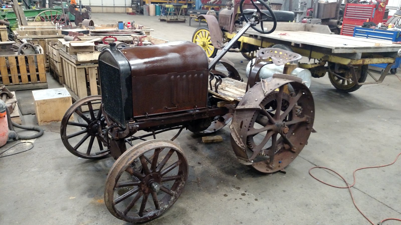

Michael Peternell
Posts: 734
First Name: Michael
Last Name: Peternell
Location: Albany mn
Post by Michael Peternell » Mon May 13, 2024 8:57 pm
Kevin in "Ewetah"
Now that is a peach!!! Front belt drive! Just curious if it rattles things. I have a new old stock I'm contemplating adding to my little Shaw.
Duey_C
Posts: 1558
First Name: Duane
Last Name: Cooley
Location: central MN
Post by Duey_C » Tue May 14, 2024 1:44 am
That is flipping cute Michael!
