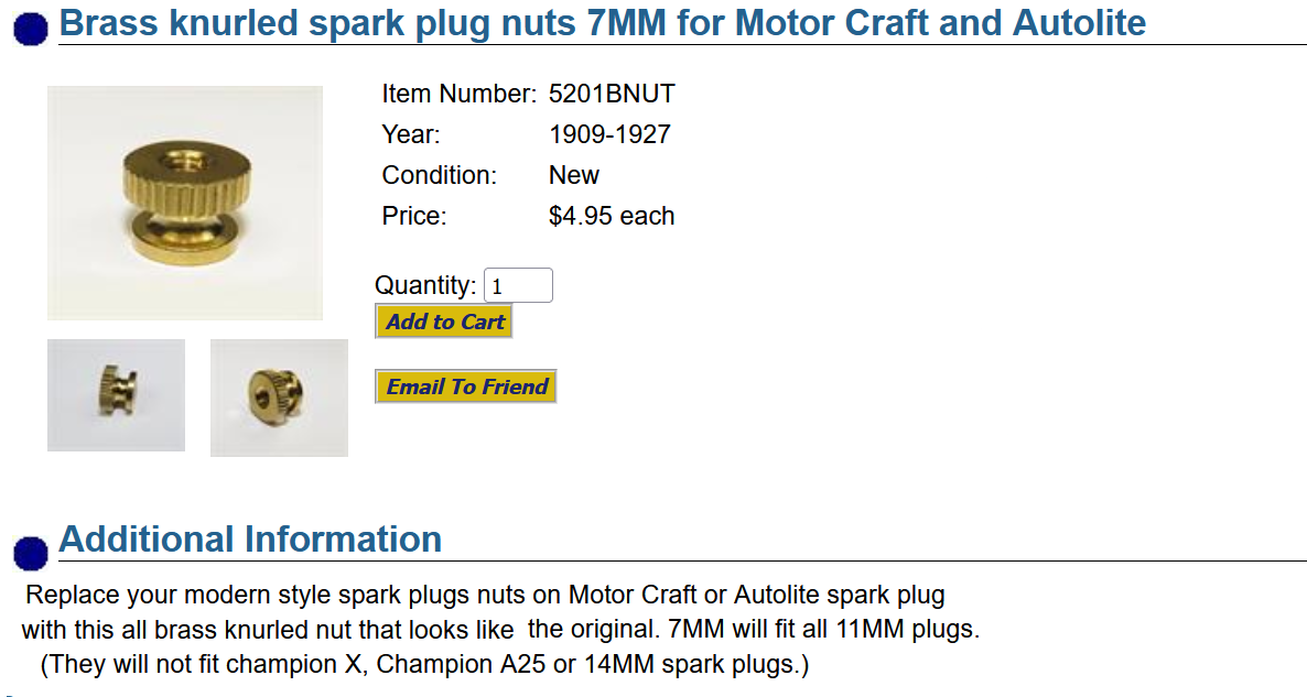

I didn’t check, but Restoration Supply carries a bunch of hard to find parts for antique cars

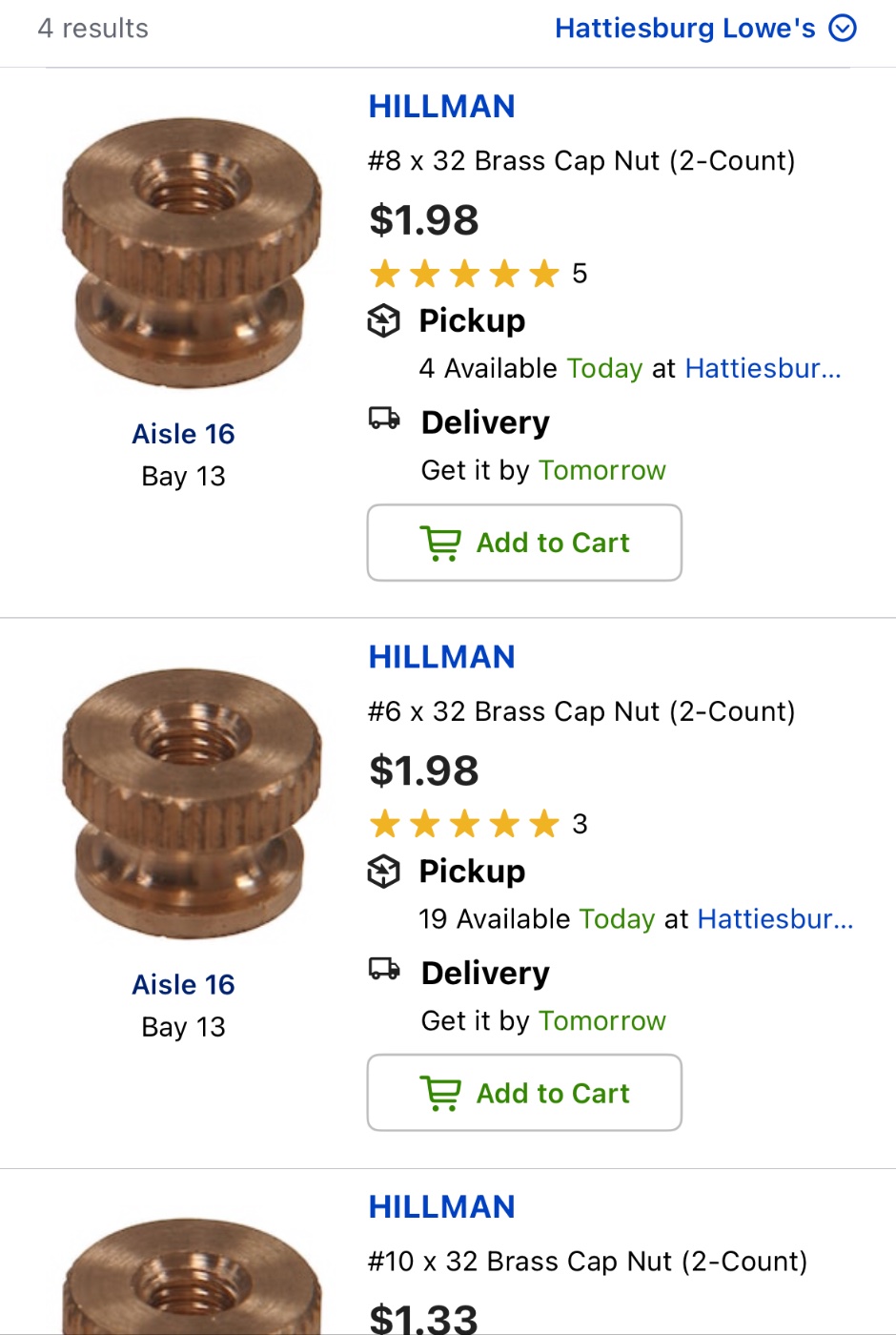

Heck go to Lowe’s or Home Depot and in the specialty section they carry the knurled nuts in multiple sizes. Take your spark plug in and find the right size with their displays. I found the size I needed from an appearance standpoint then tapped to the size of the stud. 14 cost about $10 but I could have ordered a bag for less. Best John
