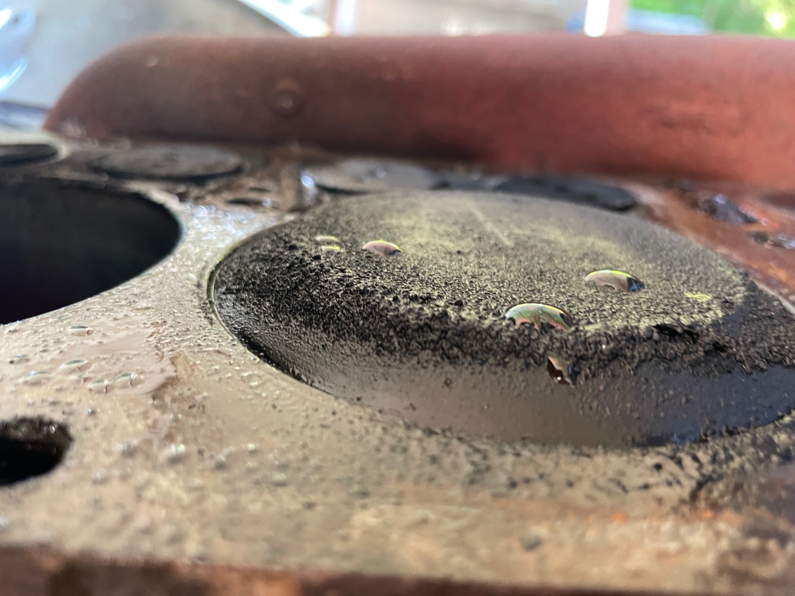

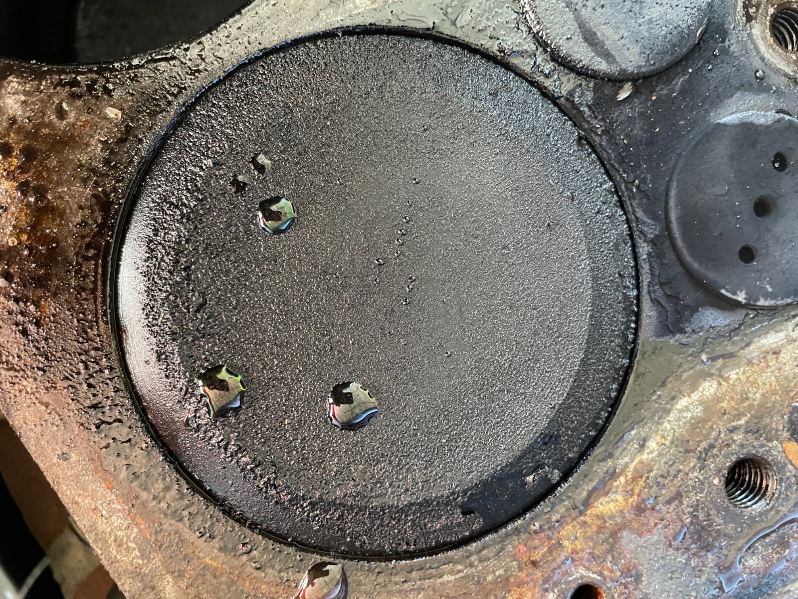

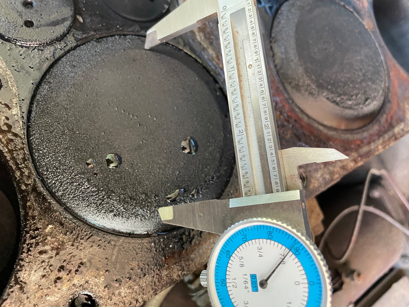

Pics of piston

They don’t seem like the normal domed top high compression pistons, what could be wrong?

The pistons you are using dont look out of the norm, in fact they dont look to be all the way on TDC.
Your pistons are not the profile of hi compression units. HC pistons have a full spherical top.

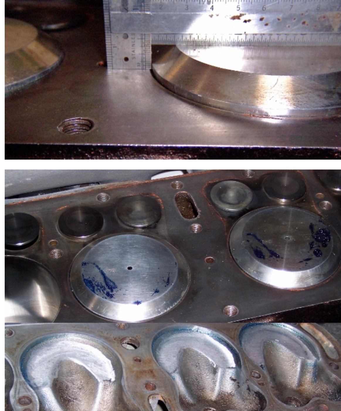

Clean all the carbon off piston tops and cylinder face. Then put some dye , Prussian blue on the inner chambers and fit head loose with couple of head bolts. Crank over, then check where piston tops hit the head chamber. Remove by grinding away alum surface in the head until no contact. Usually only a couple of pistons strike, as the Z head is as cast and some chambers are more shallow.

They look to be a bit high from your pictures. Also if the cylinders have been bored oversize, the piston might be hitting at the edge. Try using some Prussion Blue on them and you will see where the blue is hitting the head and be able to judge for yourself. Sometimes grinding a bit off the head at those points will cure it. If they are high compression pistons, you need to use a standard head likewise with high compression head you need standard pistons, but do not use both high compression pistons and head. Also if either the block or head have been re-surfaced, too much might have been ground off. Dan has it right on. He was typing his answer while I was doing mine!

You might try the Prussian blue Dan mentioned. It will show areas in contact.
When you fit the head, do so with a pair of pistons at the top of their travel, when the intrude farthest into the combustion chamber. This will help at least two pistons to centralise the head around those two pistons. Crank it over by hand to see if you still have a problem with the other two. In my experience with Z heads, you will need to relieve the sides of the combustion chambers so they clear the pistons.

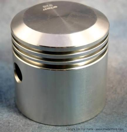

Here’s a picture of Model T aluminum pistons in std sold by Lang’s just for comparison. They do look pretty close in the dome height as the ones Jonah posted. But of course I could be wrong.

the height of a standard Model T piston above the block is 5/16 " ( .312") ...that assumes standard length connecting rods (7.000 center distance ) and a un-machined deck on the block ... any additional projection above the block deck will reduce clearance within the chambers of the cylinder head ( and raise compression ) ... on every Z head i have installed there was interference on #2 and #3 pistons ( 7 heads ) ... likely due to warpage during the cooling cycle after casting ...Gene French

Looking at that scale in the first picture it almost looks like top of the piston is 3/8" above the deck??
