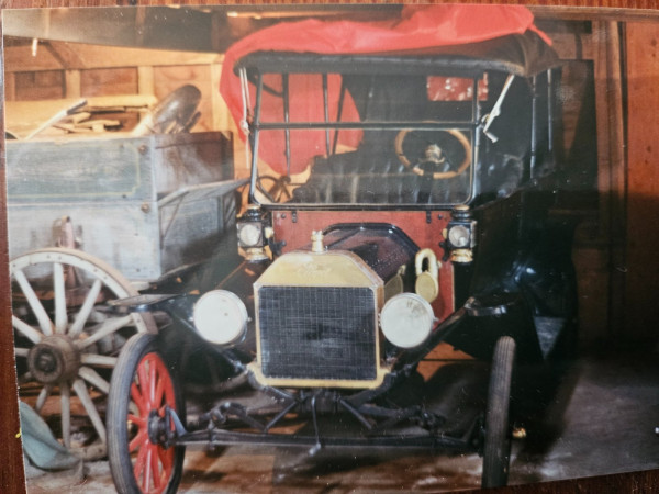

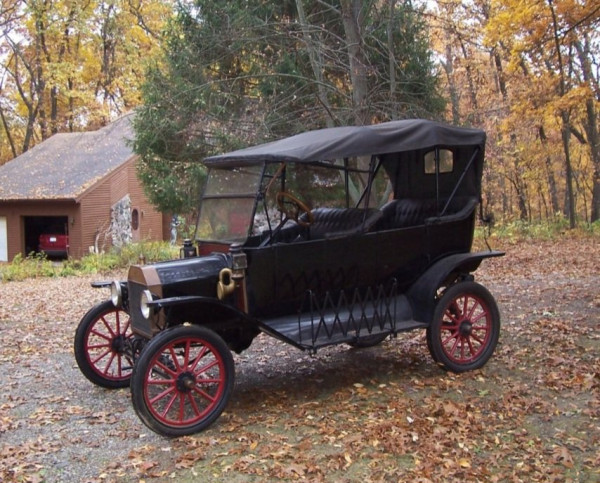

I dislike the overused term "barnfind", but, she's literally just that.
Pretty much entirely original condition, in very decent shape from an older, minimalist, restoration in the late 60's (more details to follow). The car has quite a number of interesting period aftermarket modifications, some I've never seen before. Now, before the overzealous of you bunch start arguing over what's "not original" on her, just hold yer damn horses for a minute...this old girl has an incredible back story....and I'll get to it by posting individual stories to this thread.
But, I'm proud to be the newest care taker of this wonderful old car, and great to be back to MTFCA!

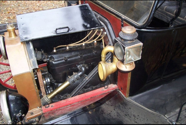

- Posts: 4955
Re: Newbie (Kind of) here...
Cant wait.
Interesting foot horn.
Does it work well?
This might be a good option to keep the normally mounted bulb out of the way.
Does it work well?

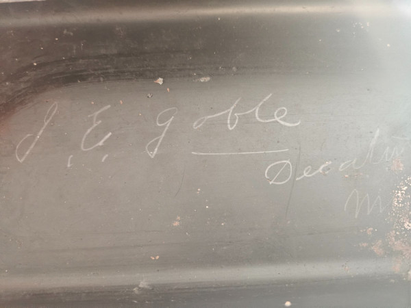

So, the backstory of this car.
It was purchased new in 1914 by a rather well to do family in Decatur MI. The new owner, J.E. Goble, even felt compelled to claim the car as his by signing the inside of the coil box cover at some point in time....
In 1915, the road up to Pikes Peak CO was completed, and 1916 brought the inaugural annual race to the top. There is some uncertainty as to whether it was for the first or second race, but, J.E. Goble, in either 1916 or 17, took his wife on a long summer road trip cross country from MI to CO to see the race. (Works the old imagination considering what stories they had with that road trip!!!). In preparation for the trip, Gobles made some modifications to the car, some of which I've never seen in my day.
(I'll cover each mod in separate posts).
The second owner was a neighbor of the Gobles, who was 7 at the time they bought it new. He was instantly in love, and as he got older he continually begged to buy the car...finally being successful in 1930...when he was in college. The car was moved to the family farm, covered & stored in the barn....where...due to life's circumstance, it sat for decades. Ultimately, the car became a retirement project in the late 60's/early 70's.
This pic was taken when it was rolled out of the barn for the first time in the 60's (apologies for the poor quality, pic was taken looking thru a slide) The engine was rebuilt, and the sheet metal was painted. The wood on this thing remains solid, as are all metal panels. It has minimal rust, just surface spotting, no cancer, all seams intact.
Unfortunately, the man went blind before he was done...and...it was rolled back and recovered in the barn yet again. Per the son, these pics were of the car being stored back in the barn after the initial restoration. His son decided it was time to sell...where I am now the next care taker of this piece of history.....

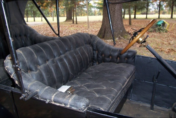

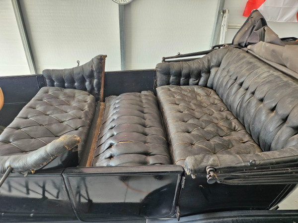

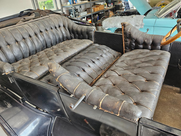

I imagine that Mrs. Goble, being a fine lady, was not as enthralled about the trip as Mr. Goble, certainly not considering the prospects of a month long trip sleeping on the ground sharing her bed with the creepy crawlies.
I bet the first and most important mod Mr. Goble made was to convert the front seat back to recline, and in so doing to make a bed to convince his wife to make the trip!
By cutting the sides of the front seat, adding in new wood to strengthen and to tack each side of the sheet metal and upholstery, adding hinges and lock brackets, enabled the seat back to be lowered and convert to a bed. Not a very big bed, all of 38"x58", and certainly no PosturePedic, but...workable enough!

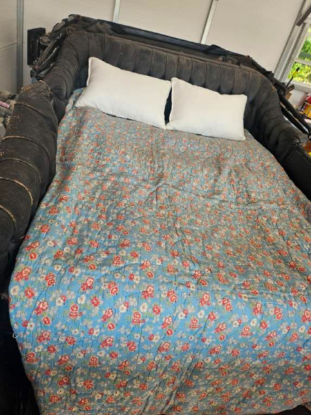

I'm sure this looked more enticing than sleeping on the ground!

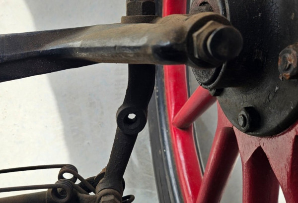

Given the lack of improved roads across that expanse of rural America between MI and CO, the other mod made to the car was to add aftermarket spring shock absorbers on all 4 corners.
Now, I have seen the common Hassler's, as well as the W&C, Liberty and H&D shocks. While these are similar design to the H&D and W&C style, the arms on mine are more straight and less curved, and made a bit differently. There are no markings on these, and I have not been able to find anything that looks similar.
Any conjecture?
Any conjecture?

So much inclement weather to expect on a long cross country trip, who wants to get out of that nice warm bed and go outside in the mud & rain to start the car?

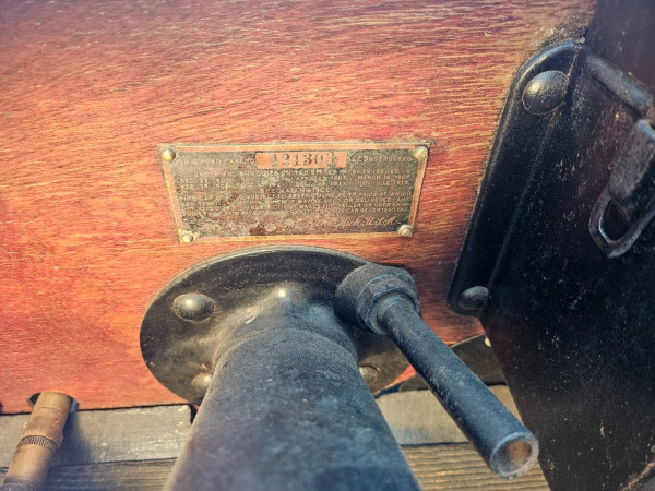

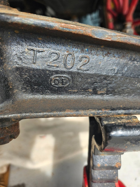

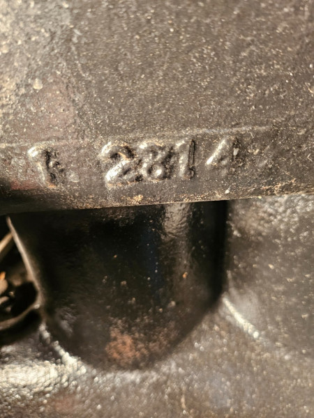

The car retains the original engine, built in April 14.
My experience being T titles use the engine # as VIN being the most common/consistent number source. So, I gulped hard reviewing the Title noting a mismatch.
Apparently from what I gather, the bodies produced by Ford in the early yeats contained a body # stamped to the patent plate. Up to 1913 there was consistency in stamping the engine # to the body plate, but, that diverged to using different #'s....or so I've read.
Such explained the Title number...it was the body plate, not the engine. Cast dates of 1/28/14 on the block, and Jan 13 on the head.

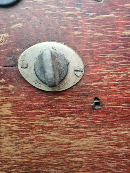

As for the headlights, the son told me his Dad stated the car originally came with the electric lights, and never had the gas headlights per his memory. I seriously doubt it came from the factory this way, April was way too early for any crossovers with '15, that, and neither did Ford produce electric pickle fork lamps, being single post design from day one, nor were they of this rim design. So, either the Ford dealer modified the car with aftermarket headlamps per the buyers request, or, he changed them out himself, maybe in preparation for the CO trip...who knows. The running board does show what appear to be mounting bolt holes for a carbide acetylene generator. Regardless, it is known, at least via first person witness, that these are correct to the car since new. I haven't yet taken them off the car to check for any manufacturer stamps, but none are visible.
The switch also looks to be a period aftermarket, a simple on off switch, that, and certainly no resemblance to the 15 style switch.
Unfortunately, there's no continuity thru the switch, so I'm crossing fingers I can repair it...

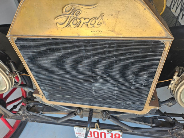

Another 1914 anomaly on this car...
It was stated that while the body was repainted in the 60's, there was no cancer, no repairs, and no panel replacements made. It still shows the dents and dings it earned in its life, but all panels are solid, no seam or edge rot, underside of doors are solid, etc.
So on that basis, from what I've been told, and based on the overall condition of the entire car, and the fact I have all reciepts for everything his dad bought for the restoration, it is my belief all metal is original.
