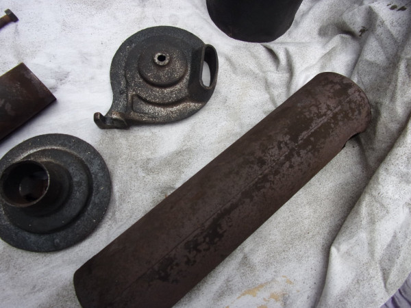

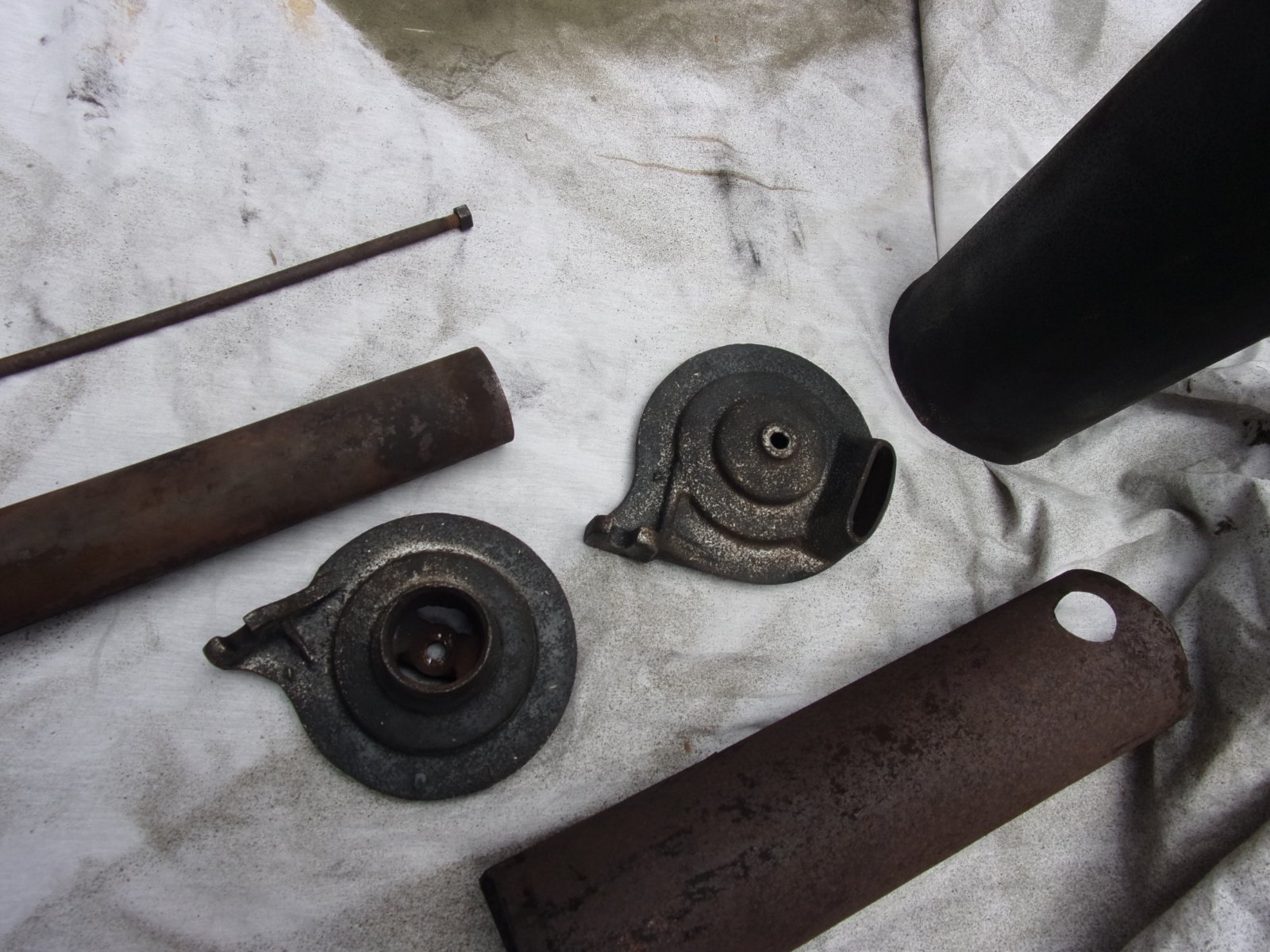

I don't know what I got here...pulled it off the shelf. Repro? Original? But if it helps someone, my shelf does not need to pass emissions.

Robert, what you have there is the last incarnation of the cast end mufflers, just before the introduction of the full length exhaust pipe and pressed steel ends for the muffler. Prior to this one, the cast ends had mounting lugs cast with an open triangle in the web. I will leave the timeline to those more knowledgeable.

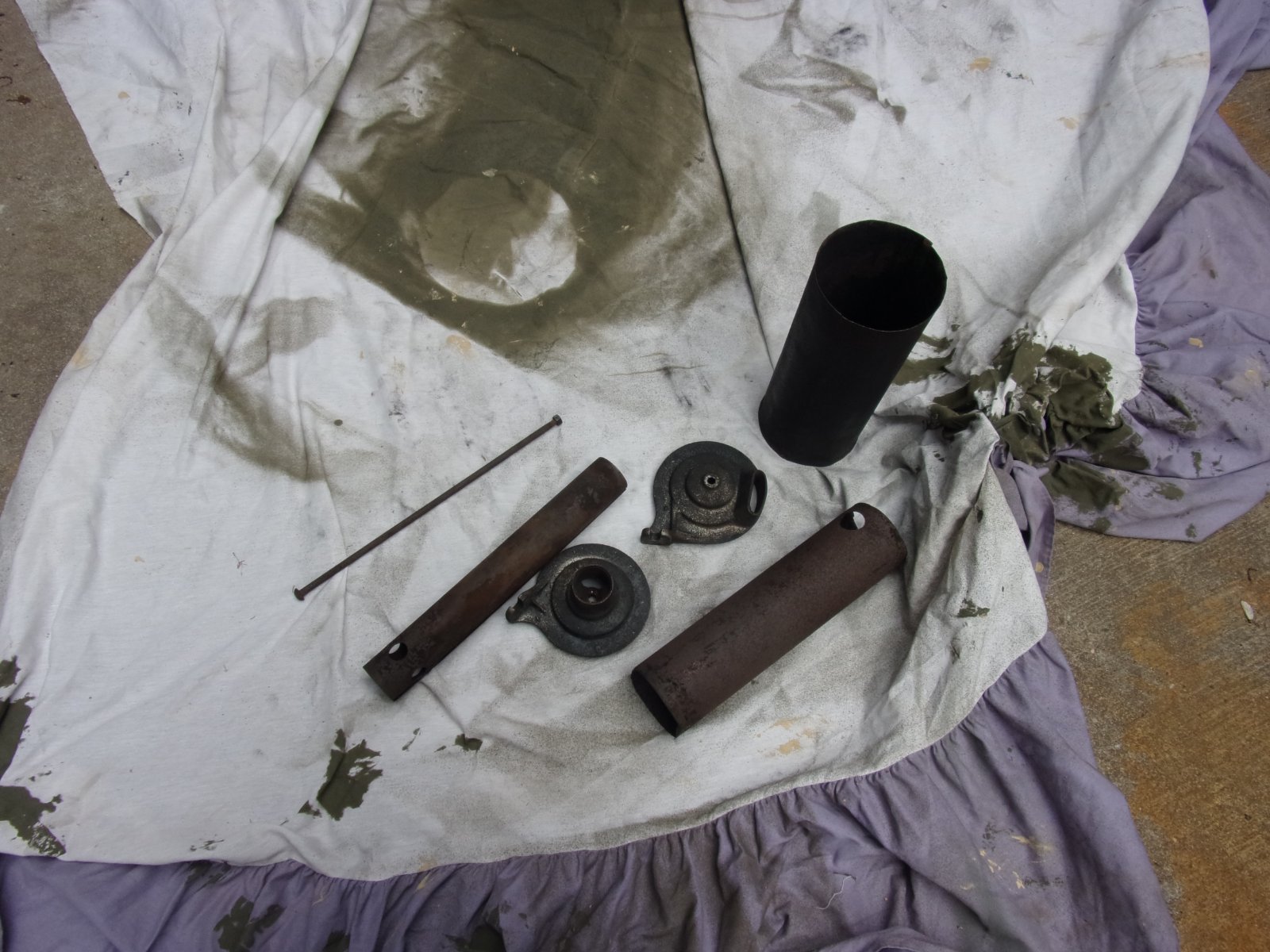

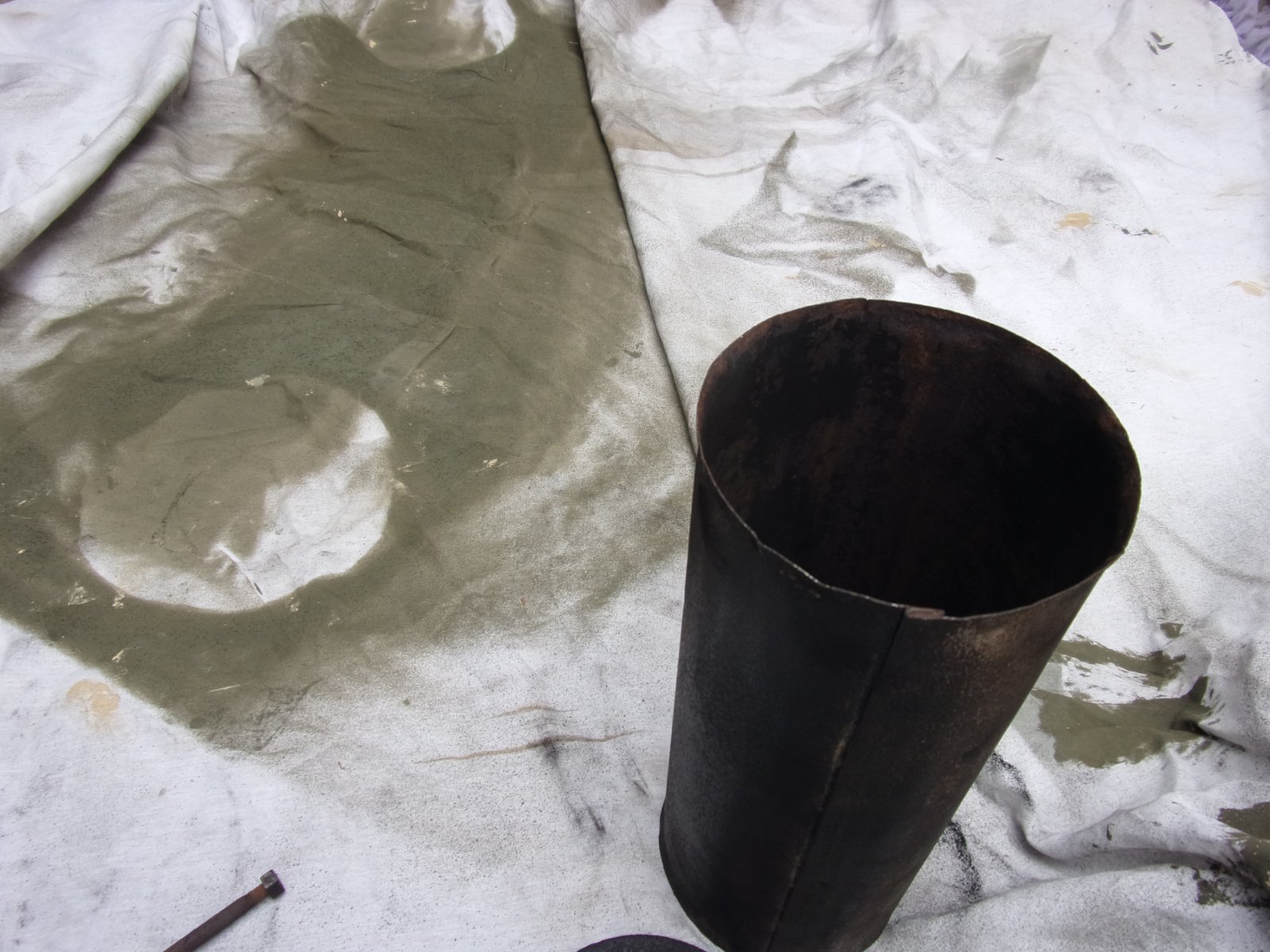

Larry, I'm not sure if your last comment was meant for me, and if so, what question you were referring to. The late muffler that I obtained with the internal pipe had a middle baffle pipe that was in excellent condition, other than being sooty and surface rust. The outer shell pipe was probably usable after doing some straightening of minor bends on the front and rear edges, and brazing up some pin holes. The inner pipe, or part of the exhaust pipe, is sound. it was just cut off from the rest of the original exhaust pipe about 10" to 12" in from of the front muffler end cap. So, all is well. I'll just replace the outer shell with the new stainless steel shell that I ordered.Original Smith wrote: ↑Sat May 18, 2024 12:20 pmLook in the Ford parts book. It will answer your question.

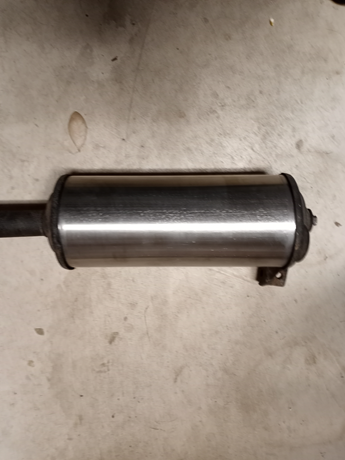

Re: Late Muffler Shells

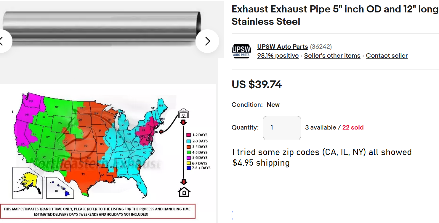

Since I was not looking for an authentic outer shell for my muffler and since my middle pipe and the inner exhaust pipe were rust out free, I found this new stainless 5" diameter, 12" long piece of stainless pipe that fits like it was made for the job; no modification needed, and the stainless is at least twice the thickness of the original steel and will outlast the rest of the Model T and ME.
Shannon, I found it on EBAY. The seller UPSW Auto Parts still has an ad currently, however they say they have only 3 left. Their EBAY listing number is 195306884812. The price is $39.74 plus $4.95 shipping, but it is a perfect fit and I didn't have to go scrounging for it. Postman delivered it to my front door.Shannon_in_Texas wrote: ↑Wed Jun 05, 2024 9:25 pmTerry, where did you find this outer stainless piece? Was it a random find or did you order it from somewhere?

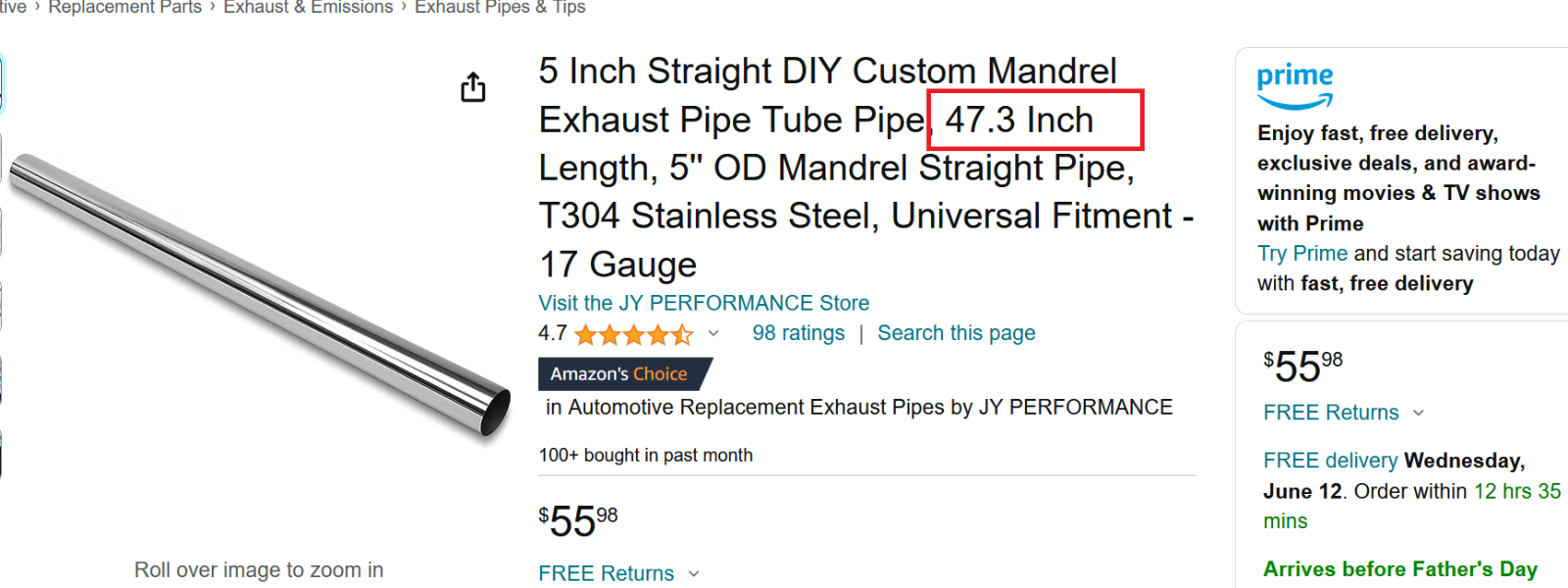

Deal here make's 3 1-footers
https://www.amazon.com/Straight-Mandrel ... d_source=1 --

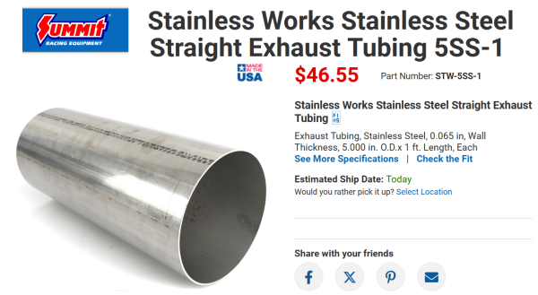

Walk in
https://www.summitracing.com/parts/stw- ... gK0Y_D_BwE

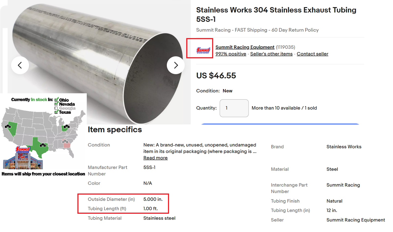

Summit on eBay likely this shipping is better
https://www.ebay.com/itm/196273315583?c ... gJQ0vD_BwE

I was thinking that some one might get the Amazon one (also on eBay), cut it, make 3 sell 1 or 2. least costModelTWoods wrote: ↑Thu Jun 06, 2024 7:54 pmFrank, after checking the examples that you found, I noticed that the one I bought off EBAY was still the cheapest and best price by almost $10.00.TRDxB2 wrote: ↑Thu Jun 06, 2024 12:39 pmChecking GoogleShannon_in_Texas wrote: ↑Wed Jun 05, 2024 9:25 pmTerry, where did you find this outer stainless piece? Was it a random find or did you order it from somewhere?
Walk in
If some one is close to a Summit location, can walk in save the shipping and see the goods
Only 3 left on eBay seller's
https://www.ebay.com/itm/195306884812
