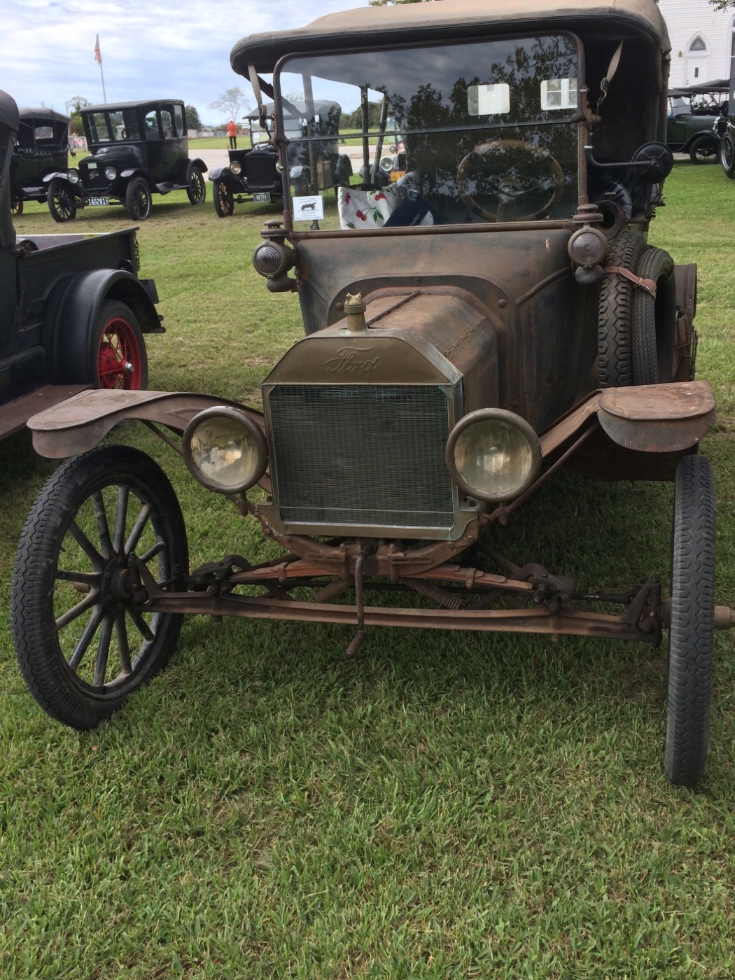

Ever seen an original ‘15 wide track with 2 rear ‘lites’?
