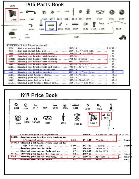

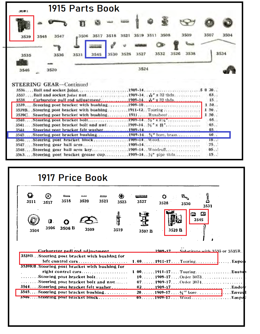

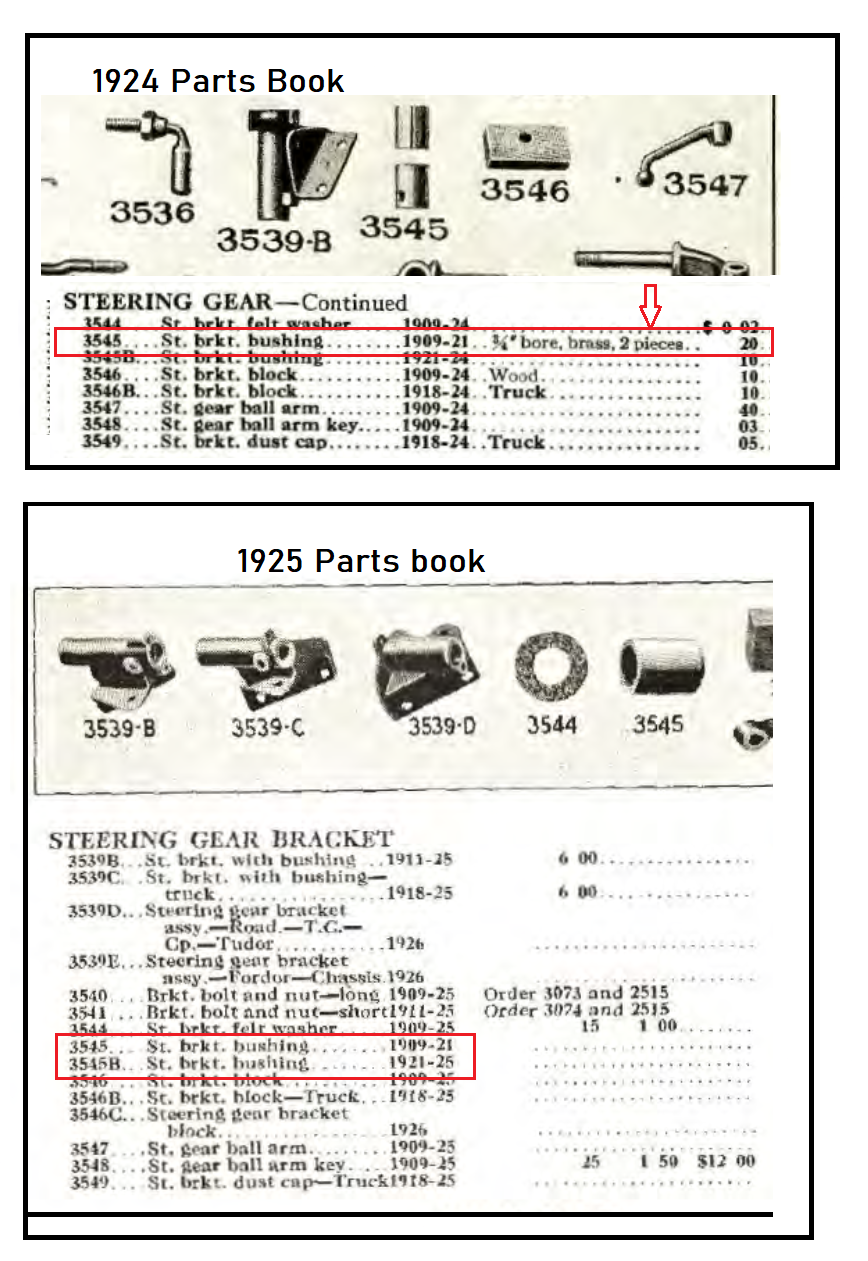

Well..... trying to answer the question using Parts Book information from various years...
The "steering post bracket with busing" in the 1915 references 3 different ones but only one busing part (picture looks like a long bushing)
Then in the 1917 only one "steering post bracket w bushing" is noted as well as just and bushing & is shown as two pieces
Later
the 1924 reflects the same as the 1917 & indicates verbally & in the diagram two bushings
AND now in the 1925 Parts Book three "steering post bracket w bushing" are shown and two bushings are stated by year range
Four different steering brackets are reference per 3539, 3539-B, R3539-C, 3539-D. 3539 looks like it uses 1 long bushing, while 3539-D uses 1 short one. 3539-C & B depends on ?
Later

Great information Frank! I believe I have the 1 pc. of 3435B Bushing along with the 3539-B bracket. That makes sense and is what I expected. Now it's just about do I want to stuff an extra bushing in there. Not sure there's a lot of benefit to it. It's had 1 bushing for the last 40+ years that I know of and only now needs replacement, (well, okay... it needed replacing years ago, but I put it off till now
). If I can stretch out the new one for another 40 years, I'll have to replace it when I'm 99. I hope I'll be up to it yet by then
