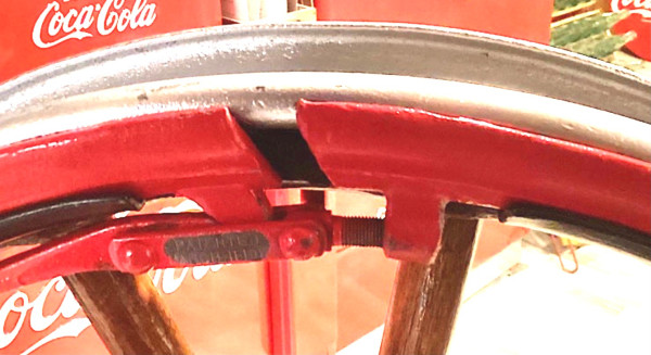

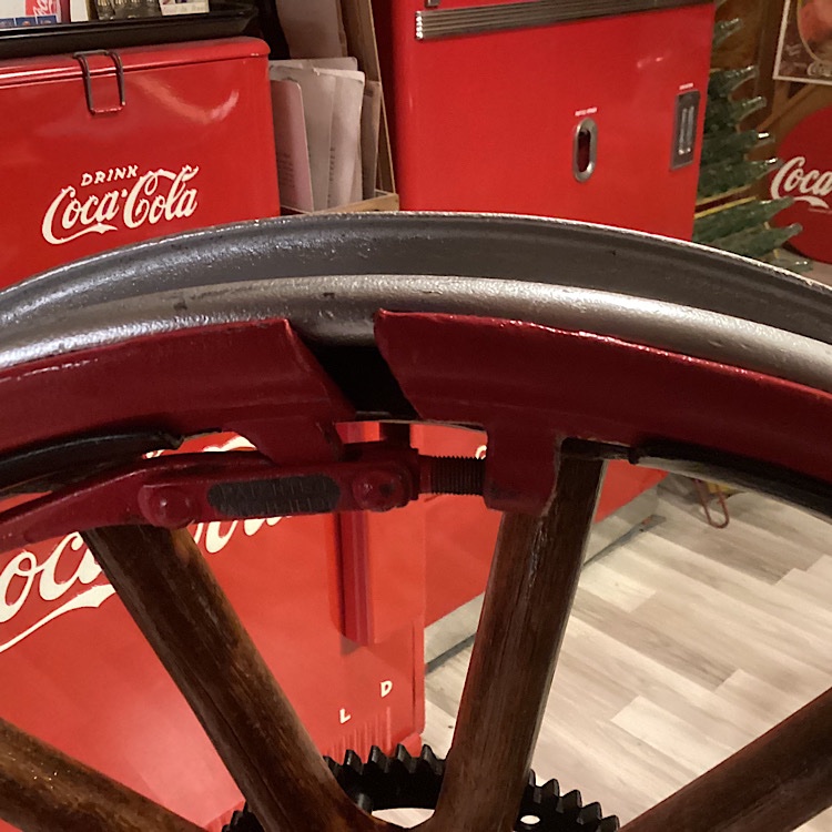

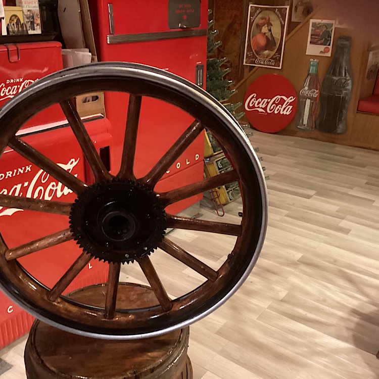

These photos were sent to me by a relative asking if I knew what the heck it was. I said I’d ask here. It looks like it converts a non demountable to a demountable rim. We were speculating that it might be used for a quick change for a flat but that’s just a wild guess. Anyone got any info on it?
- Posts: 4694
Re: After Market Wheel Converter ?
I never saw anything like it. It might be to fit 30X3 1/2 rims to fit 21" wheels. Anyway, I wouldn't drive on a wheel like that. It is a roll over accident waiting to happen. especially on a front wheel which that looks like it is with a speedometer gear on it..

That’s the point of the post Norm. What the heck is it?
- Posts: 4385
What happens to the rim when the device is unclamped & removed? I see it has a patent plate on it. Any more information besides the word "patented"?
- Posts: 4042
There is a date of the patent, can’t read the year, with full date, day, month and year that patent can be researched on line.
Can read March 11, 19__

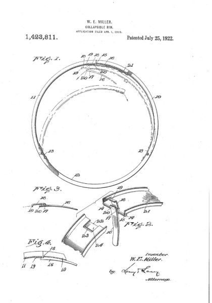

Tried using the patent date, but records at the USPTO can't be searched by just patent issue date unless later than 1978.
So used Google patent search and typed in 'demountable rim' and got lost in over 3000 hits over many years. Gave up
IF the patent number was known, then can be found.
Did find this one, but it's just a split rim, not a split felloe

Better photos from a variety of distances and angles would help.
- Posts: 4694
Do you suppose it was made to convert a 30X3 wheel to fit 30X3 1/2 tire? You would need to make the diameter of the rim a bit smaller.
- Posts: 5102
Norm may be on to something, kinda.
It could be used to use a 30x3 tire on a 30x3 1/2 rim.
Possibly allowing the owner to carry only one spare tire 30x3 & the adapter for the 2 sized pre-demountable wheels.
- Posts: 7126
That makes good sense John, but, it would only apply to demountable wheels. Our Canadian Cars came with 30 x 3.5" tyres all round. Were there 3" demountable rims on wheels in the USA?
- Posts: 5102
There were no 3" demountables in the US, at least common knowledge wise.
My SWAG is a 30x3 tire on a bare rim (24") could be placed on a 30x3.5" rim sans tire.(23") All non-demountable.
This clamp device would hold it all together. If the driver had a front flat, the tire could be transferred from the device rim, thus not needing 2 different sized tires.
Remember that there was a huge accessory market looking for suckers, uh, customers.
An accessory's functionality was secondary to making the sale.
I am a big fan of accessory collecting.
Anyway, it's an educated? guess.

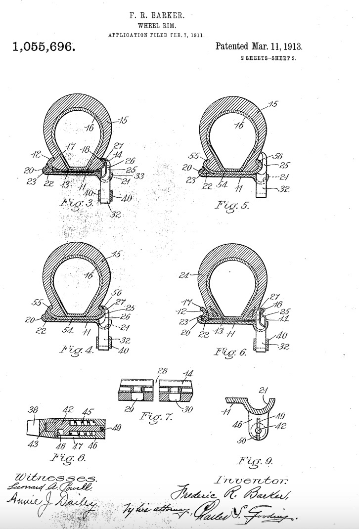

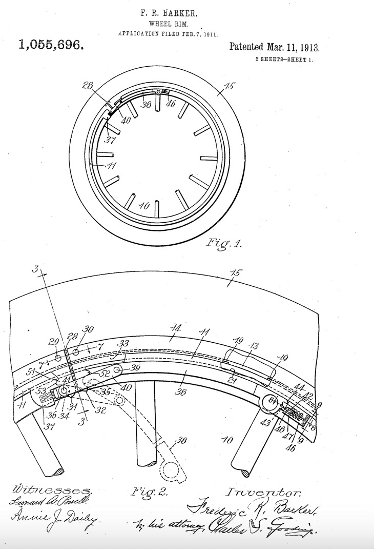

- Posts: 4042

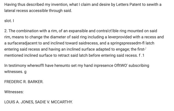

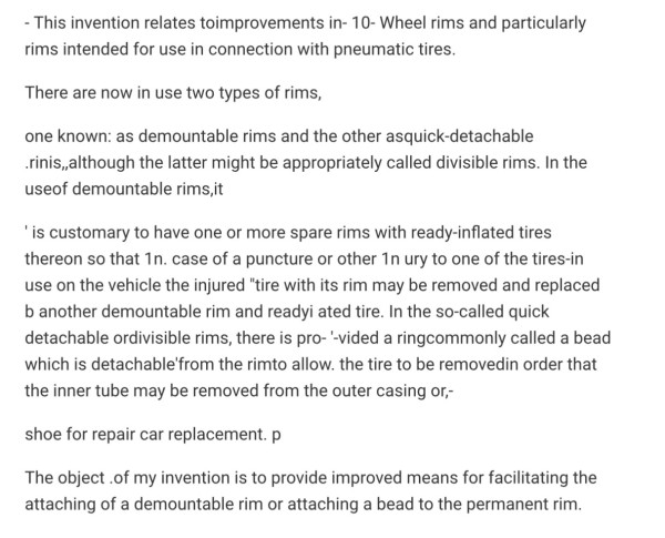

Well, after a couple of tries on Google Patent search, about 40 pages in of 360 hits for the time span around that patent date .
Finally found it. The invention is for quick release and install of a spare rim with mounted tire.
click on images to enlarge
Charlie B in N.J.
Topic author - Posts: 782
- First Name: CHARLIE
- Last Name: BRANCA
- Location: Brick N.J.
- Board Member Since: 2010
Good Lord Dan thanks a million! We’d given up on ever getting a definitive answer. Thanks again. Man that's a hard read. Took a few rereads to get it.
