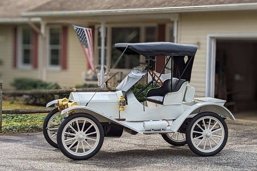

Thank you guys so much for your help and suggestions. I’m trying to set something up with Dave Young for next week.
1912 Metz Model 22
1912 Metz Model 22

That's a beautiful car, Bob. You should have no problem at all.
The Metz engine is very similar to a Model T, to the extent that some parts are supposedly interchangeable. Its transmission famously has about three moving parts, maybe less. You cannot find a simpler car or one that is more fun or easier to drive.
The car in your photo is in very nice condition, neatly and decently finished. Whoever restored this car had a great eye. With a few Fords under your belt, a Metz is a piece of cake.

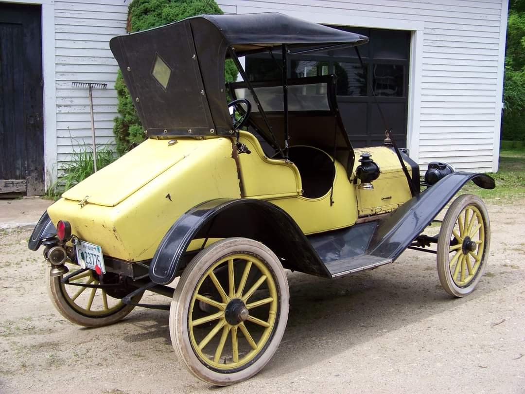

It does look very nice. I don't think that it is a 1912, but rather a 1913. Some of the most notable features of a '12 Metz are 14 spoke wheels and this car has 12 spoke, also the hubs are different from the later cars. The '12 cars have the (speed) control lever outside of the body and rising through a hole in the running board splash shield. The Prest-O-Light tank was introduced for the 1914 model year, the earlier cars used an acetylene generator. The '12s had an externally mounted "potato" horn and the later cars had a long trumpet like horn under the hood. Now, with all of that said, this car could have been built in 1912 as a 1913 model year; Metz introduced their new model year in September, just like Ford.
This car does have the engine undercover which is a necessary part of the cooling system. Many Metz cars are lacking this cover and without it the car will overheat. There should be a cover enclosing the "transmission" area; it protects the drive disk and the friction wheel. The chain covers are absent in the photograph. Many Metz cars are without the sheet metal covers which enclose the valve area and without the covers the engine looks like an early Model T "open valve" engine.
An ad for the 1912 Model 22:
The 1913 model year is different:
And my 1914. The turtledeck was new for 1914 along with some "1914 Improvements" as touted in the advertisements bragging about winning the 1913 Glidden Tour.
