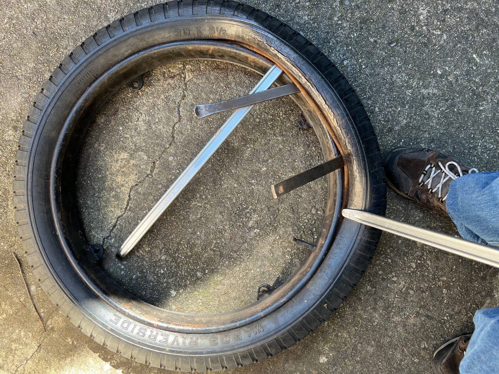

I recently removed very old dry tires and had to use motorcycle tire irons from HF. It was a tough job that took me too long but would’ve been impossible without the long irons.
I debated taking my rims and new (2007) tires to a local shop but decided to give it a shot. (Tire shops around me require appointments to see them. Like a dentist.).
The first two tires went on okay using the short irons. But that work wore me out and I had to use the long irons for the last two.

It is substantially easier to dismount and mount a clincher tire with the wheel (or demountable rim) on the car.
There's more clearance under the front fenders than the rear fenders. Therefore, if you have demountable rims, you have the added advantage being able to put the rim in question on the front wheel when you need to dismount or mount a tire on that rim.
If you have never done the above before, click on this link and scroll down to where Royce Peterson posted a "how-to."

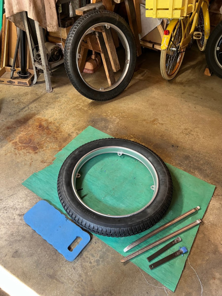

MY way--- No flaps, Rim strips.Two Long CHROME Harbor Freight tire irons ($8 ea). Baby powder dusting and GoJo for a lubricant. wheels on the vehicle. Warm weather and sunlight helps. I do not want to open the flaps controversy. This method works for me a 75 yr. old senior. Colonial Heights, Va.

All my T's have demountable rims, so i do all my tyre changing off the car on a waist high table. This is much more comfortable than working with the tryes on the car.
The Blockley tyres are a gem to fit. They are soft and pliable and could almost be fitted with Henry's stubby little original levers. With the 15" levers I have, they are a cinch. How much effort you make depends a lot on your fitting technique, and then the tyres you are working with.
There are three things I consider "must haves" when fitting clincher tyres.
First, use a rim liner rather than a flap. You don't need any complications to cause more grief.
Second, use a tyre fitting lubricant like the pros use.
Third, have a bar clamp or two to help hold things in place at the start.
Then, inflate the tube within the tyre just enough to hold its shape. Use the bar clamps to hold BOTH beads and the valve stem in place on the rim. Lever BOTH beads on at the same time. Right at the end, one bead may go on first. Just be careful levering the second side on, or belt it with a rubber mallet.
Job done! Inflate and check how the tyre is seated in the rim. Deflate to allow the tube to relax and reinflate to pressure.
Re-fitting older tyres which have just come off for a repair should also be almost as easy.
Fitting older tyres which have been off rims for some years is a whole different matter.
I was fortunate to find a set of five new, well stored original Olympic tyres some time back. With no wire in the beads, they had shrunk almost 3" in circumference. My local tyre dealer with whom we entrust all our farm tyre fitting had a T clincher rim in their shop , fitted with one such tyre, but with only one bead stretched over the rim. They could find no way to shift it enough to get a tube in, and had given up. They did set me up with a series of four different sized 14" rims and tyres of different overall diameters. Over the smallest of these, I levered one clincher tyre and then inflated it to stretch the tyre. A week later that one went an the next larger size, and another took its place. After four weeks the trye coming of the largest of the 14" rims was still too small. It was fitted over a 23" Chev split rim. With a split rim tool, I jacked it apart until there was a bit over a one inch gap between the rim ends, and left it for another week. That straw broke the camel's back! The tyre was then fitted with the tools outlined above. After 5 weeks I had a beautiful set of five spare rims and tyres for my fleet. I got their one side tyre off their rim. The difference between the one bead they had managed to stretch and the other was remarkable. I put their tyre through the same process and took it back to them when fitted. They were amazed, but determined never to volunteer to take on the job again. That is understandable considering the trouble i took to make it work. However, until we had Blockley's, no currently available was anywhere near as good as my old Olympics.
