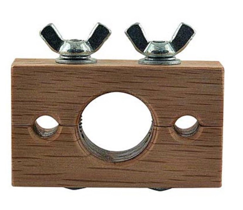

Anybody got the pattern for making that block that is meant to reduce throttle and spark lever slippage? They don't appear to be available anymore.

Older post from 2019 with dimensions of one T'ers wood work to make one of these contraptions
https://www.mtfca.com/phpBB3/viewtopic.php?t=4693
Usually a small adjustable wrench, fitted to the quadrant, will lift or bend up the quadrant in a spot that 'tightens' the lever against the grooves in the quadrant arm to prevent slippage.
