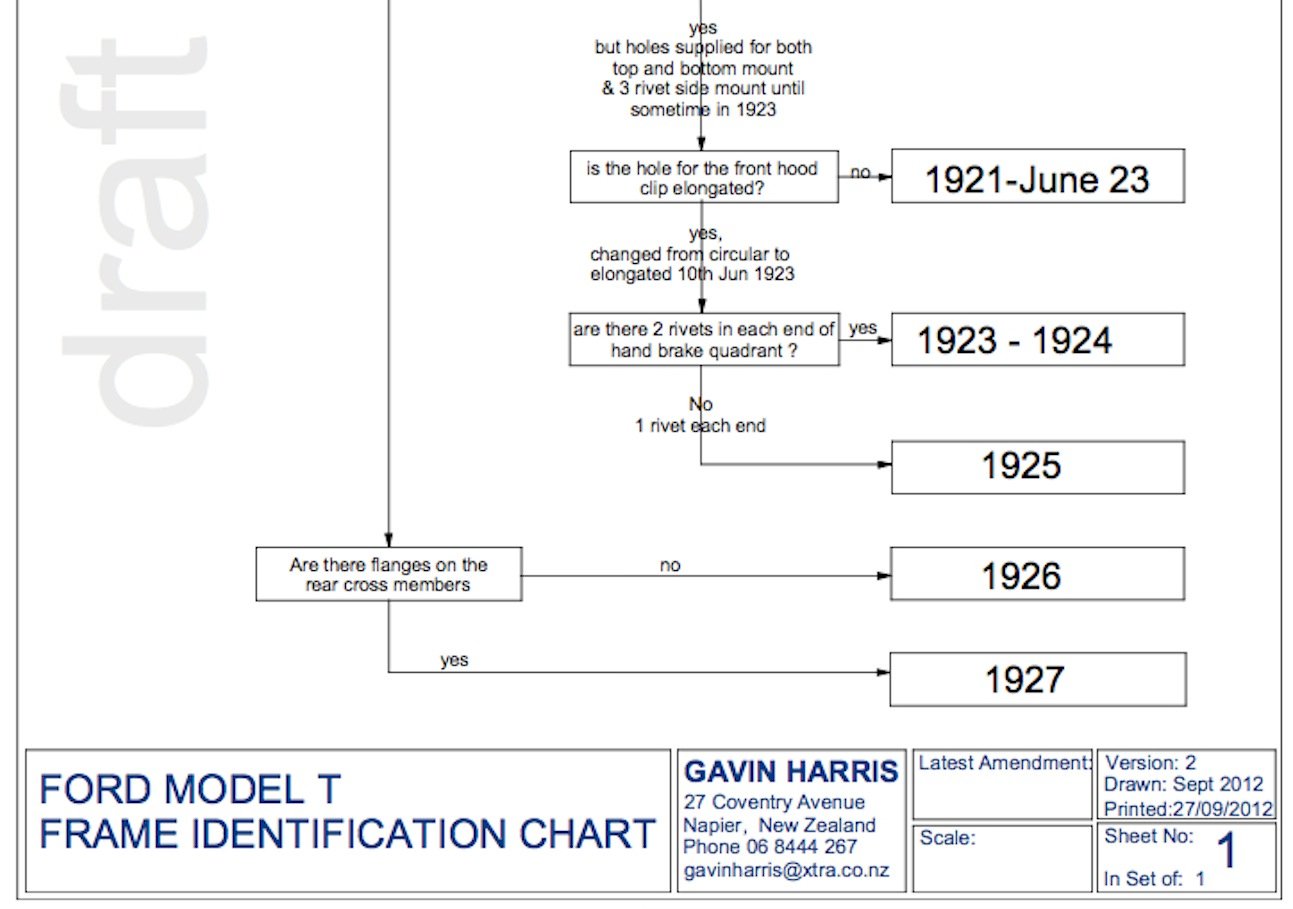

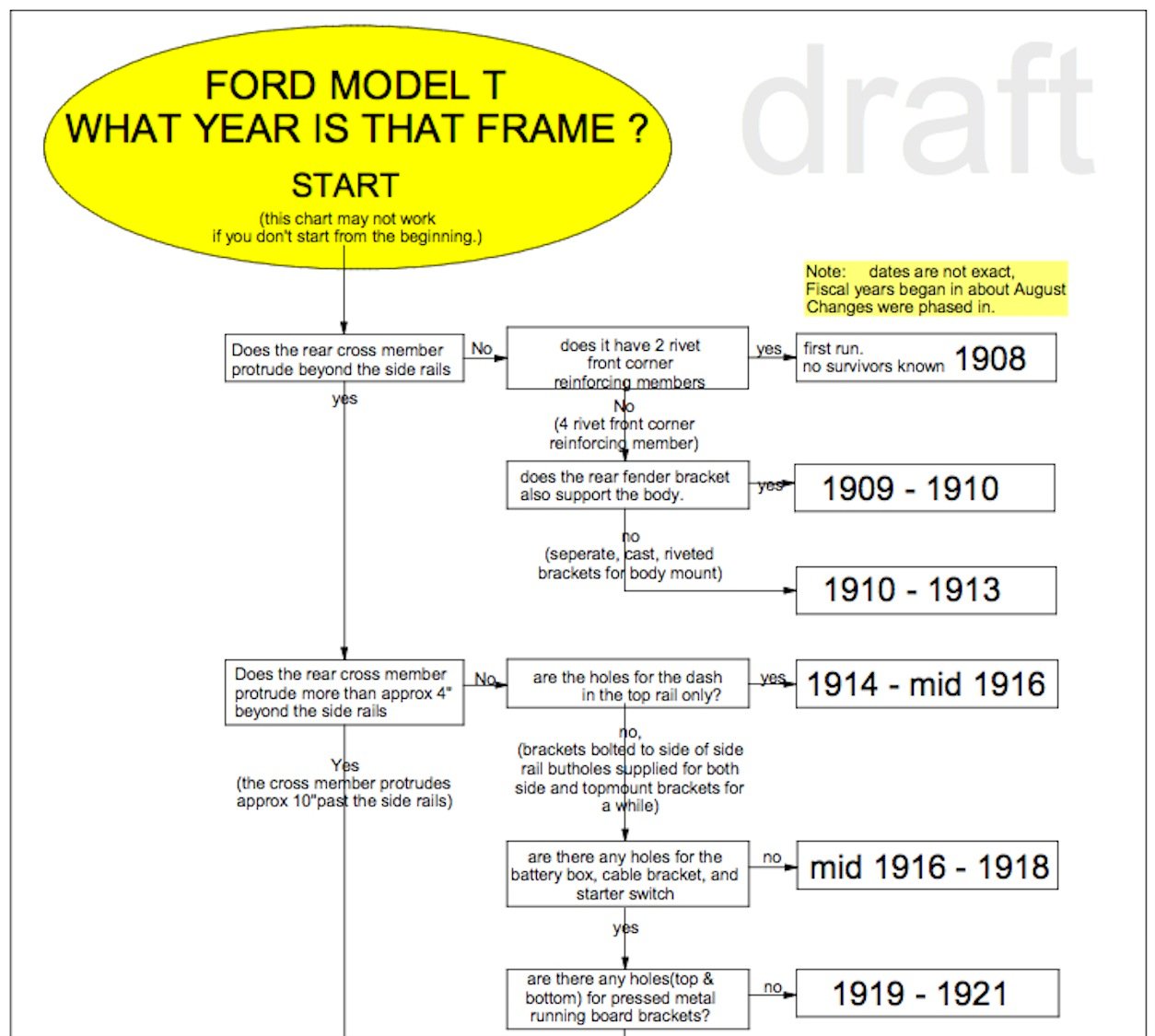

Yes, my 23 has a steel firewall. Would the 22 body fit to that chasis with a steel firewall or do I need to try to find a 23 body or re-wood the one I have?
- Posts: 7411
Re: 1922 vs 1923 touring body
Apparently 22 and 23 use the same frame. I expect either body will fit it. The steel firewall should also fit both, as it was used as a replacement part for the wood ones.
