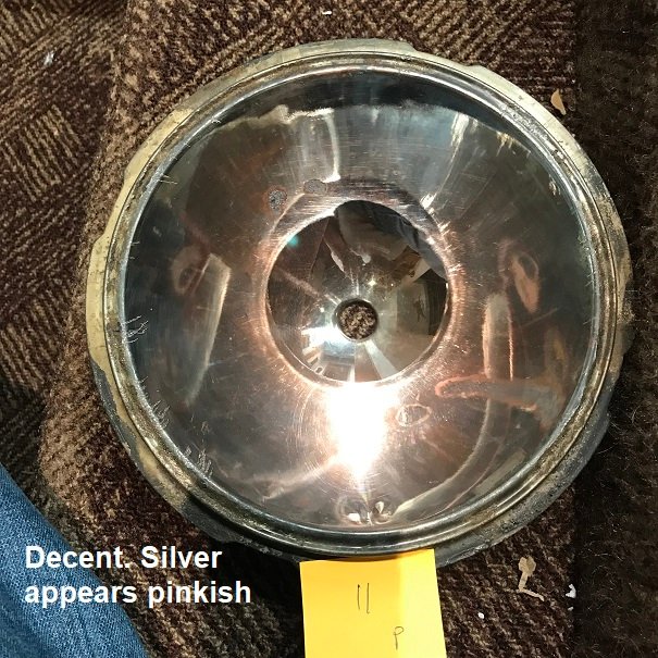

The reflector surface is silver plated. So you should clean it with soapy water to remove any grim lightly washing. Pat dry.
Here are some other ways to remove the tarnish https://thehappyhousecleaning.co.uk/11- ... r-at-home/
Polish with a good silver polish (not a multi-metal polish). Buff with microfiber cloth. Don't over do it.
Here are is an example. Note the highly reflective center is the critical area for reflection, its within the focal point of the reflector. A filament bulb is a pinpoint of light that needs to be adjusted in this area. The fluted lens is what directs the beam of light. --

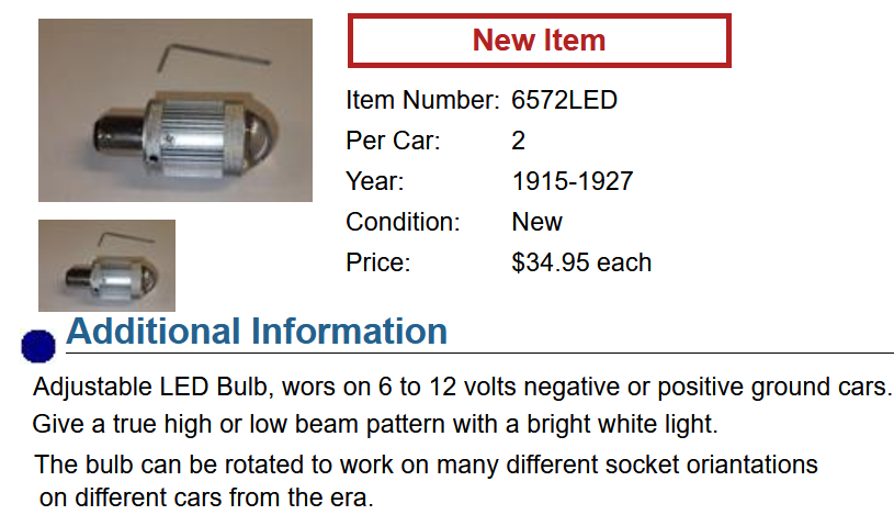

Now if its still dull and you don't care much about originality these LEDs are self focused and contain their own reflector. A best solution for night driving

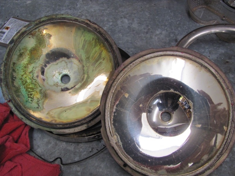

Absolutely the reflectors can be brought back! There are some great products to use that will work pretty well. Ace hardware has silver polishing cloths, silver cleaning soft paste that will surprise you. In my experience my 24 Coupe and 1919 Roadsters reflectors were a dark green and after reading the forum about repolishing they came about 95% good. Chrome reflectors aren’t near as bright as the silver plated original.
Of course condition is important and some are better than others. Good luck.

My reflectors were reletively tarnished, and with a microfiber towl and polish, they look real nice now. Also, polishing leaves a residue that can be hard to get off for paint to stick. The glossiest of paints will not compare with a decent polish job on bare metal.

If the LED headlight bulbs with their own reflectors mentioned in another post work well, you will not need to have perfect reflectors. They are not cheap, but neither is replating original reflectors.

Or get these: https://www.modeltford.com/item/6590BQ.aspx
