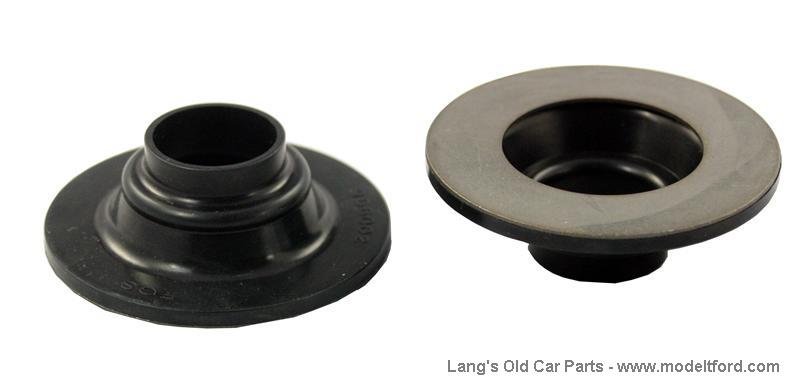

I purchased an "extensively restored" T last fall. It's been driving me crazy ever since. What was done / replaced? What wasn't? I've come across several short cuts. Anyway, the outer bearings seem to be leaking quite a bit. first off it's a '14 and the rear end was filled to the plug opening, so I removed some of the oil and hope it isn't filling up coming from the engine. I wondered if there were axle seals put on the inboard side of the bearing. I pulled them and noticed there were what seems to be noeprene seals, but don't have the slight bell shape like the ones listed in the catalog. They seem to be a flat disk encased in metal with a small lip where nit meets the axle. I seem to remember a redesign of these seals somewhere in the past. was their an issue with this design? should I replace them? These probably only have 100 miles on them. Also, I don't know if they were put in using a littlt Permatex. How do you (can you?) remove them without damaging them?

If I am reading your post correctly the metal seals you have sealed around the axle shaft but not around the outer diameter where it meets the steel rivet ring. As the axle wore and moved off center the rubber lip also started to leak. The seals pictured in your post were an improvement designed to seal around the axle and at the rivet ring. I put those in two rear ends, seem to be working.

Would be interesting to know if they are still intact. The seals you show fit too tight on the axle & tend to shred themselves. I put them in a lathe on a stub axle & cut off that 3/8" band , cutting down the center of the bead. Check that the washer is fully bonded to the seal.
I did recently find some of those seals with a much shorter band, about 1/8" as opposed to 3/8" They might survive without modification. Havent tried to use them yet.
