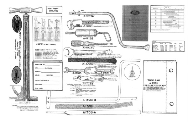

For the supplied car tools, Parts and Price list booklets for Model T picture those tools and most have the factory number embossed on the tool to to identify, generally if the tool is marked ‘Ford USA’ that is a Model A tool. Model A Club nat’l has nice guideline listing the car tools for the Model A.
Image 5-27-24 at 1.41 PM.jpeg (32.46 KiB) Viewed 1968 times
