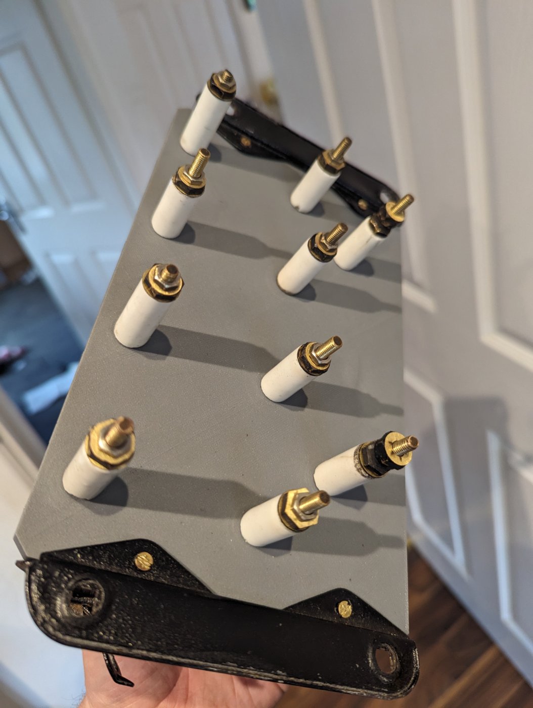

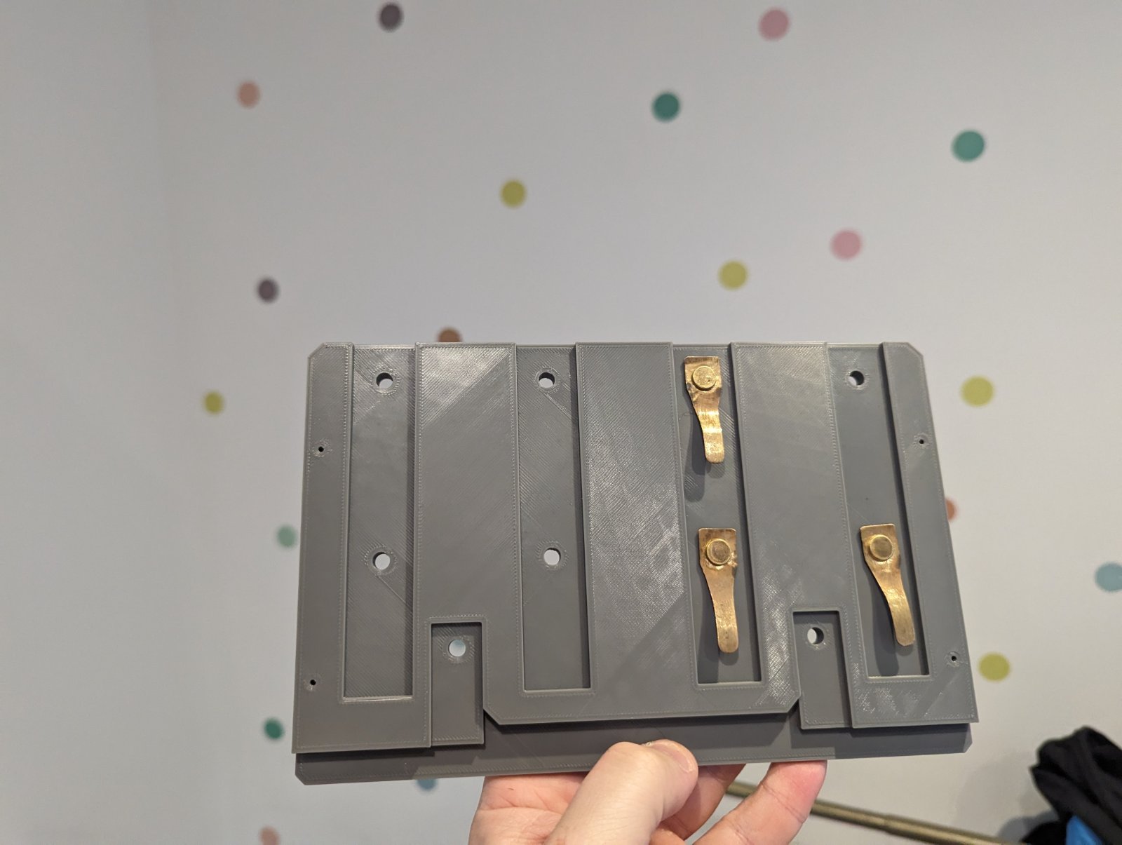

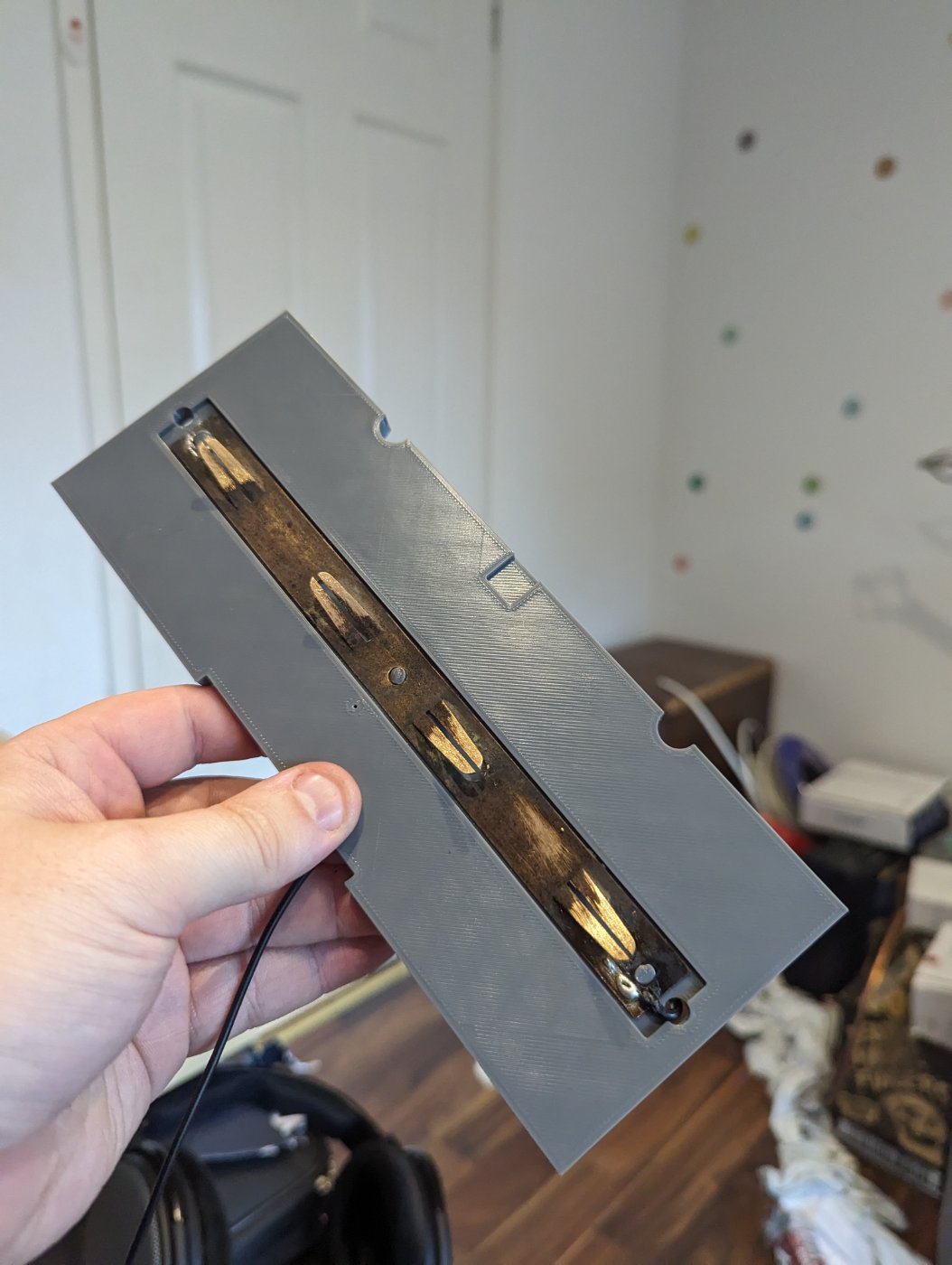

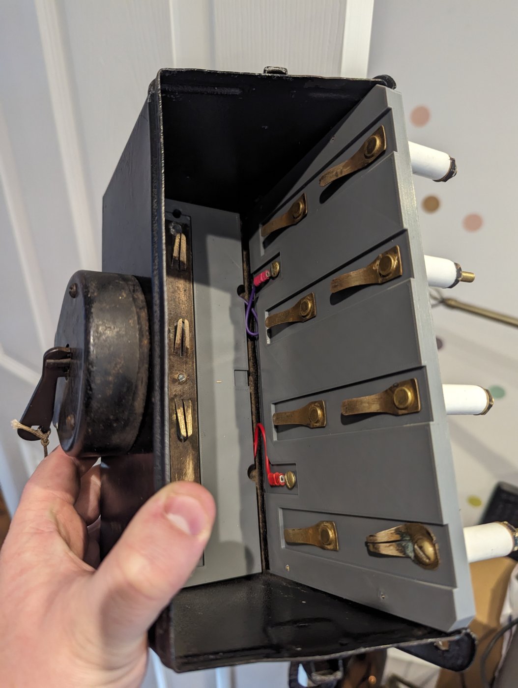

We were out with the T the other day for a local car show and it rained hard in the afternoon.
On the drive down the car was behaving very well (best it's ran in a long time)
But after the rain we went to start it up and nothing.... Would not start. But what it would do was send a very noticeable shock through my hands whenever I touched the key or the handbrake .....
I read online that it's quite common for the coils to short through the wood in the coil box when wet (especially with carbon build up)
So I decided to print a new back and base for the coil box (pictures below) in some PETG. Would anyone else find the STL files helpful? (Do note that these where made using the old box we had as a template, and I have no idea how close this was to stock.)

While I love 3d printing and have made many prints but in this application I have some concerns.
Over the years I have discovered that most 3d printing is porous (leaky).
They will fail vacuum leak tests, weap chemicals when plating, and not hold pressure. When installed on a vacuum leak tester it will suck liquids through the plastic parts. Cool to watch but not good if it is supposed to seal.
There are ways to seal 3d printed parts but you have to know that it is needed to be done.
If it is properly sealed it should work fine.
I make my own waterproof parts for my cars out of solid plastic pieces. I have been caught in some terrible rain storms forcing me to pull over due to flooding. See my MTFCI Hamilton Ohio tour picture if you want proof. The car ran fine and did not miss a beat.
I recommend every driver car be retrofitted with waterproof box parts. It is no fun to break down due to wet coil box wood.

I can see your point around 3D printed parts not being totally water tight, however in this case it's just to improve on the old wooden box. Main advantage here is that its far less likely to absorb water from a quick downpour than the wood.Mike Silbert wrote: ↑Thu May 30, 2024 2:36 pmWhile I love 3d printing and have made many prints but in this application I have some concerns.
Happy Motoring
If you exposed the printed parts to enough water then it could fail, but I suspect at that point water would have passed through the mounting screws ect before the printed part becomes an issue.
The best option I guess at that point is to seal everything up so water never gets anywhere near the HT side of things

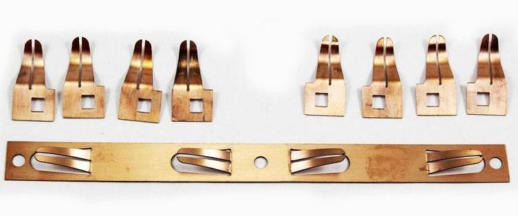

If you can find a period made coil box, save those internal contacts. Clean them up and put them in your new application. The original contacts were made of a better metal that held tension a lot better than what's being put out today.

While 3D printers are amazing innovations the surface of the product they make is composed of hundreds of rough layers. Maybe one day amateur 3D printers will evolve to a point where they produce finished products with a smooth surface like it should be.
Regarding the coil box parts featured here, I think it could be made waterproof with a coat of polyurethane or POR 15. Jim Patrick

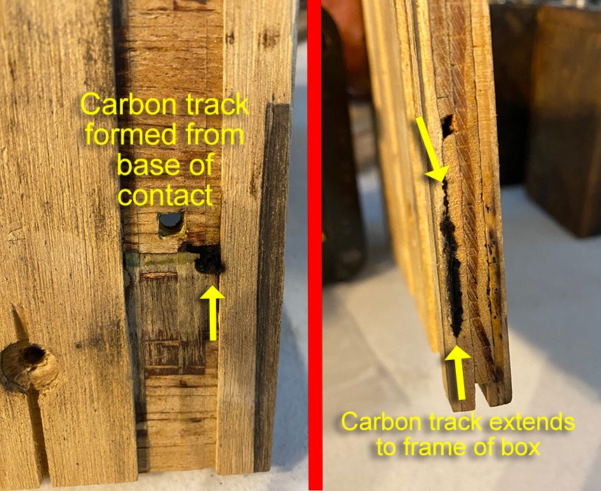

We've had a couple of instances in our club of sputtering cars due to water infiltrating the coil box. While the plastic replacement kits available from the vendors may not be quite as polished as the ones sold years ago by Fun Products, they do the job. Re-use your contacts if you can. If you need to replace them, the two main vendors sell contacts of different quality so you should check them out before ordering. You want the ones that look like this. They're closest to the originals. If your contacts have lost their "spring" you might try what I and a couple of other fellows have done.....Double them up! Blasphemy I know, but it works....problem solved.
A friend replaces coil box wood with a material designed for outdoor signs. Me, I'd just get the plastic box kit. When putting it together, be sure all wires and connections are well insulated from the metal box. We've had two instances recently of bottom wires shorting that way. It's also a good idea to solder the contacts to the bolts that run thru the insulators. Speaking of which, we recently had trouble on a tour with one of our cars because the nuts holding two of the insulators were loose. Tightened up and the car ran fine.
The attached photo shows carbon traces on the wood of a coil box from a '22. Got wet and never worked properly again.
