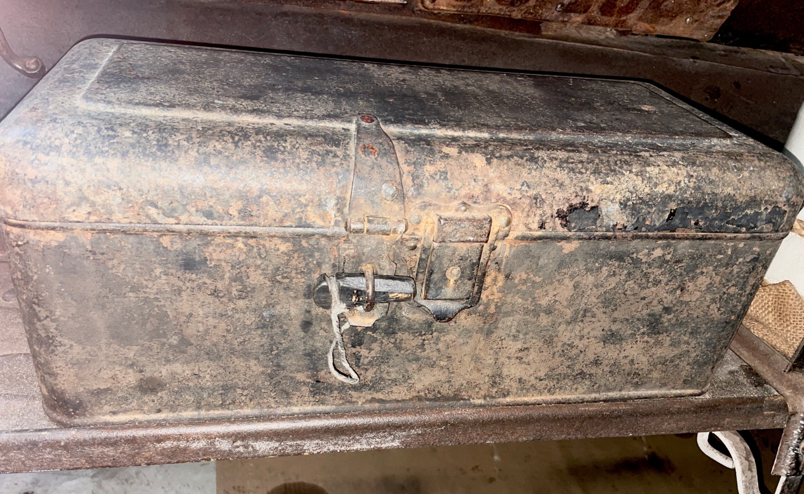

Does anyone have a Yale running board toolbox that looks similar to this? I am trying to determine if the top of the lid is supposed to be flat, or have a bow or crown in the outward direction. Mine is dented, and I want to make it right.
Thank you,
Joshua

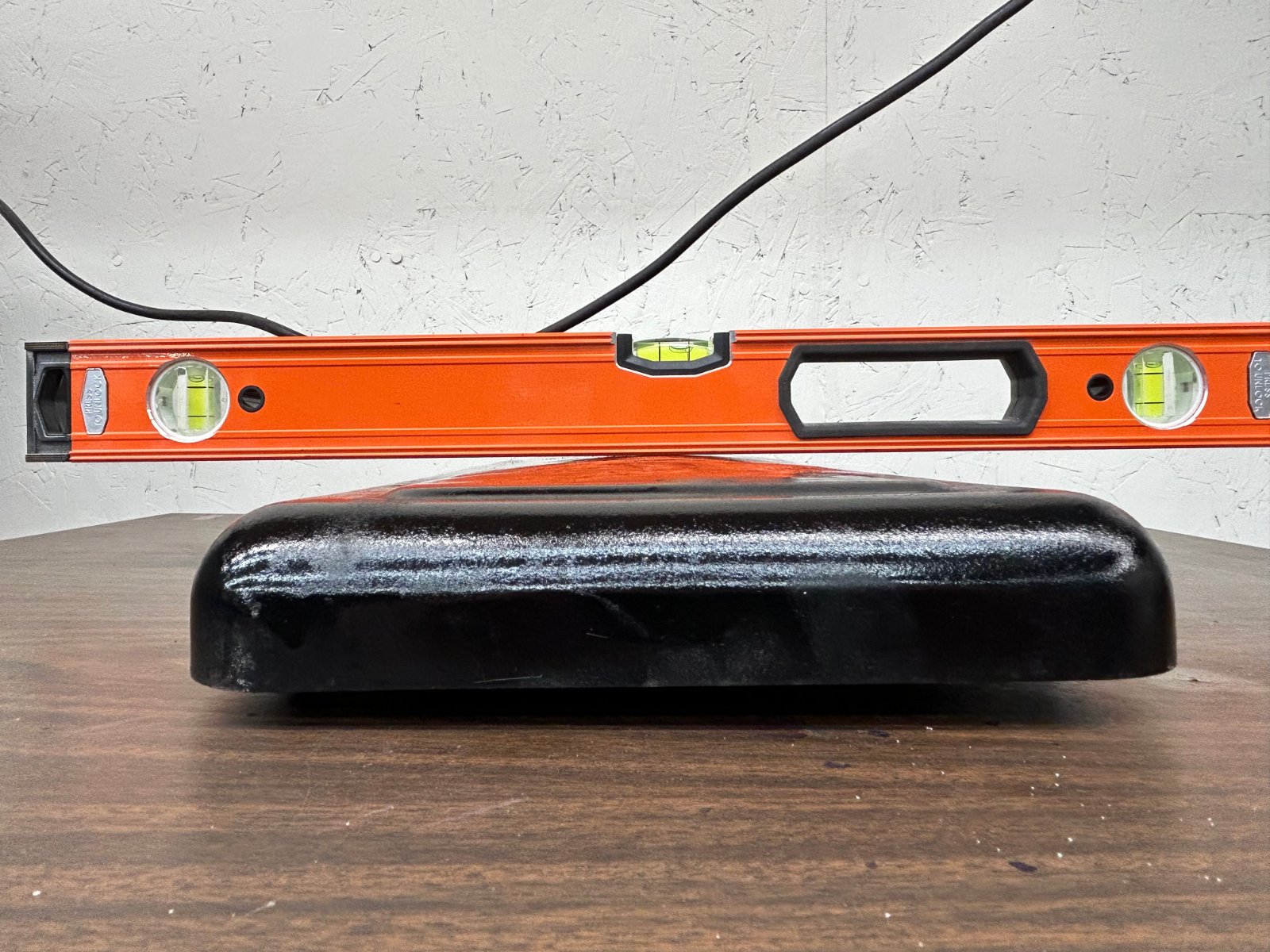

Thanks Jack. I am interested to see what others say too. I just took pictures of the lid, and the "crown" on mine does not look symmetric.

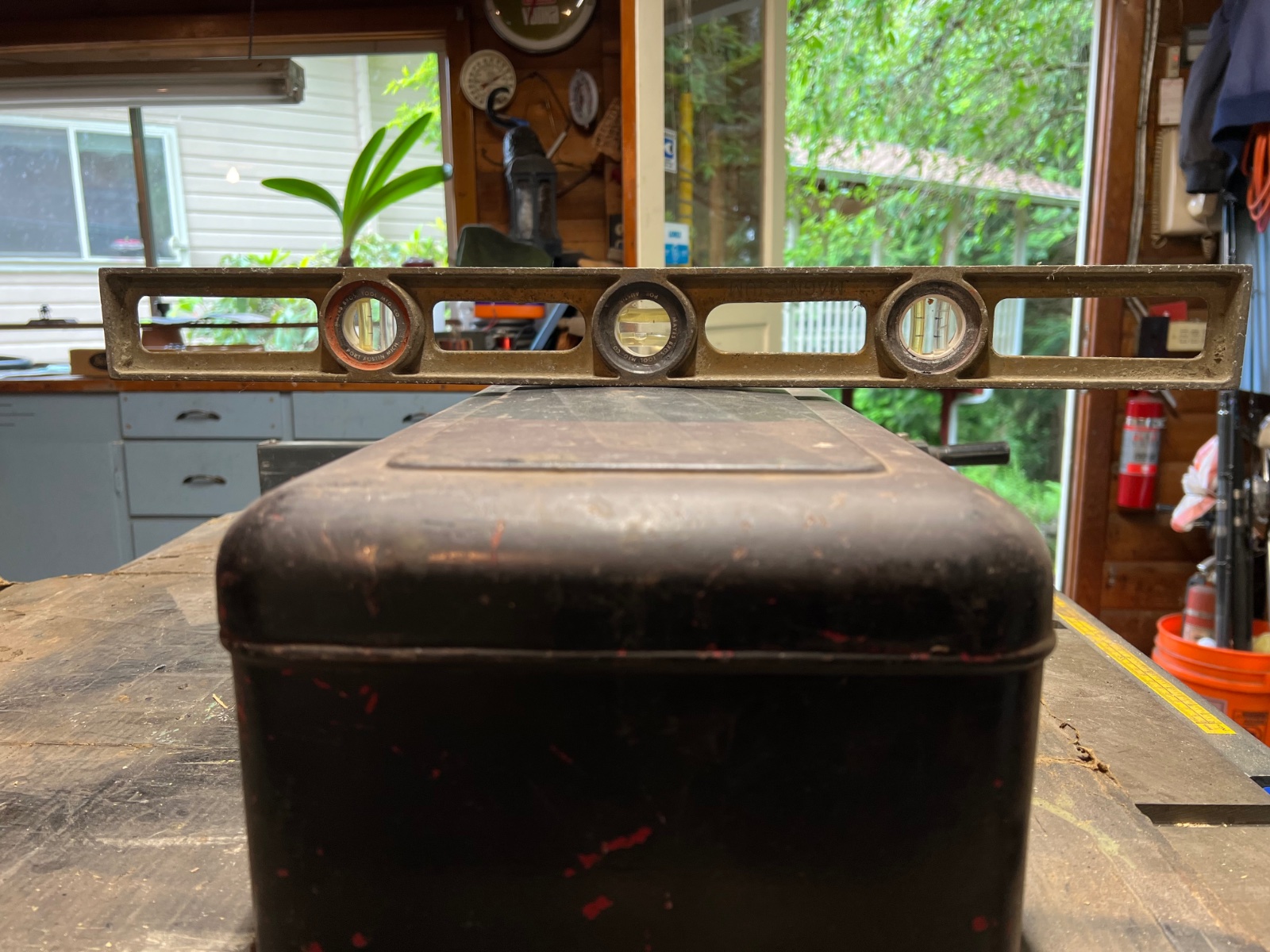

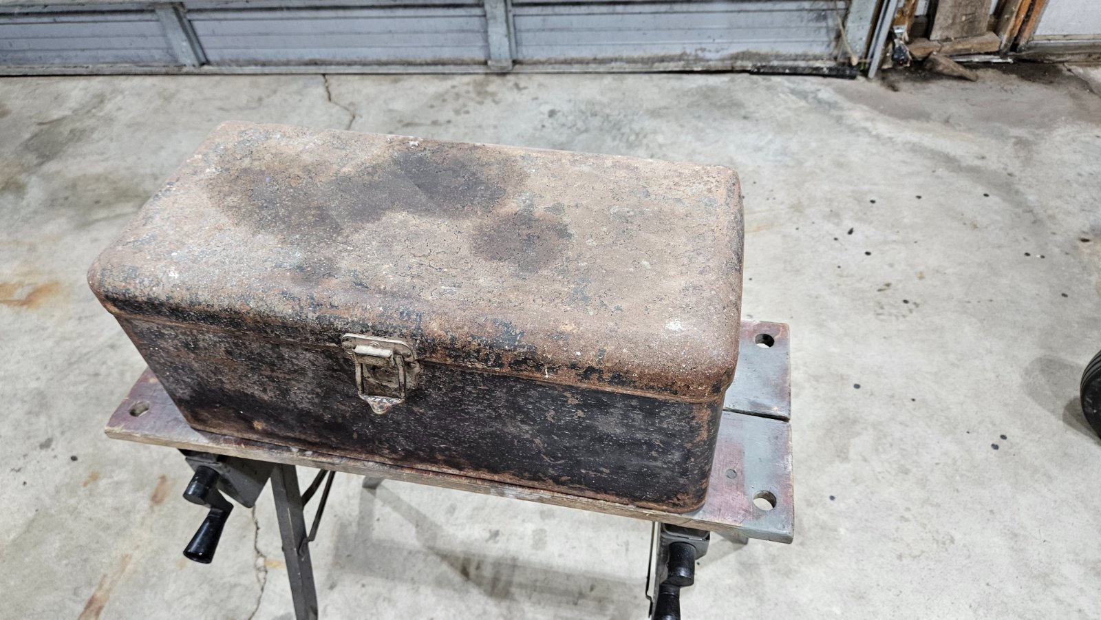

Slight crown even though this box has been sat on, stepped on, and had stuff piled on top in storage.

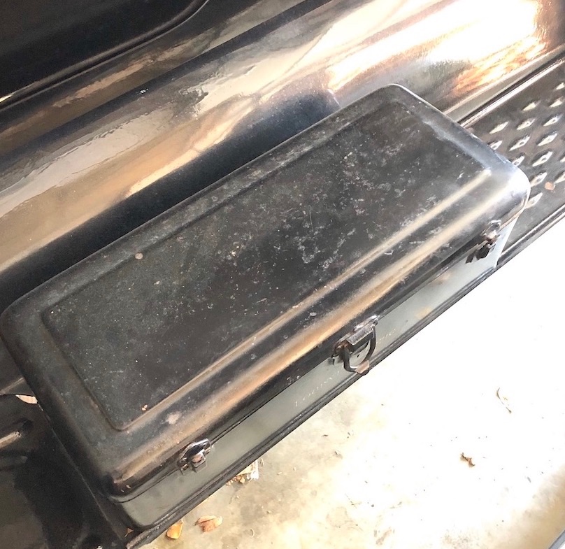

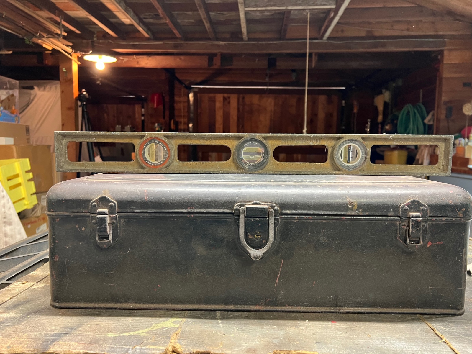

My box is flat on top, rather think they all were mostly flat. Many makers, and the size for the Ford should be 9" width, so the box won't hang off the running board edge.
Now for those long lost tool box latch keys.......well just add a hasp and your own lock. Or just a whittled wood stick to jam in the latch to keep it closed :lol:

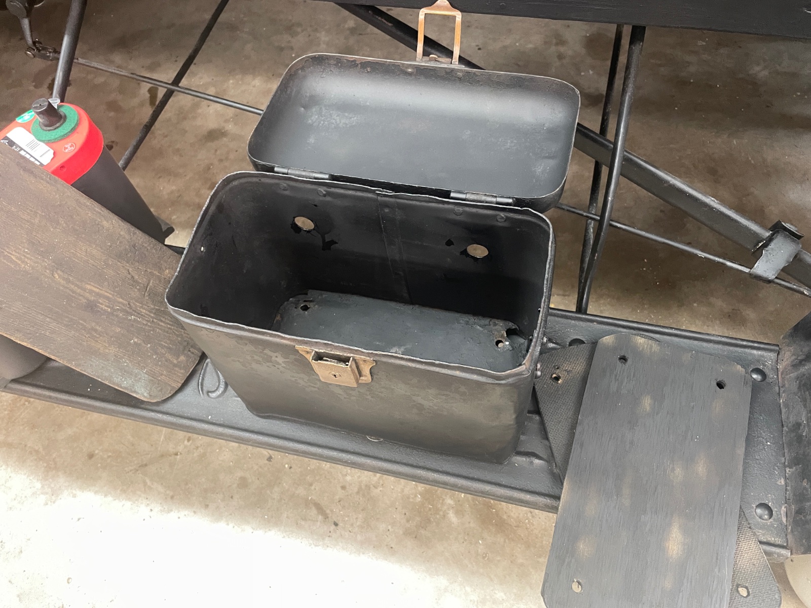

Tried to make a similar key for my running board battery box with lock, but the lock tang had been busted out, so no way to lock, at least the latch holds it closed.

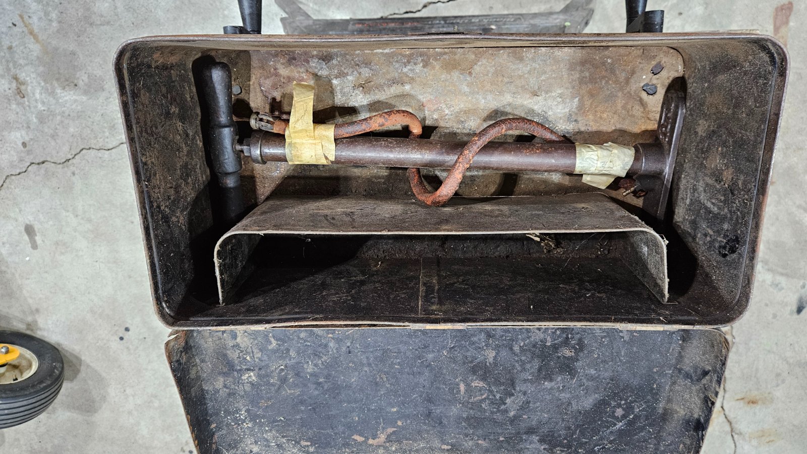

My box has a Perfection Lift Lock. Clasp. The box has a flat top. It also has a seperate compartment in the back. The shape is perfect to fit a Ford tire pump. I have never seen another with the separate compartment.
