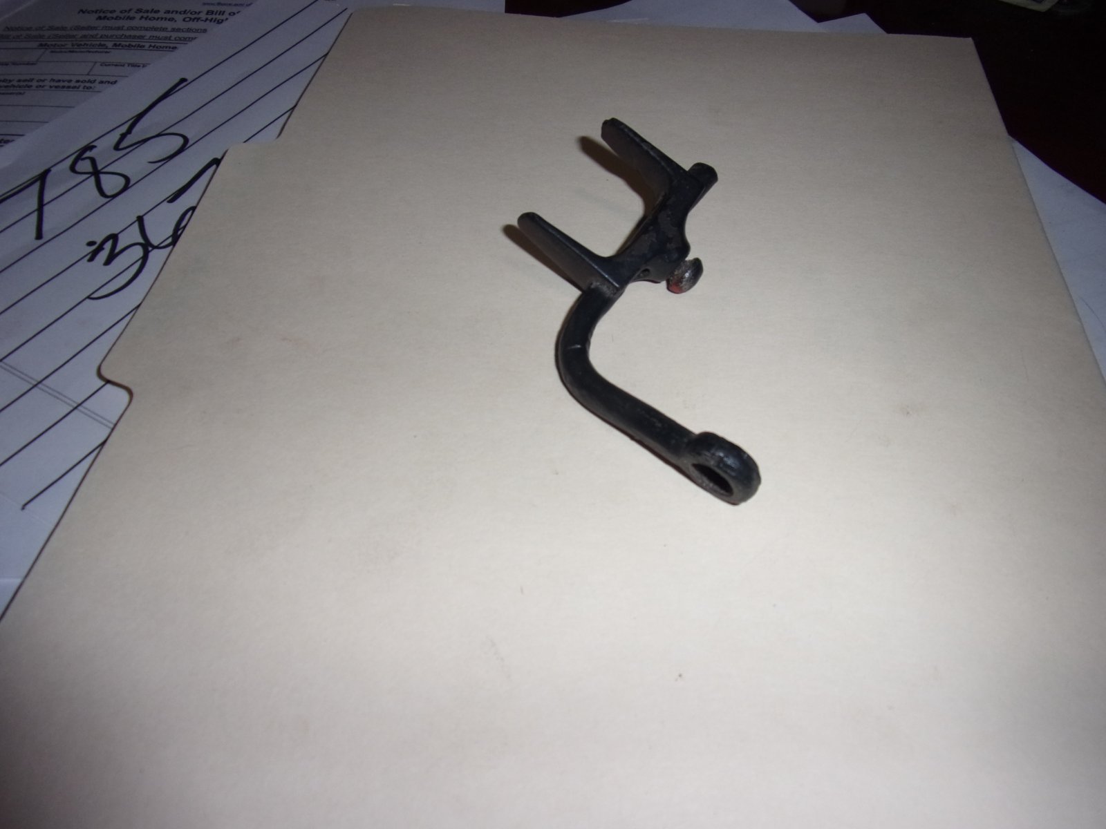

Cleaning up the parts shelf and totes today and this one has me stymied. Could be T, TT military vehicle or refrigerator ice maker.
I'll hang up and listen. And, if it gets ID'd and anyone needs it, I don't.

A couple of photos with scale would help. Looks to me to be a fan belt guide, but kind of hard to tell the exact size.

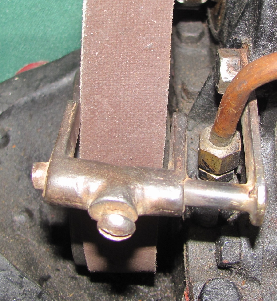

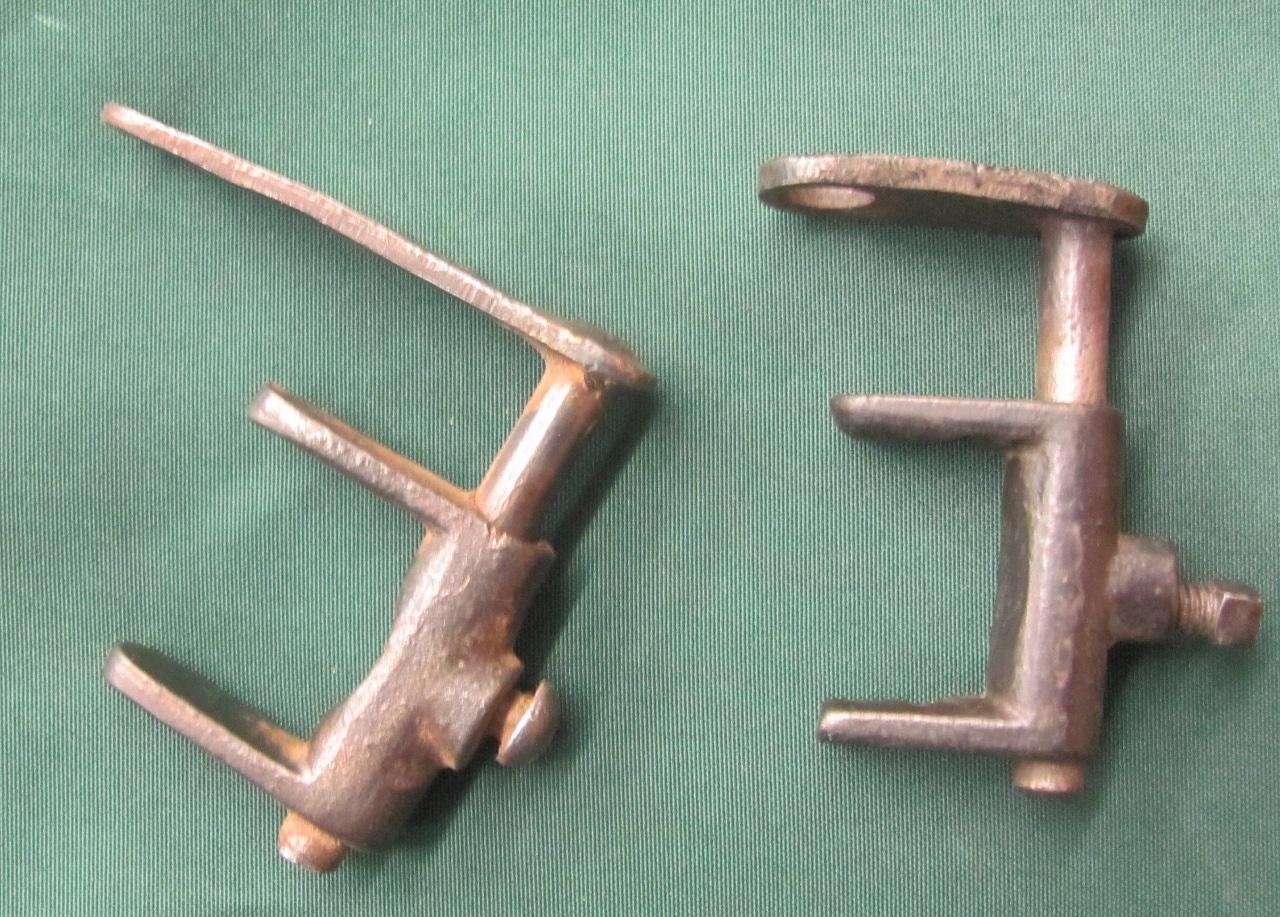

Yep, agree, you nailed it, an accessory fan belt guide to keep the flat belt on the fan and crank pulley.

Yes. It is a fan belt guide that straddles the fan belt and keeps the belt centered on the pulley, preventing the belt from going to and fro on the pulley. My 1926 coupe had a very rusted and pitted one on it when I bought it in 1970. The parts places sell a modern version of this from their inventory. The one in the picture is sold by Snyder’s. Jim Patrick

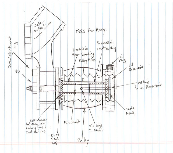

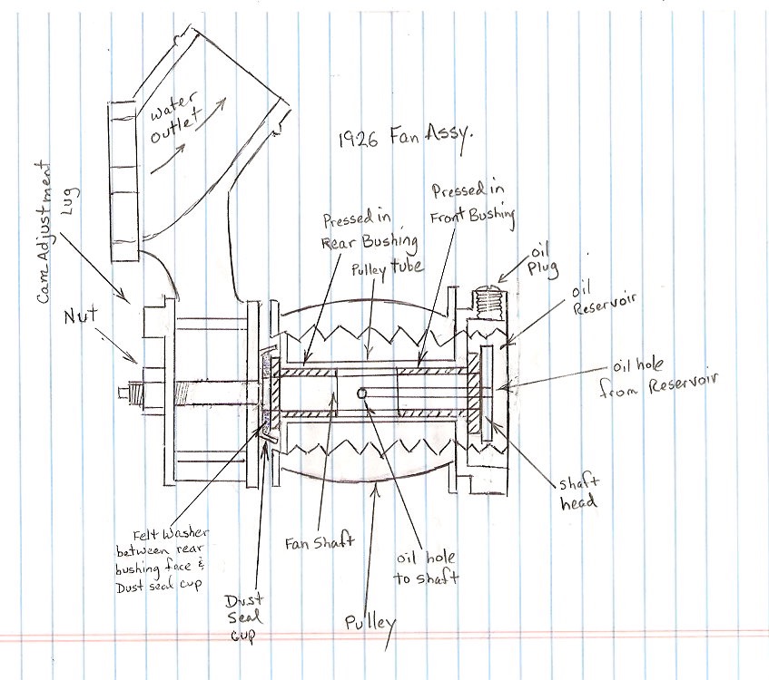

The fan pulley is convex with the widest part at the center so the belt is supposed to seek the widest part of the pulley and stay centered, but if the pulley has been worn flat, or the fan bushing or shaft is worn or bent, causing the fan to dip down, your guide is useful to help keep the belt centered on the pulley, even if it frays the edge of the belt. This drawing is of the 1926-27 fans assembly but you can see how the pulley is convex.
Note: If your fan assembly suffers from any of the problems listed above, the problems should be repaired instead of remedied using this contraption. Jim Patrick
