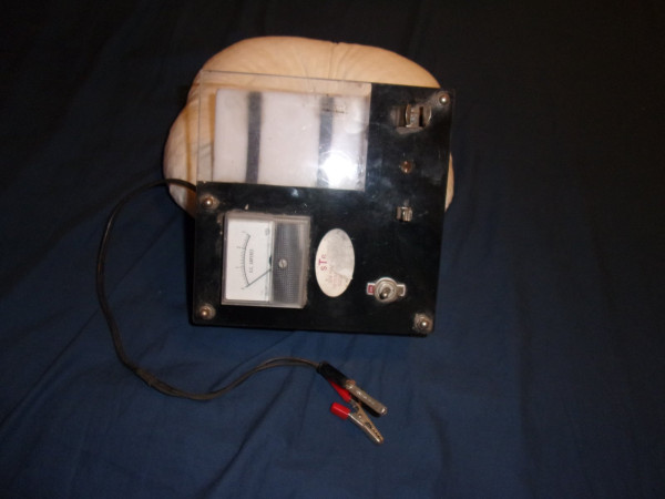

Picked this up at garage sale today for $1, so no big investment if it isn't what I think it is. Sure looks to be a buzz box tester. Google search for STS coil tester brings up an old listing for Mac's sellit it as a Model T coil tester, but Mac's is gone and the link does not upgrade to Eklers so I'm presuming this product is no longer being built or sold.
Anyone seen one of these? Anyone have one? And, more importantly...anyone have the instructions for one?
It appears to hook up to a xic volt battery, but don't know what the two fuse clip looking things are for. Spark plug?

It is a Buzz Box Coil Tester.
Not an appropriate test device for Model T Ford ignition coils.

That box will tell you if a coil is bad when you see no sparks in the small hole.
The box cannot tell you if the coil has random misfires.
The box will also test spark plugs if you have a good coil to be tested at that time.
Those two little clips simulate the spark plug leads.
Those boxes come in two sizes, the larger coil size prior to 1912 can be tested in an earlier box.
Stafford is the name of the company that made and sold those boxes.

Do the battery leads clip onto a 6v car battery? Or a smaller 6v dry cell lantern battery?
Is the buzz box tester just a pass/fail? It sparks or it doesn't? Or is there a way to use this to find a matched set of coils?
I'm thinking $1 was about the right price.

The leads connect to a 6V car battery. An alkaline 6V lantern battery can also be used for short term use. I wouldn't recommend a cheaper carbon zinc battery in view of the current draw, although it will work to a degree if the battery is particularly fresh. Once the contact gaps are set, the coil vibrator tension is adjusted so the meter shows 1.3A.
It can be used for a pass/fail test in that the coil buzzes and sparks, and can be used to set a coil so the car is drivable, but will not provide the adjustment necessary for optimim smooth running, particularly for magneto operation.
It's the kind of thing to keep under the seat for emergencies, but not as an instrument to provide best possible performance.
And it's definitely not suitable for finding matched coils since it cannot show firing characteristics of the coil.

So if I adjust 4 coils so they all read 1/3 on the gauge and they fire a plug, it's better than nothing, correct? Like you mentioned, something to use in an emergency or for an initial start after a restoration, but that further testing would be need for optimum performance. When I slowly crank my engine over after sitting for several years and working on a restoration in progress, I can hear all four boxes buzz, but all at a very different pitch. I was under the impression that they should all sound close to each other in buzz pitch. Perhaps not an accurate observation. So putting the coils on this contraption and connecting to the 6v car battery will tell me something I don't know now, I presume.
And that I should see the same color spark on four spark plugs if they are set correctly and using the same buzz box as a test bench.
I might as well play with it to get my $1 worth out of it.

Yes, better than nothing.
It wont detect double sparking.
It wont lead you to the correct adjustment for that even "clack"
It will give you even amp draws & by watching the meter jump/wiggle detect some inconsistencies.

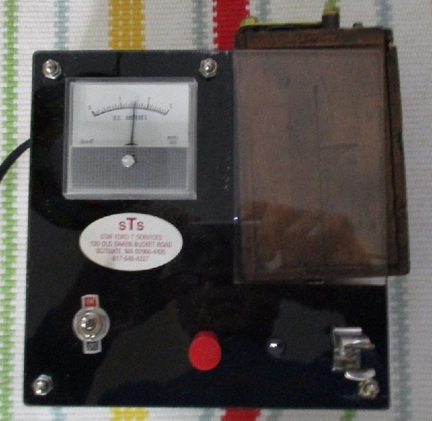

That STS is designed for the early coils and has the bottom coil connection slightly to the right.
So, the newer coils have to be set slightly off straight or the test set appears not to work.
You can see the col sparks coming of the termina and in the small window to the right of the red spark plug connector for testing those.
