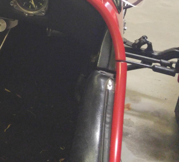

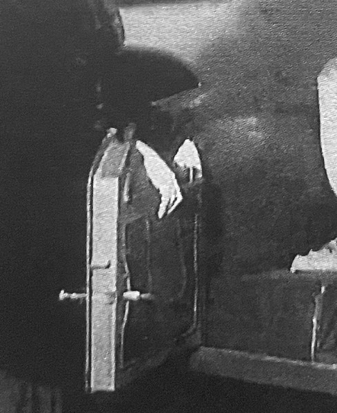

That's the way I would expect it to look. If you look at the framing though (see photo), there is no solid edge running along the curved top edge. You'll end up with a gap that needs to be filled in somehow.

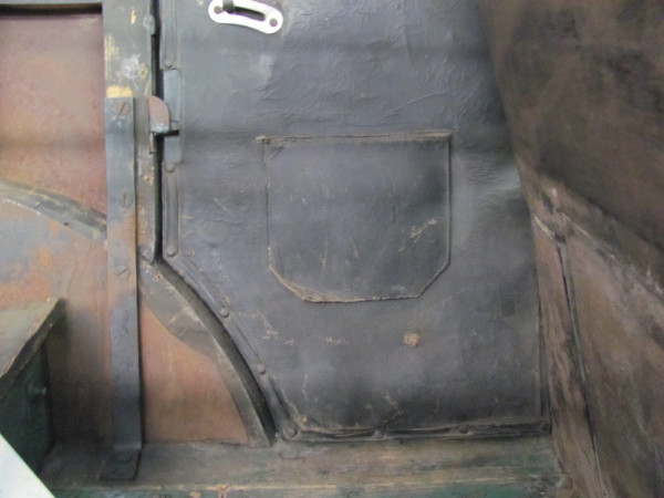

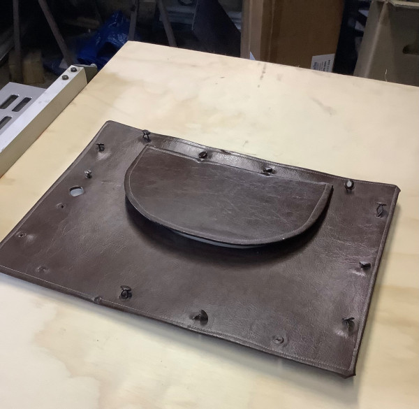

Similar to the above photo, my Mercury had a door card with an access flap. It only went up to the horizontal brace and uses the door cavity as a glove box. I probably won’t get to the upholstery until winter.
Andy
Andy

Thanks Dan. The welt covers the gap but it seems like there must be a tack strip or something underneath it. My photo of Bud Voth's door is similar to Mike Bender's. There's nothing to attach the welt to.

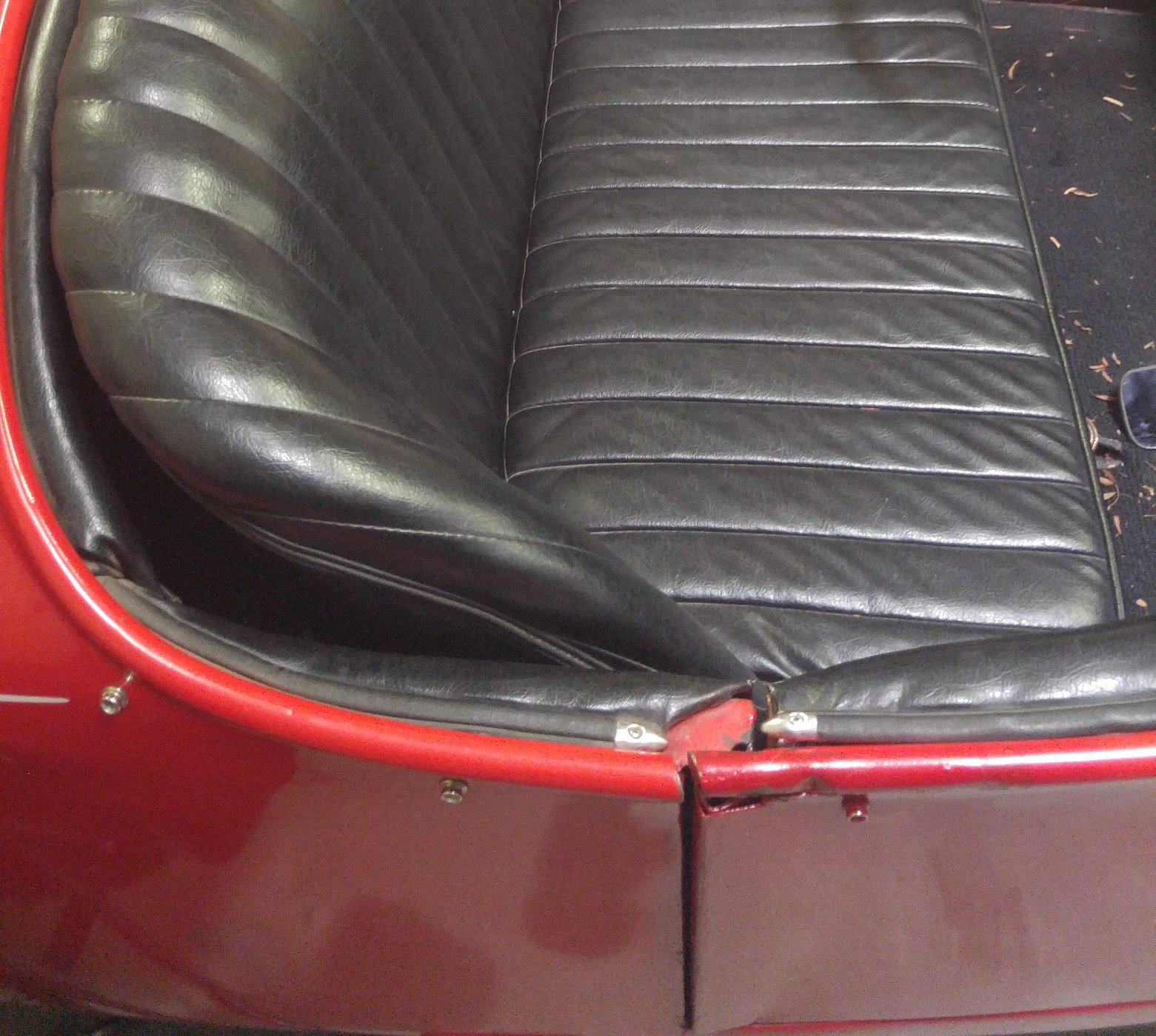

Here we have a photo of the ex-Harrah Mercury. Note the "hide em welt" as used on Model A tops.

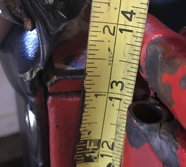

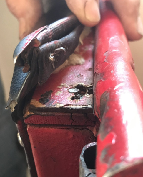

We took another look at the door trim on the Merc. The metal trim tabs on the ends of the hidem are held in place with oval head machine screws. They look to be 6-32 thread and it appears the top of the door is tapped to hold the screw. Under the hidem and fabric for the door liner is a strip of 1/4" thick wood that is attached to the top steel framework of the door. Not sure how this is attached to the door frame- perhaps a few countersunk head screws along the length. On top of this wood strip is glued a strip of 1/8" thick dense cardboard about 1" wide. This may have been a shim that was added to raise the edge of the door trim- not sure. There are tacks holding the fabric and hidem driven into this wood strip. No idea how original this is, but this is one example. Hope the pictures help.

This group of photos shows how we are influenced by those who built/restored our car before us. The early photo show at least a partial filling to the top of the door. But the horizontal brace is exposed. My car has a doo card that goes from the bottom to the top of the horizontal brace. As it is held in by mid 60’s Ford door panel fasteners I would doubt it’s authenticity. The McEachern and Harrah’s cars have full coverage to the top. Given the weight Harrah’s good name Dan’s car may have been influenced by their work. I think to get to the bottom of this we would have to hope Jarvis or maybe Mike Penserini might have a better original photo.
Andy
Andy
