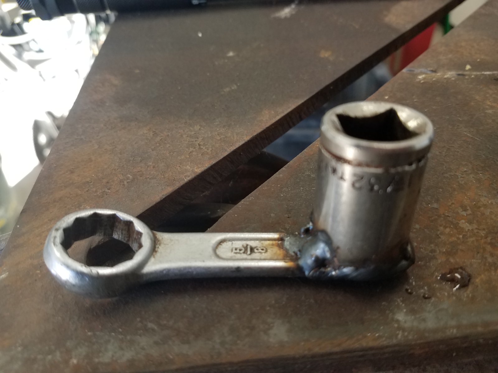

Post by ernieh247 » Tue Jun 04, 2024 8:55 am
I built my own from a box of miscellaneous tools. I verified that the torque was correct.
