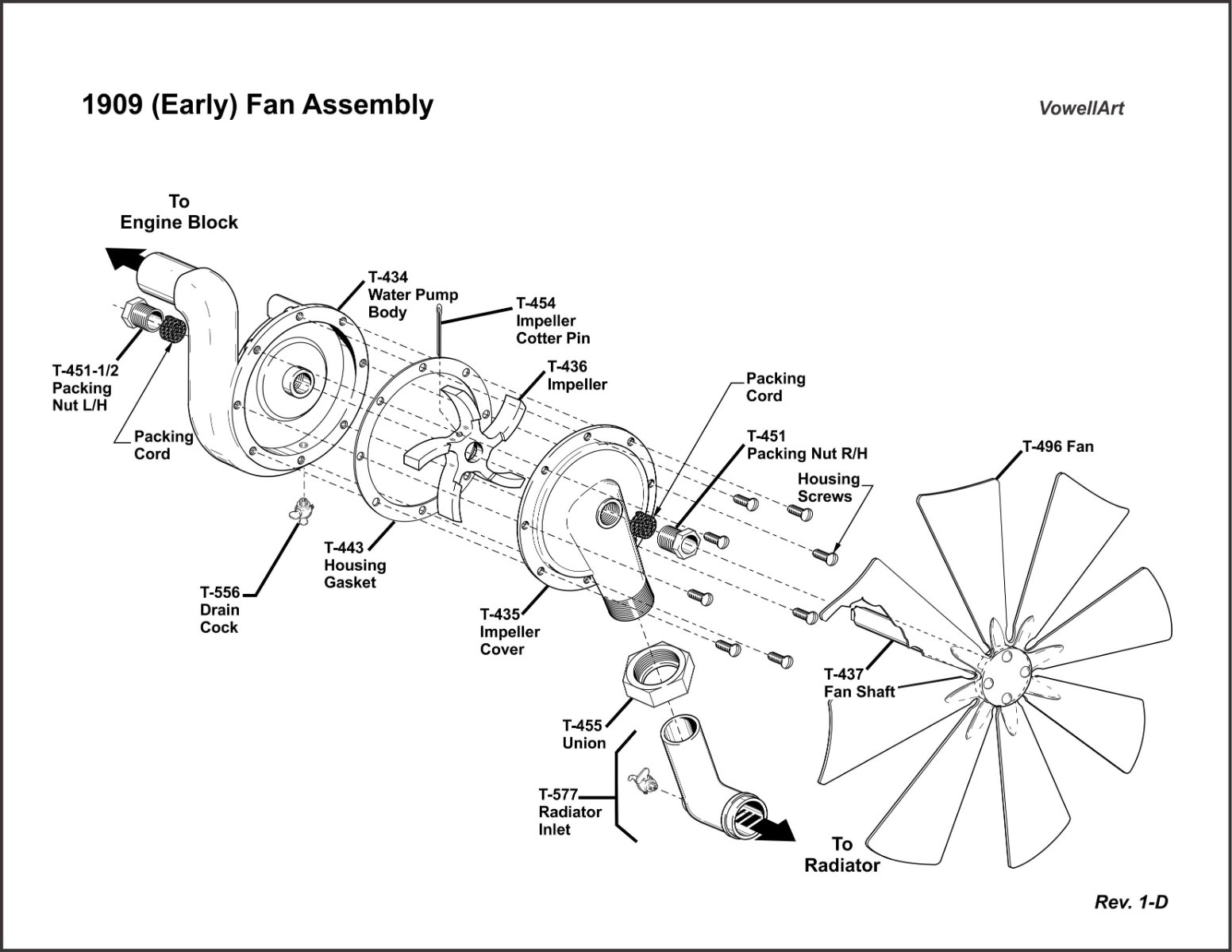

Made a revision to the 1909 water pump drawing and also added the mounting of the water pump to the 1909 engine. This was a fun one and really out of what we all consider the norm for Model T, in that this engine block is really very different from any of ours and the head also (didn't draw the head, but will cover the engine more thoroughly when I do it's assembly).
First up, the revised Water Pump drawing. I found (scouring Bruce's Factory Number lists and then double checking that with Fords parts pictorials and parts lists), part numbers, well more correctly Ford Factory Part Numbers.
I thought about putting the vendor part numbers in too, but then since no modern day vendor sells any of these parts (with the exception of P/N 577 which Langs sells), didn't think the vendor numbers would be worth including.
