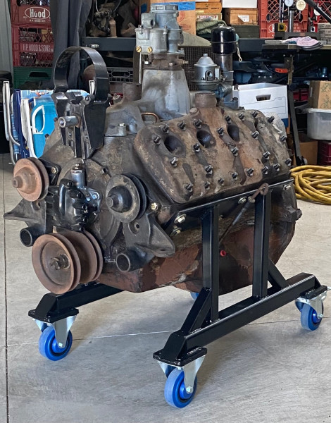

Re: Engine cradle
Craig - a quick internet search show a couple types of flathead cradles. If you weld they are a simple fabrication project. I made mine out of some 3/8” steel plate and scrap square tube - with ACE Hardware casters. For any pre-8BA flattie, I use the exhaust flange for my engine stand adapter and cradle attaching points to avoid potentially cracking the early cast-in bell housing.
