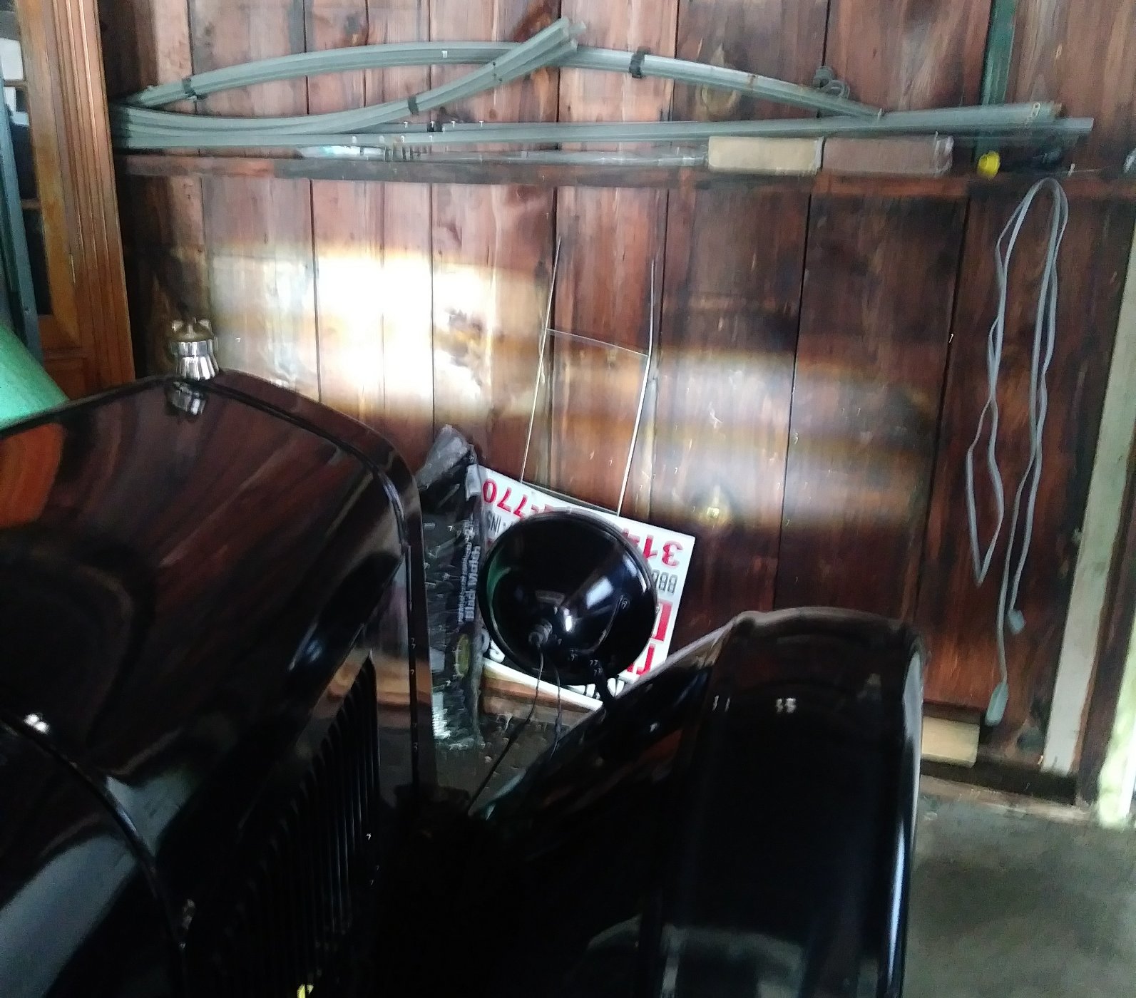

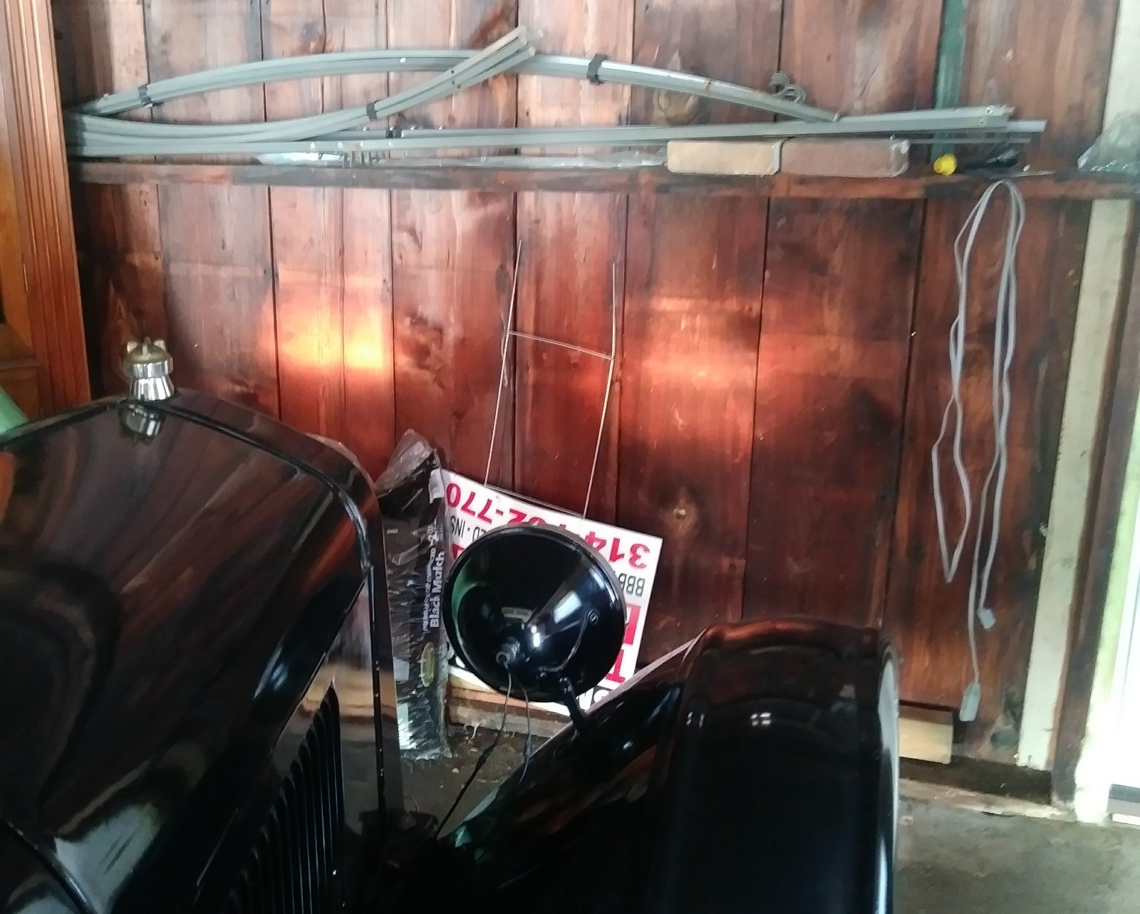

Installed the new logos led bulbs today. They are definitely brighter. I went for a drive at dusk and could actually see that my lights were on. Here in the city, it's hard to find a truly dark road, I will have to wait till I go to the country for that, but so far I'm satisfied. Best part is I can now drive at night without discharging my battery. Thank you Paul Shinn for the excellent assessment video. (And Robert for posting it here) I would not have spent $100.00 on bulbs without knowing what to expect.

Looking good John. Strange that the two original bulbs lit up at the same height, but with the LED's the left one points higher. Can their orientation be altered by rotating them through 180 degrees? Otherwise you may need to tweek the headlight stalk for optimum direction of the beam.

The bulbs are prefocused and have a mark that must be oriented to be at the top. I tried rotating the connection at the back of the bucket 180 degrees but that changed it from low to high beam. Maybe moving the bulb with the focusing screw will tweek it a little, otherwise the stem will have to be bent a little.

Actually the left headlight beam would be better on the right side to illuminate the side of the road, while the right beam would be better on the left to reduce glare to on coming drivers

Yes, I would have been happy with that. I tried swapping bulbs, it's the same. It's the angle of the buckets. I will tinker with it more yet.

Just a note: The "self focusing" bulb eliminates the need to adjust the bulb to the focal point of the reflector, hence the original reflector is not contributing. The fluted lens, or what ever lens is there, is what focuses the left shining through it.
Check the clarity of the right lens as well

Good morning, JohnM ..... Nice pictures, were the lenses replaced before you took the pictures?

Yes, on both pictures the glass lens were in place.

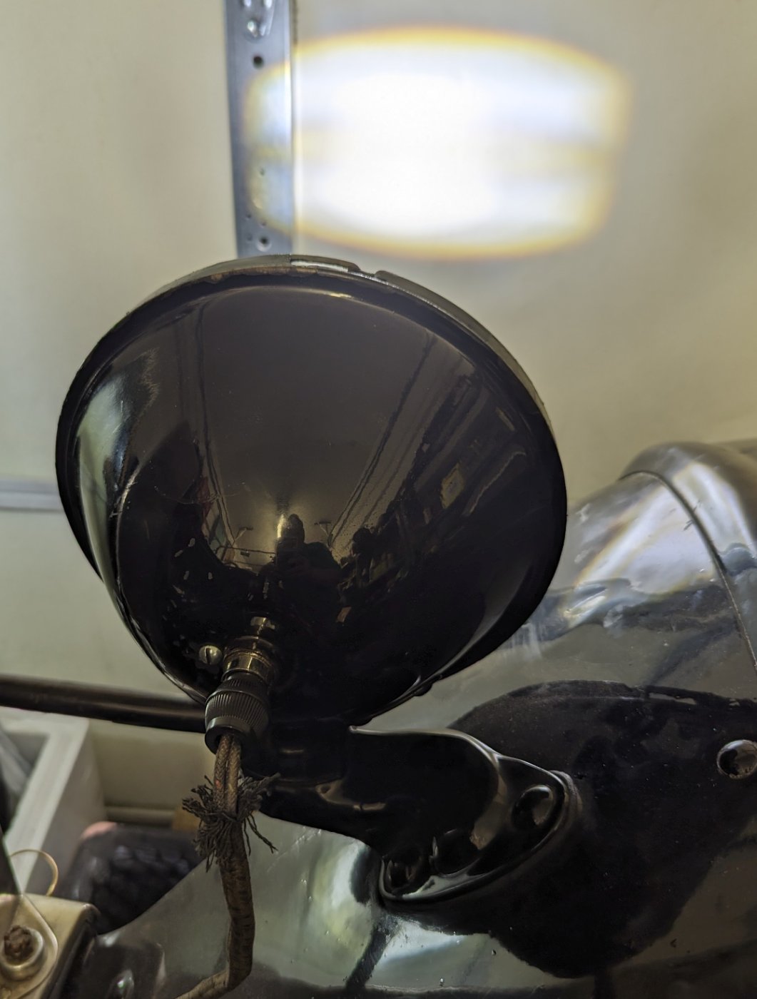

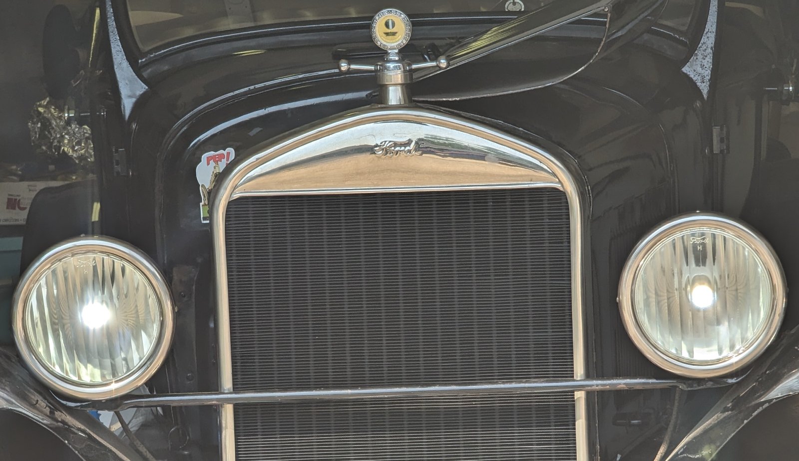

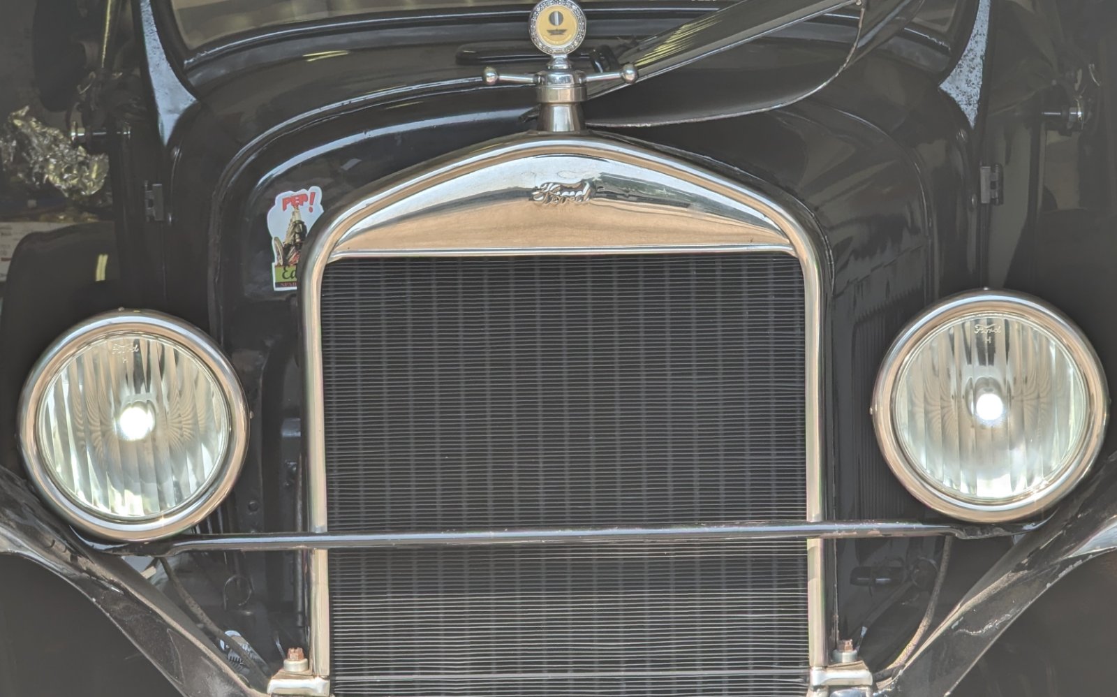

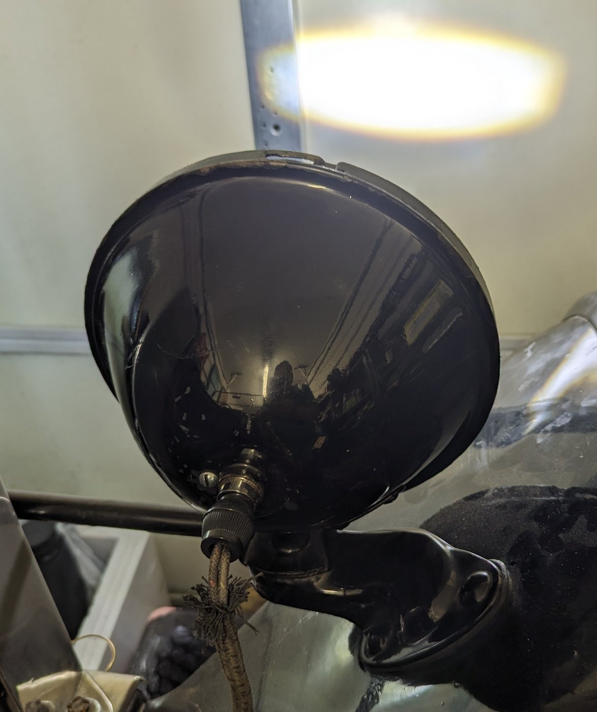

I found time this morning to install these headlamps in my ' 26 this morning.... Each sealed packet has the light bulb and a small allen wrench to adjust the position. Installed the passenger headlight bulb, turned on dim, and noticed the bright setting was lit. Removed the bulb, used the Allen wrench to loosen the two set screws, turned the bulb housing 180° and snugged up the set screws. Installed in bucket. Turned lights on dim, and noticed the light projected a slight slant to the left . Removed and readjusted for a horizontal projection. Did the same with the driver side light. I am very happy with what I bought, and verry appreciative to come across that video and share with you. I am not a paid sponsor of LOGOLITES, just a very satisfied past customer of other LEDs they sell . Hint- Hint .... They do have extra bright LED stop lights.

Added more pictures
