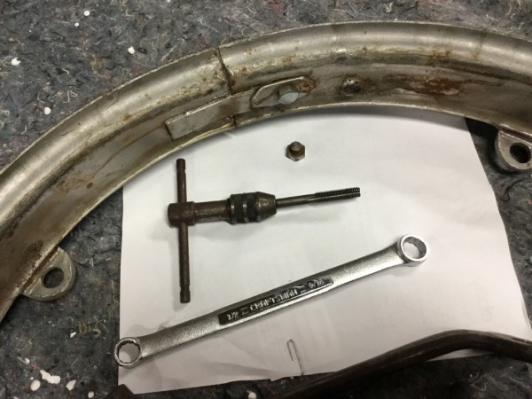

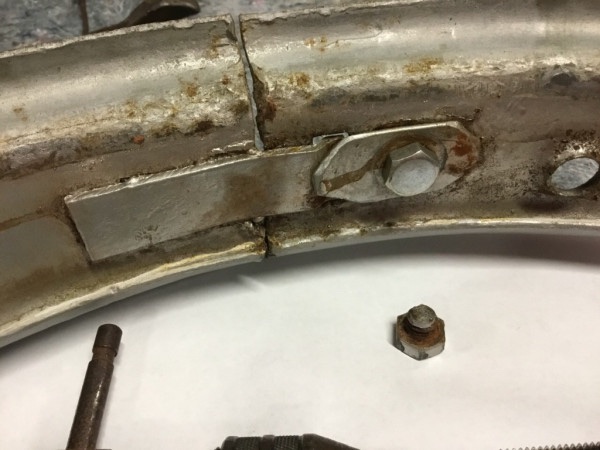

Purchased a decent split rim, refinished it and upon assembly, we stripped the bolt that holds the split rim together.
Has this happened to anyone and what is the solution?
This was the last step before reassembly and putting on the car.

You could tap new threads and use a new bolt.
You would need to remove your tire tube and flap before you did that or flip that portion of the rim off To ensure you did not get any metal shavings in inside your tire.

If you can drill ( may not be necessary) & tap to the next size that will work. You may have to cut down the head of the bolt for clearance.
That would be the easiest. Or you can remove the nut, machine a new one of a better grade & weld into the hole judging by the saw or
grinder marks this is not the first time for that nut. Either way make sure the bolt does not stick out of the nut enough to puncture the tube.

That bolt doesn't really hold much. It really doesn't even need to be there once the tire is aired up.
Was your bolt an original? Or a new one? If the bolt was old and worn, maybe a new bolt with fresh threads will work fine (don't over tighten!).
Maybe install the bolt with a drop of epoxy on the threads. When it comes time to remove the bolt to repair the tire, a couple blows from a medium hammer should do the trick.
my main point is that that bolt isn't all that critical. I proved this to myself many years ago when I had a model T and all but two rims had broken or missing catches and/or latches. Concerned about their safety, I carefully mounted them, made sure the ends met more or less as they should, and then carefully aired them up. They all seemed to be secure, even without the latches.

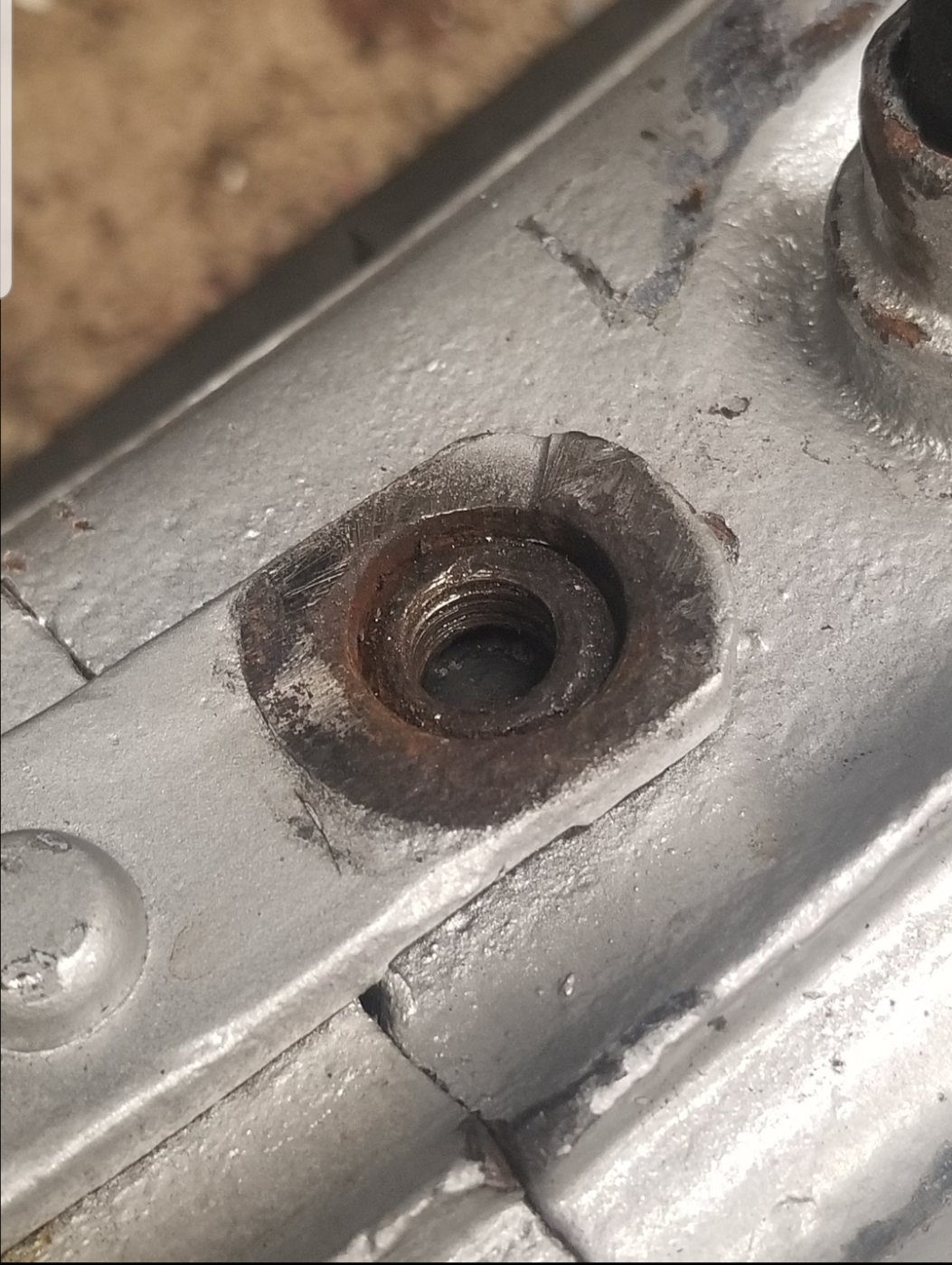

I did he same thing and the repair I came up with, worked so good, I did on all 5 rims when I changed the 53 years old tires for new ones. Using a tap the next size up (with tapping oil) and using stainless steel hex bolts, I tapped the rim and screwed in the new bolt, ground it down and, using a ball pein hammer, made it a rivet so it could not come out. Since the rims still went on the wheel with no problem, I did not grind down the head. Don’t screw it tight as the latch must be able to turn. I did not re-drill the hole a larger size before tapping. Instead, using a drift pin, I opened the hole up a little. This allowed more steel for the threads. Jim Patrick
PS. It looks as if your bolt is the latch that holds the rim closed. If that is the case, no need to use a ball pein hammer on the threads and tighten it tight. You should still cut off the protruding threads on the back side and round off and sharp areas that could damage your tube. Definitely use the thick flap to protect the tube.

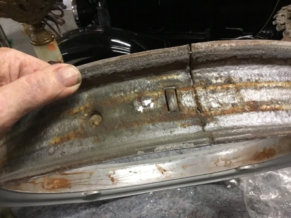

Jim, As you know, there were TWO types of latching mechanisms used on Ford 21" rims. One, like the one you showed, used a sliding lever to lock the rim, but that is not the type the author showed and has. His picture specifically showed the type that has a 'tab' that fits over a raised 'button' on the rim and is secured by a special round slotted head screw or bolt, and the repair for each is different. If you look at his picture at the top of the original post, you will see the 'tab' in its position when placed on the 'button' on the opposite end of the rim from the 'tab'. I had a 21" rim which had already been zinc plated and I thought was ready to use. When I went to insert the special screw, I found the threads in the "button' (like the author's) to be stripped. I must have posted about it on the Forum, because former Forum member, Model T engine builder, and Master Machinist, Henry "Hank" Lee, came to my rescue. Without me asking for help, Hank machined some new threaded "buttons" for me on his lathe and sent them to me. All I had to do was follow his instructions to remove the damaged "button" from my rim; drill out the hole where the original button was; and braze or weld in the new button. I am not a professional welder and because of my heart pacemaker, I can't electric weld, anyway, so a local member of my club (and a professional welder) offered to do it for me. I was worried about heat from brazing or welding on the newly zinc plated rim, but my friend knew exactly how to do it, and made the repair following Hank's instructions. The resulting repair didn't even damage the new zinc plating (it's a wonder what adding a "heat sink" to a object when making a repair, will do to dissipate heat). Anyway, I have one of Hank's 'buttons' left over and have offered it to Vincent (the poster) but I have not heard from him.

Yesterday, I had a very loose #12 screw and zapped the inside of the hole one time with a wire welder. Screw snugged up after that.

The rim closure in question has a raised flange which sits within the closing bridge piece. All the screw does is stop the bridge piece from letting the rim override that raised flange. There is no real load on it at all. It is more like a locator. Given this, a tack weld would keep the screw in location. A later fix with a helicoil would be a better fix when mounting a new tyre.

The thickness of the area needing a thread is only about 1/4", not a deep blind casting.
Not a good job for a helicoil. There is plenty of room to go to the next size fine thread.
