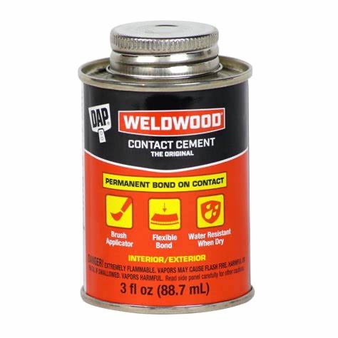

How about Weldwood contact adhesive on a rubber patch and tube scuffed up with 80 grit sandpaper. I’ll bet that would hold.
