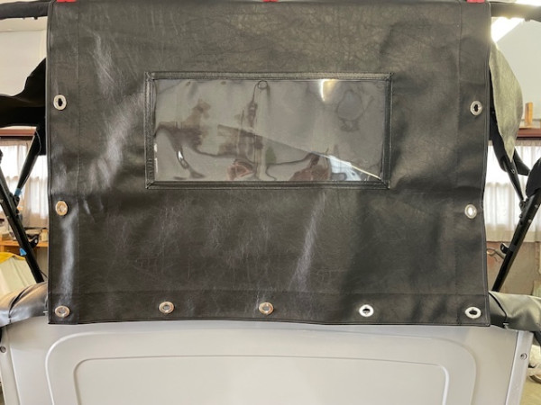

Did the roll up on the '27 touring, laid on the top cover and then test aligned the roll up piece to be sure the back stabilizing straps did not get in the way of the roll up. Make sure to space the straps, or they will be visible when the rear window is rolled up ;)

Placing the Common Sense fasteners over the Hidem Welt was easy to do, best to fully trim out then add the snaps. The side Common Sense were fitted at the same time to stretch the roll up and be sure all the snaps can close evenly without excess pulling to stretch the rear roll up.

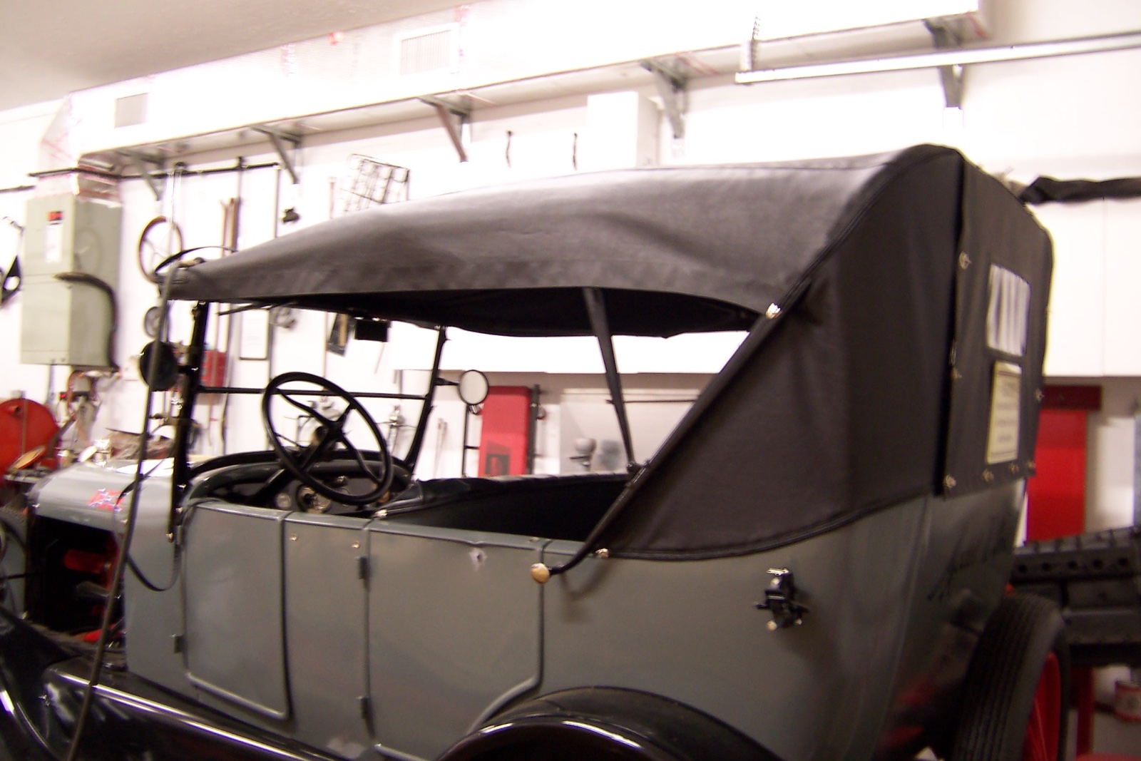

Measure space distance for rear straps first and tack in place prior to building the top.
