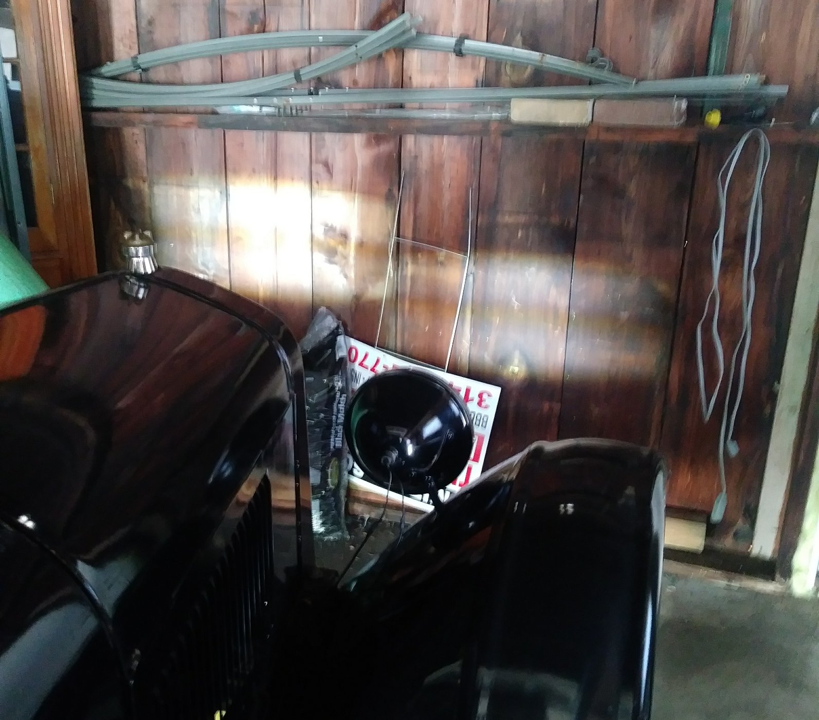

I found time this morning to install these headlamps in my ' 26 this morning.... Each sealed packet has the light bulb and a small allen wrench to adjust the position. Installed the passenger headlight bulb, turned on dim, and noticed the bright setting was lit. Removed the bulb, used the Allen wrench to loosen the two set screws, turned the bulb housing 180° and snugged up the set screws. Installed in bucket. Turned lights on dim, and noticed the light projected a slight slant to the left . Removed and readjusted for a horizontal projection. Did the same with the driver side light. I am very happy with what I bought, and verry appreciative to come across that video and share with you. I am not a paid sponsor of LOGOLITES, just a very satisfied past customer of other LEDs they sell . Hint- Hint .... They do have extra bright LED stop lights.
Dim ..... Sun shining towards car
Bright....  Sun shining towards car
Dim - bulb light only, no lens
Bright - bulb light only, no lens
