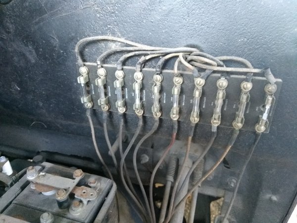

John. I installed mine right at the firewall terminal block. used a black in line fuse holder with 20 amp fuse. Might use a black fuse holder so it not too obvious. Many put their fuse holder at the starter switch in a weather proof boot like some of the vendors sell. I prefer to mount it on fire wall where it is easily to change fuse or disable electrical power when working on the car. Sure from a purely technical point of view fuse at the power source. But in this case the 30 inches ? of wire run straight to the fuse holder stands little chance of shorting out on anything. and it is much easier to check or change when out on the road in the boonies with out getting under the car or pulling the floor boards in the dark. Photo of period after market model T fuse block that fuses all of the model T electrical circuits including the magneto. A little over kill. Maybe not when You compare against Your daily driver with fifty fuses and three or more fuse boxes. Henry didn't put fuses on the model T because they were not needed but they cost a Nickle. He did put fuses on the model A to keep up with the competition such as Chevrolet and others which had put fuses on their cars for years.

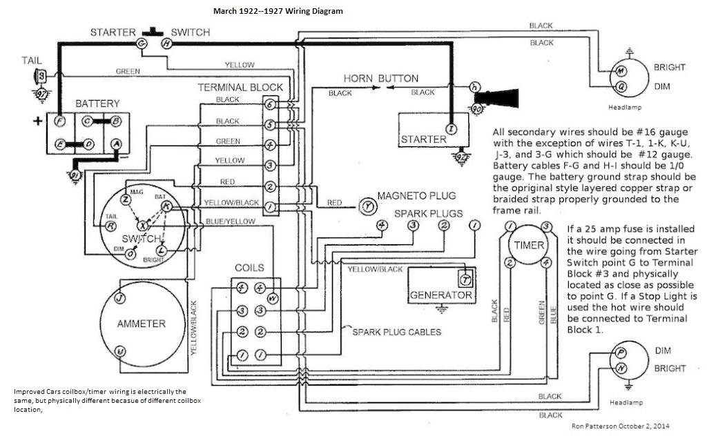

Ron Patterson
Re: In line fuse
Post by Ron Patterson » Sat Jun 15, 2024 8:12 am

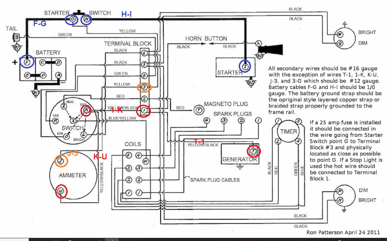

John
The Model T Ford FA charging and lighting system is a 20 amp system that should be fused with one 25 amp fuse.
That fuse should be installed as shown in the attached wiring diagram. This fuse will protect all the cirsuits form overload.
Ron Patterson
Moxie26

"Fuse should be installed as shown". ..... ????? I have my glasses on but I can't find the fuse. Please highlight that area.
Posts: 2067
First Name: Jeff
Last Name: Humble
Location: Charlevoix, Mi
Board Member Since: 2006
Re: In line fuse
Post by Humblej » Sat Jun 15, 2024 9:26 am
Read the note in the lower right side of the print.

Post by Moxie26 » Sat Jun 15, 2024 9:59 am
Jeff... I did read the notation, .... highlighting the diagram area would be more helpful to more.

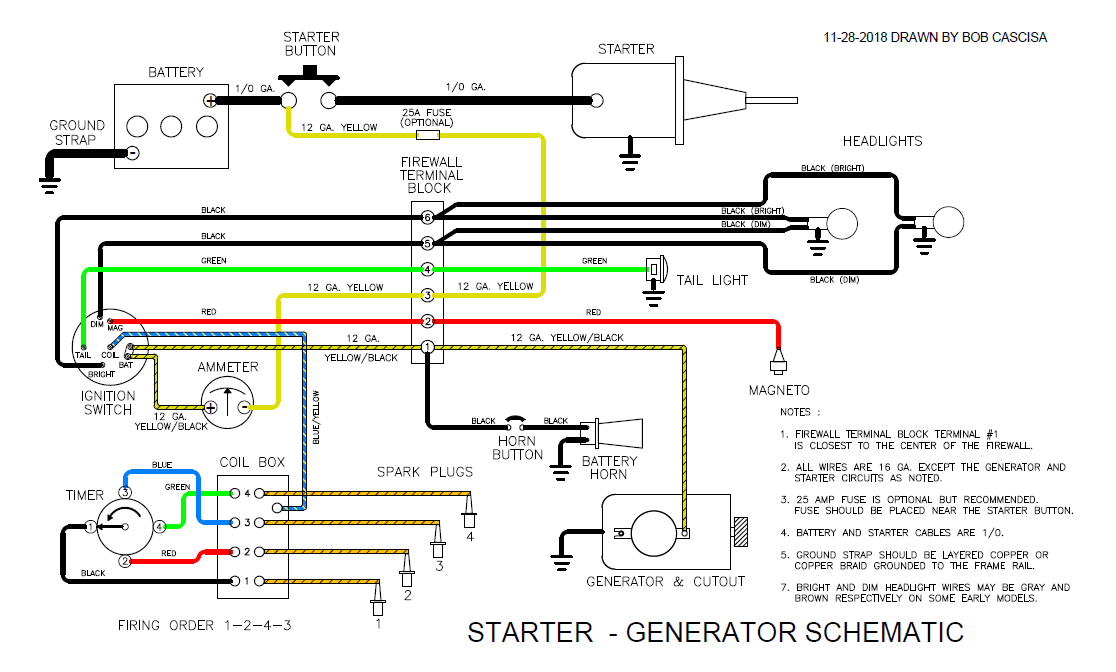

Did that awhile ago for a different discussion. Note UPPER case vs lower case letters
Same basic diagram with color coded wires

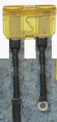

Fuse options
Circuit Breaker
conventional
Just hang it from the terminal strip
hang it.png (115.48 KiB) Viewed 3408 times
Posts: 2967
Last Name: Hjortnaes
Location: Men Falls, WI
Re: In line fuse
Post by DHort » Sat Jun 15, 2024 6:19 pm
I understand where to put the fuse, but why should it be as close to G as possible? Why not anywhere between G and 3?
Posts: 7253
Re: In line fuse
Post by Allan » Sat Jun 15, 2024 6:29 pm
The further into the wiring system the fuse is placed, there is a greater the chance of damage between the power source and the fuse. So, keep it at the starter switch, out of sight. It is not as accessible, but you have to find the reason the fuse blew in the first place, so adding replacing the floorboards to the task is no big deal.

Re: In line fuse
Post by jsaylor » Sat Jun 15, 2024 6:33 pm
"Why should it be as close to G as possible?" Closer to the Battery source the more protection.
Posts: 2067
First Name: Jeff
Last Name: Humble
Re: In line fuse
Post by Humblej » Sat Jun 15, 2024 6:44 pm
G is the battery source.
