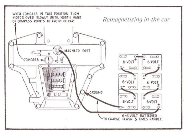

My magneto won't keep the engine running except at high RPM's, so running on magneto is no longer practical. Looks like I need to recharge the magnets. I suppose I'll get to that eventually, but not now as it requires three 12-volt batteries, the cables to connect them in series, etc. (I mean who the heck keeps three fully-charged 12-volt batteries?). Anyway, my car has a 12-volt electric system with an alternator, so my question would be the following: Is there any harm to running the car on battery and alternator instead of the magneto?

Have a qualified chapter member calibrate your coils. .... What is the AC voltage reading at speed?.... If you do decide to recharge the magneto, asking around to borrow 12-volt batteries, isn't that bad , just be sure to use battery cable connectors to hook up positive to negative between the three batteries..... I doubt you'll have access to six 6 volt batteries.

Look for the past thread from Tom Carnege on recharging. A DC arc welder does the best charge.

3 12vdc batteries in series is 36+ volts? I have heard people say 12 volts DC is more than enough to run coils on? How does the alternator
charge 36 volts??? How do you separate the 36 volts from your lights? Have you checked the endplay on the crank? Checked the mag gap?
John may be on to something if it takes 36 vdc to get spark?

Craig : ..... The 36 volts DC with series 12 volt battery hookup is in the magneto recharge procedure.

Find a friend with an electric golf cart. Connect across as many batteries as you need to get the voltage you want. 8 volt batteries will yield 8-16-24-32-40 or 48 volts and they are deep cycle to take the heavy load.

I'm gonna show my ignorance here, but if it is only volts needed and not amps, if any 12v batterys would work, riding lawn mowers, gas golf carts, etc might be a source. Or, if a friend has a Super Duty pick up truck or larger, they often have two batteries under the hood. Or come on over to my house and take your pick from my green machines.

How does the alternator charge 36 volts??? How do you separate the 36 volts from your lights?
The 36 volts are not connected to the lights, charging system, or any other part of the functioning car. They are used only a few seconds for flashing the mag coil to recharge the magnets. See the diagram posted above.

My thanks to those nice folks who replied to my question. In answer to some of the questions:
My magneto has always run the engine with less authority than the onboard 12-volt battery. As of late, it has become more noticeable and now the engine won't run on magneto except at high RPM. That tells me it isn't broken, but weak. I suspect the magnets need to be recharged.
No, I don't know how to test to see how far forward I can move the crank. I sure do hope this is not an internal wear problem.
Craig, my understanding is that the 36 volts of the three 12-volt batteries connected in series are used to momentarily "flash" the magnets in the magneto while the engine is still in the car. It is done by connecting the positive to the magneto post and momentarily touching the negative cable to the engine block. This "recharges" the magnets in the magneto. Normally, my single onboard 12-volt battery and its alternator run my lights and electric starter—and now, they run my ignition system instead of my dead magneto.

Okay, so let's say I get my car to a welding shop for the purpose of re-magnetizing my magneto magnets. They're not going to let me handle their equipment, so what instructions do I give these guys? How does one go about this operation?

Bob. I sent you a text the other day. I have a DC wire feed welder. Looking at the diagram we just hook up ground and spark the magneto post. Maybe others can confirm.

Jim, I believe it's better to hook up the post and flash the ground. Less chance of damaging the button.

Further to Steve's thoughts, I use a small pair of Vise-Grips to grip the nut on the top of the magneto post and connect the jumper cable to the pliers, so I don't accidentally arc on the tiny threads of the contact post. Then strike the ground to the hogshead.

First I’m not sure I’d use the mag post. I would take the mag post off, others that have used the mag post should comment. If you read the post I made prior to Jelf’s you see that I spoke to that point but as the young folks say you do you. Using a DC wire welder can be used IF YOU HAVE THE ABILITY TO REMOVE THE FEED GUN AND CONNECT ANOTHER CABLE TO the connector where the cable & gun connected. You’ll also need to remove the wire spool depending on how the wire welder works. You don’t want wire unspooling ha. Remember if the wire feed cable/gun is capable of being remove and another lead connected when turned on you are hot till the power is off.

Why can't you just flash it with one 12V battery?

John: For the MIG, how about disabling wire feed and making/installing a copper stud that fits the thread in the torch nozzle tip that the wire passes thru. (Remove brass bushing/install solid copper stud in torch tip.) The stud serves as the torch contact, ground clamp completes the circuit. Pulsing current is done with nozzle trigger. Has anyone tried this? jb

Interesting Idea James. Most of us have a MiG welder now days I wonder if the lower frequency of a MiG welder would make a difference?
Keep in mind that some less expensive MiG welders are AC to save the cost of the rectifier.

While everyone else is suggesting a full magnet recharge...I'd say try something else first, it may not help but it is fairly easy and relatively cheap so in my world, why not?
Pull the magneto post and clean it and see if it actually seats in the glob. Or, just try a different magneto post! Simple as it sounds...I have had experience where there was a really baffling inability to run on mag, I cleaned it - still baffling - Moxie 26 happened to be there that day and as usual, he can rebuild a T from his car trunk. Tried a different mag post...the thing ran like a champ...go figure, never figured out why the old post didn't (I think its point had wallowed in the glob...but only think.). Worth a check?

NO,NO,NO. Remove the mag post connector. Contact the mag lead button directly. (An old valve with some rubber hose for an insulator.) If you go thru the mag post you turn the spring into a heating element & at the very least lose the spring temper.Dan Haynes wrote: ↑Wed Jun 19, 2024 8:29 amFurther to Steve's thoughts, I use a small pair of Vise-Grips to grip the nut on the top of the magneto post and connect the jumper cable to the pliers, so I don't accidentally arc on the tiny threads of the contact post. Then strike the ground to the hogshead.
One 12V battery isnt enough. I have had marginal success with 3 12V batteries.
The Tom Carnege method is the most successful & quickest method I have seen & done. Magnet saturation is achieved in 1 strike if the field coil is good.

As an electrical expert I have to ask what position the flywheel needs to be parked at for this to work? Also please note that magnetizing happens when the current suddenly drops, i.e. stops flowing, as when you remove the connection. It should not be necessary to have current flow more than a second.

You can do the compass dance if you use the old method pictured. Unnecessary.waterloo wrote: ↑Fri Jun 21, 2024 10:05 pmAs an electrical expert I have to ask what position the flywheel needs to be parked at for this to work? Also please note that magnetizing happens when the current suddenly drops, i.e. stops flowing, as when you remove the connection. It should not be necessary to have current flow more than a second.
Read the Tom Carnege post.
Look @ the magnet keeper screw ends, they must be centered in relation to the mag post. Either method.
Easily seen with the inspection cover removed. That centers the magnets over the charging coils.
You are correct, one quick strike does the job. 2 or 4 doesn't improve the charge using a hi amp DC arc welder.
But we just cant resist. More is better?? Not here.
- Posts: 7330
Re: dead magneto
The in-car charge will work (I've done it with batteries), but recharging is best with the magnets off the flywheel, one at a time (I've done that too). I'd go with the in-car charge until there's some other reason to dig in deep.
- Posts: 472
- Last Name: Haynes
- Location: Lodi, CA
Re: dead magneto
If the coil spring is turning into a heating element, you are holding it way too long and you need to learn to flash the connection. If the spring is glowing red as John says, the solder between the individual coils (which melts at a far lower temperature than red-heat for steel) will be found in a puddle at the bottom of the crankcase and the cloth insulation wraps burned off the copper coils.speedytinc wrote: ↑Fri Jun 21, 2024 8:56 pmNO,NO,NO. Remove the mag post connector. Contact the mag lead button directly. (An old valve with some rubber hose for an insulator.) If you go thru the mag post you turn the spring into a heating element & at the very least lose the spring temper.Dan Haynes wrote: ↑Wed Jun 19, 2024 8:29 amFurther to Steve's thoughts, I use a small pair of Vise-Grips to grip the nut on the top of the magneto post and connect the jumper cable to the pliers, so I don't accidentally arc on the tiny threads of the contact post. Then strike the ground to the hogshead.
