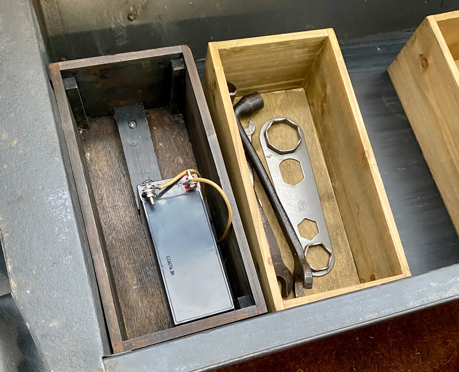

I use a sealed six-volt battery with an inline fuse and quick-connect that is used in Fisher-Price Power Wheels kiddie cars. My brother used to manage an FAO Schwartz toy store and he gave me a half a dozen of them many years ago. I'm down to the last one. I place it next to the gas tank, on the passenger side. I charge it with a small, six volt charger/transformer.
A friend of mine used sealed alarm system batteries in an early, cross-engine Franklin. They fit neatly in the stock battery box.

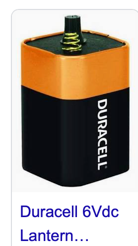

If you want to keep it simple and inexpensive, for $7:99 you can buy a 6 volt lantern battery with two wires and alligator clips. Once started, switch to mag. I have done this in the past and the battery lasted four to six months depending on use.
I forgot to add, I used an old 3 way toggle switch to separate the bat from the mag and could switch instantly between them.

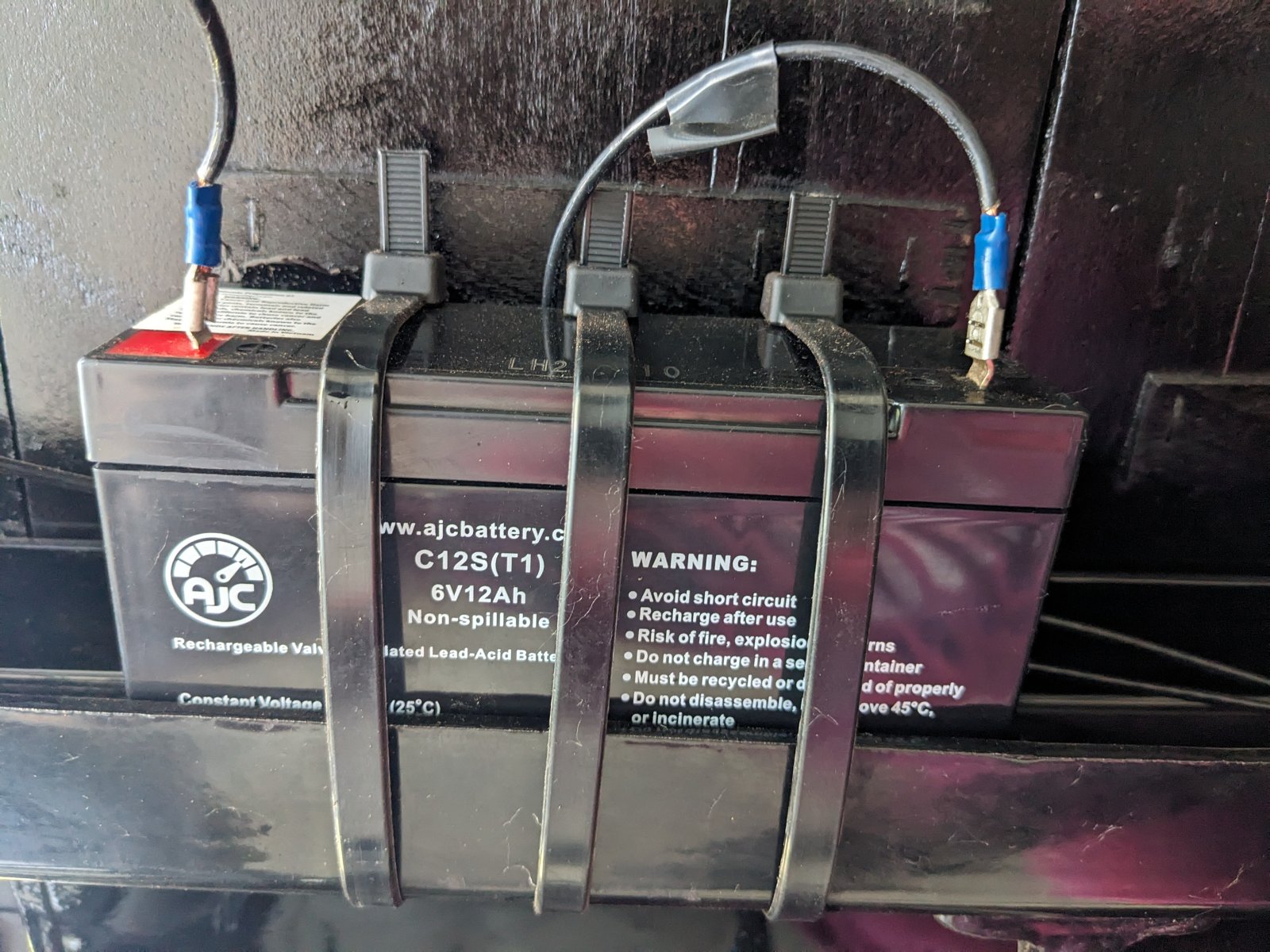

I use this 6V strapped to the frame on our 11 touring. Our 15 runabout has the same battery, although possibly a different part number because I got it several years ago. I got the idea of using a battery like this from Steve Jelf's website posting that he provided the link for.
It works well, and I only occasionally recharge it; mostly because I almost always start the cars on the magneto. However, it starts well on battery mode with this battery.

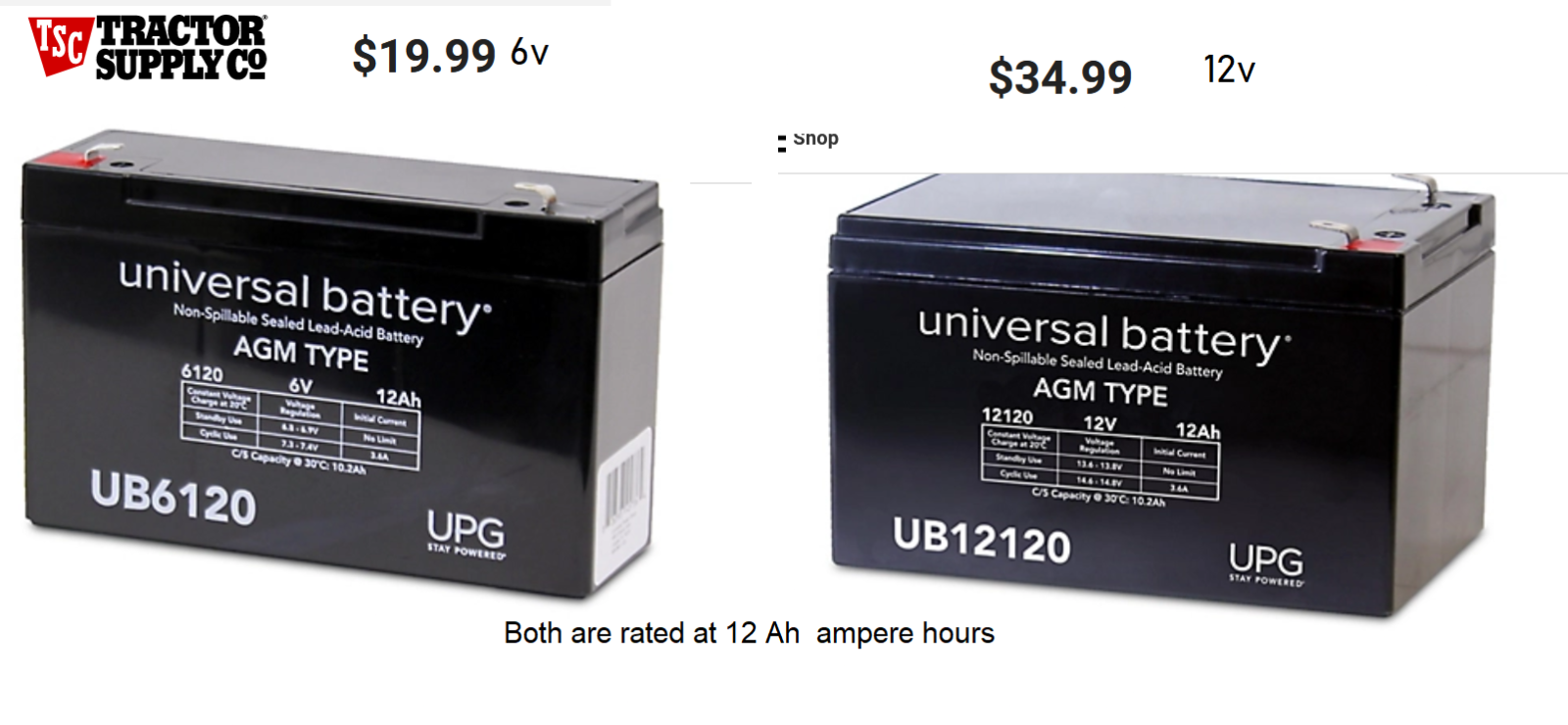

- Posts: 6581
Re: Batteries for brass era cars - what do you use?
Putting things in perspective.
You don't need a big expensive battery to fire up the coils or even run on the for a period of time.
While there is evidence that 12 volts fire coils a fraction of a second sooner than 6 volts there is also a caution to be aware of - best to read this link and decide for yourself. https://www.mtfca.com/discus/messages/1 ... 1271261371

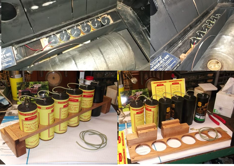

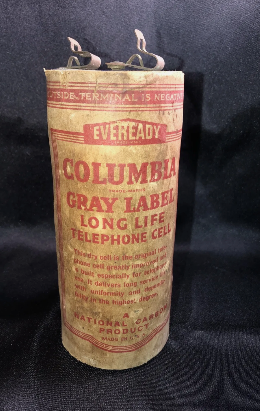

Back then dry cell batteries were used. So if you want to look period correct
https://www.mtfca.com/discus/messages/4 ... 1391269200
Robert Skingley on Monday, February 10, 2014 - 09:45 am:
Here are pictures of what I came up with for a vintage battery for my 1913 Runabout. This is based on what I read about the earlier Ford's , Model N , etc. The wiring diagram I found for the Model N shows two battery's in rows of six. It was not until Henry designed the Model T that we get the flywheel magneto. From the booklet or operator's manual that was written in the fall of 1913, it only mentions that a provision is made for a battery. That provision being , a switch on the coil box. I have a Beaudette body and behind the gas tank is a long narrow compartment that I use for a battery and other stuff. This seemed perfect for the six battery cells and I decided to build a rack to hold them. The rack is not necessary as a board placed behind them would have done the job. I personally believe that when the Model T's first made it out to the Agencies, they installed a battery. No free starts with out a battery. The 1 1/2 volt battery's I used have the look and voltage of the old dry cells but are constructed much different. The originals would have been metal cased with a carbon anode in an electrolyte. These are simply a plastic casing with up to date battery's housed inside. When the battery's have used up there life, I will leave them for display

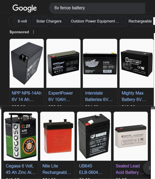

Besides garden/mower batteries there are also 6 volt fence batteries to consider

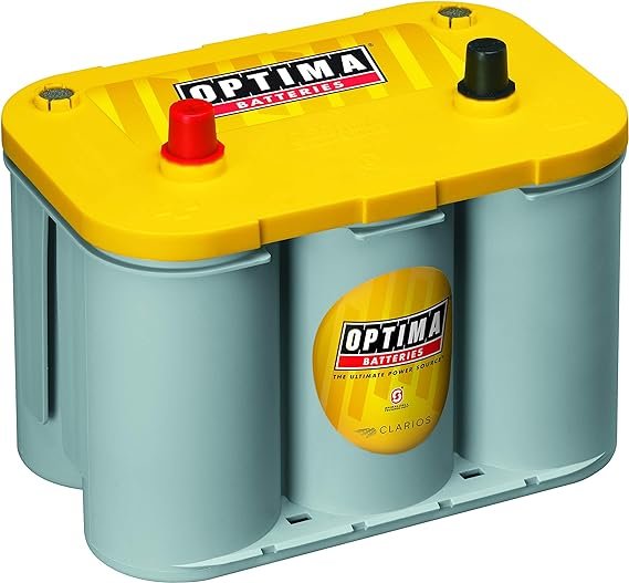

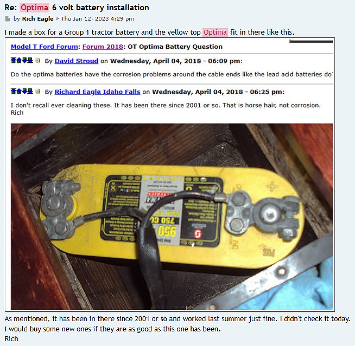

This optima has been working fine in my Speedster since 2001. It has outlasted more than a dozen batteries since then. It was free but I haven't bought another one. My mistake.
I use motorcycle batteries in the non-starter cars. They last a year to 4 or 5 depending on the size, for starting. Keep them charged.

6v wire fence battery.
I figure if it's strong enough to zap a cow, should kick the T !

- Posts: 6581
This 6v is a similar battery as above, and often sold as a trolling battery. They are AGM batteries so they can be mounted on their side or upright & designed for recharging. 12Ah, ampere hours which is much more than many others.
6v size 5.94 in x 2.01 in x 3.94 in Weight: 4.06 Lbs
12v size 5.94 in x 3.86 in x 3.98 in Weight: 8.38 Lbs

I have a 1915 Touring, which, of course, was not manufactured with an electrical system. Because I wanted to install an electric self-starter, turn-signals and reliable lights for night driving, I had a full 12-volt electrical system installed. This consisted of a belt-driven alternator and an Optima battery under the rear floorboards in a later-vintage Model T battery bracket.
Optima batteries cost more than they're worth, but I used them anyway. For my purposes, the deep-cycle, yellow-top version works best.
The alternator does a fair job of keeping the battery alive, but I frequently find myself hooking up an Optima charger at home.
