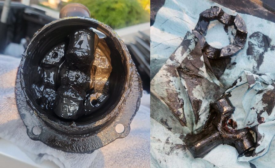

- Posts: 4390
Re: Very odd sound coming from transmission
Universal Joint.
Jerry, the U-joint is pretty high on my list of suspected causes also!
I agree to check the u joint. I blew a u-joint a couple of years ago while on a tour. It was always quiet and never a problem. I greased it often. That day it was quiet as usual. I came to a stop sign and stopped as usual but when I pressed the low gear pedal, it didn't move and made loud grinding noise. When we took it apart the u-joint was in about 8 pieces.
The grease cup on the u joint in this car (it's the larger one) has a zerk fitting in it but I never really knew how much to grease it, but I always seemed to put plenty in it. A couple weeks after this happened, I asked Dean Yoder, the drivingist T guy there is at this time, and he said "keeping pumping grease in until it comes out around the ball joint. Of course, one should also fill the u joint cavity by hand completely full of grease before installation in the car. Dean's comments are words to the wise. Thank you Dean!
Keith
Keith
- Posts: 2317
- Last Name: Juhl
- Location: Thumb of Michigan
I agree with Jerry Van - Check the U-joint. We just dealt with that issue in a friend's car.
